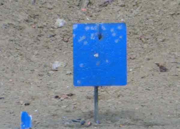

    My pine cone bore sight with a newly mounted barrel, Scope, and 20MOA rail was pretty close @ 100yd (Clean Cold Bore Shot)
    That's the first 5 through the barrel.

    Discovered I had cross threaded the rear rail screws and in doing so they clicked the torque driver but not because they were all the way down. I removed all screws and ran a tap thru the two cross threaded holes, grabbed new screws and remounted the rail.
    Hopefully it holds zero.
    Reactions: spife7980
    I only say use a poster board or something around 36" square just in case the scope is not at its mechanical center and or a very poor shooter.....LOL
    That's why you mechanically center the scope before zeroing. Center the scope, compensate for the cant of your rail if it has one, take a shot. You'll be on paper at 100. Typical NRA target they have at most ranges is 14" x 14". If your zero is 7 MOA (4 MIL) off in any direction when you try to zero, you got some problems in the system somewhere, no?
