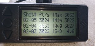

Lots of things matter in getting good SDs. First off, others have mentioned it, but I'll reiterate it: doing any sort of measurement in the first 100 rounds down the barrel or with virgin brass is an exercise in futility.
Here are some screen shots from my Garmin app while doing load development on my 300 PRC last weekend.
Now, these are only 5-shot groups, so one might say that the sample size is too small. I don't expect to get 2.7 or 3.1 fps SDs going forward, but I do expect them to be low - my expectation is to get consistently in the 6-7 fps range. As to the sample size, notice that the SDs remain low across all 3 groups (15 shots). I'll be validating a load against 50 shots on Wednesday.

All that said, here is the data from my 6 BRA last weekend:
Depending on your point of view, you might think this is either good or bad. I happen to think it's pretty bad. So, after all I mentioned above, why did I get such bad (in my opinion) SDs????
Well, these 25 shots were rounds 6-30 down my new barrel. I was also fire forming from virgin 6 BR to 6 BRA, and I didn't mandrel or use neck lube (because for some reason Lapua 6 BR doesn't absolutely require a mandrel to load forming round like other of their cases do, and no need for neck lube if I'm just forming and speeding up the barrel anyway). When everything is said and done, I will expect 4-5 fps SDs from this rifle.
