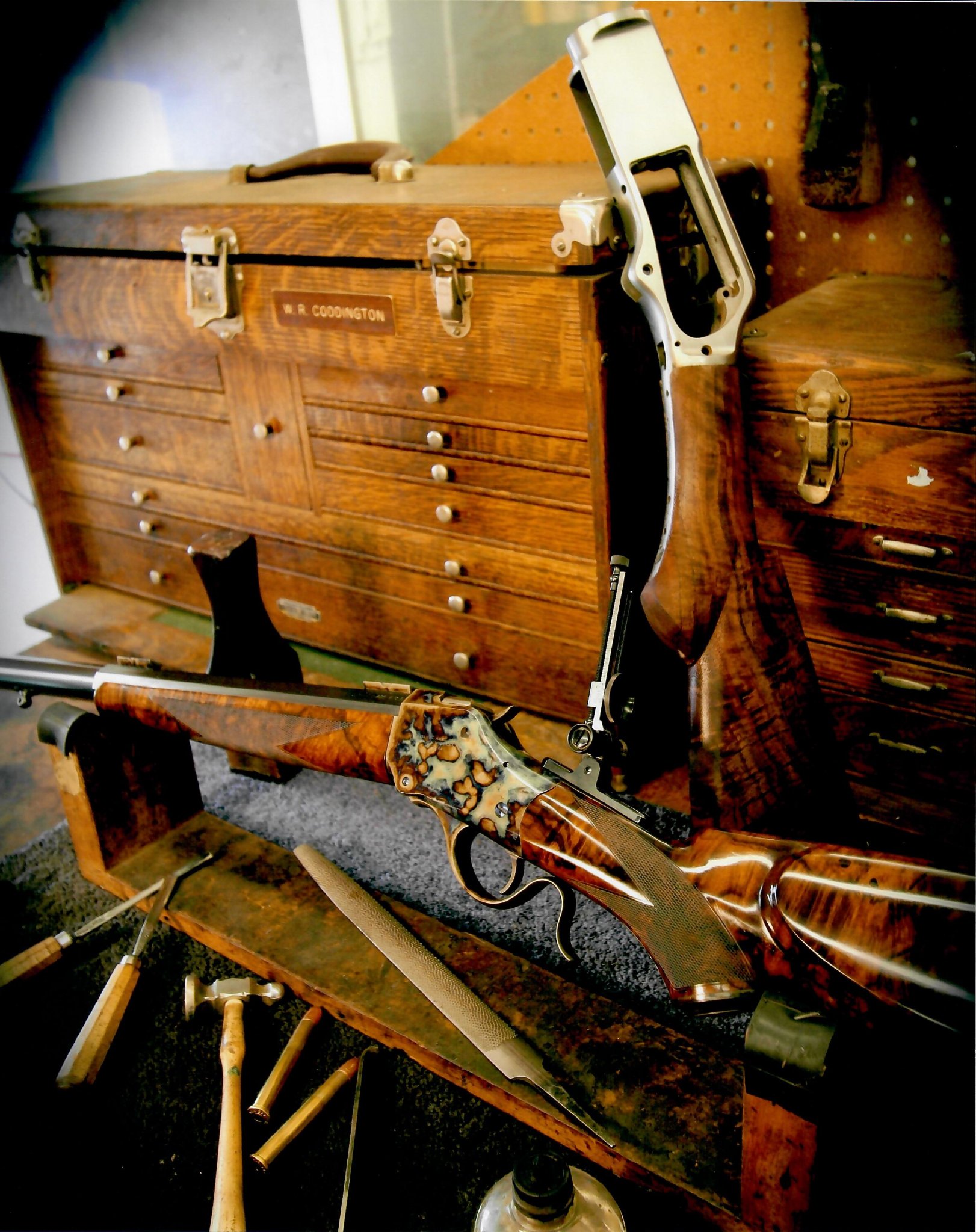

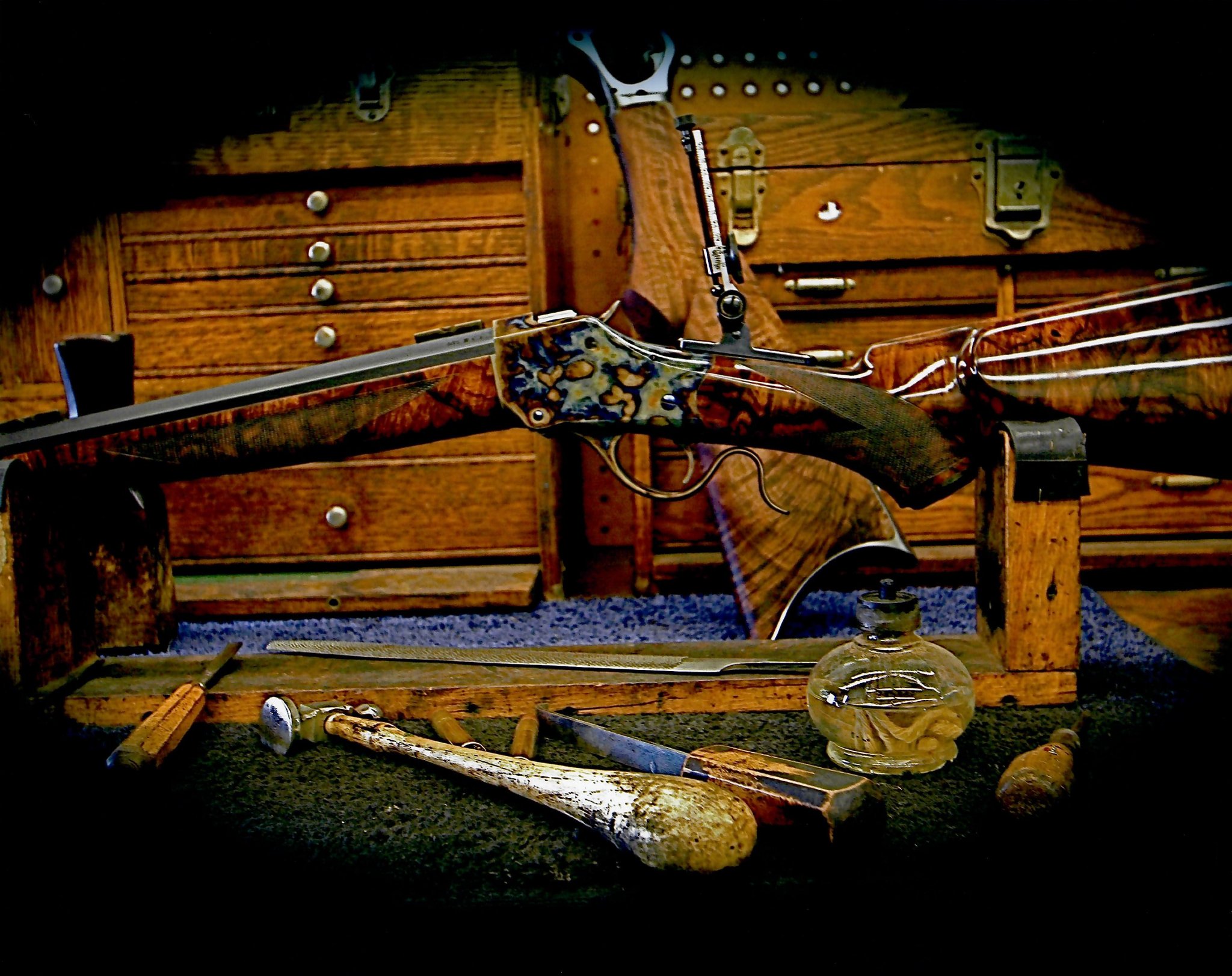

Nice. I dug up photos of the one I had built in 405WCF. The work was done by Allan Mack of Mack Brothers.

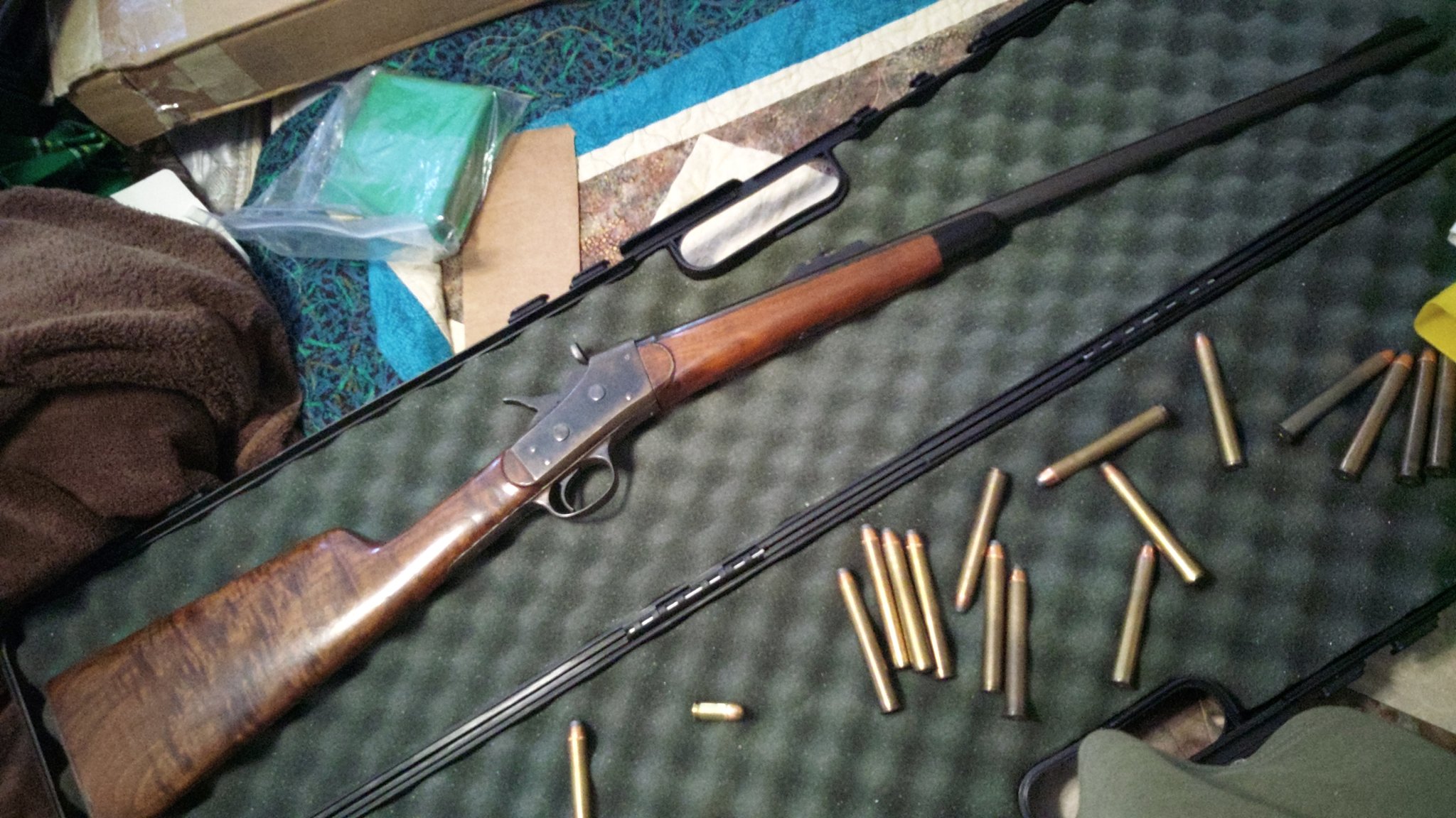

I abandoned this project idea a long time ago in favor of going in a different direction. Recently I've leaned towards a Remington Rolling-Block and I actually found one that seems to have been redone for .450 Black Powder Express, which is basically a British .45-120 Sharps. More or less. I'm tempted to spend part of my next paycheck on it...

Haha perhaps so! Think I'll actually see if the seller would be open to a trade for the Pedersoli trapdoor I have. If not a full swap, might at least lighten the load on my wallet a bit. The roller even comes with several rounds of smokeless-for-black ammo and reloading dies, so that's even more of a plus.
Then I'd just need to find out if the .450BPE is still legal for certain game in Zimbabwe, just in case I ever manage to get on that safari...
