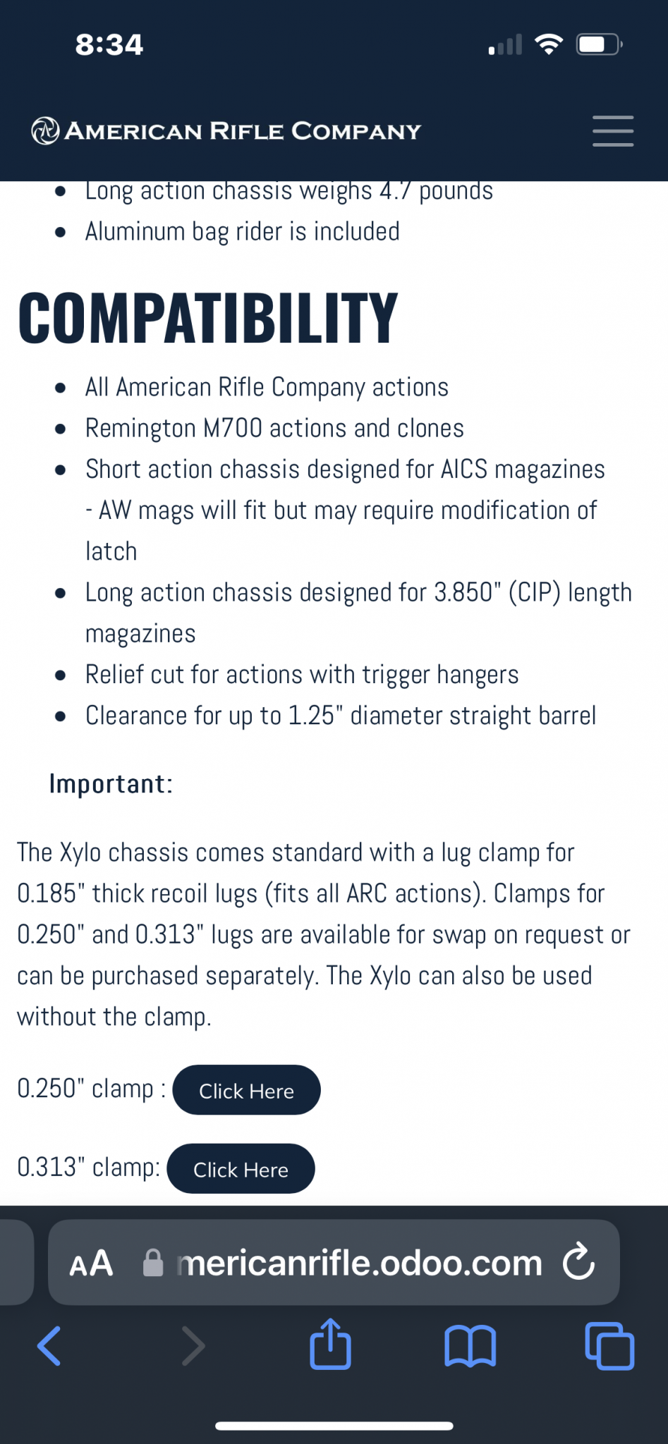

    Yes, call ARC. I believe the mag catches that are shipped now are for AW mags. If that's the problem, they will have one for AICS mags that you can switch out very easily.

    Ok thanks for the replies. I will keep these since they work in my other rigs. Try to get the AW mags. I know the CDG is designed for the AW, but any issues with the Nucleus in a Xylo?

    There are multiple latch dimensions available. The standard one depending on action doesn't work well with arc mags. I installed a longer catch and arc mags have been great ever since. I run arc mags in creedmoor, gt, and bra, no issues. In any my ai atx, xlr, xylo, foundation/otm stocks, I've just never really had a problem. Been using them with bighorn, arc, bat and lone peak actions.
