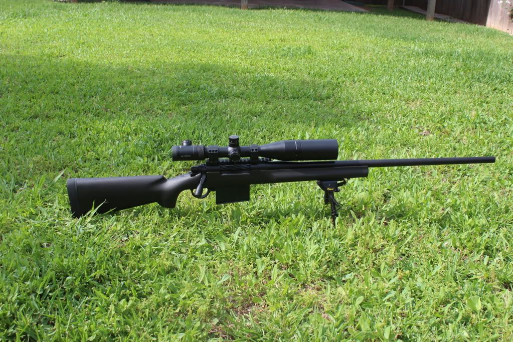

Rem. 700 action trued
Contoured the barrel myself (Pretty much a Sendero contour)
Seekins DBM
Seekins Rings and bases
Timney Trigger
HS Precision Stock hydro dipped in Carbon Fiber
Vortex Viper PST FFP 4-16x50mm
I did all the barrel work in 2007 while attending Pennsylvania Gunsmith School.I shot it a little with a Laminated wood stock that I built but pretty much have been changing everything over to what you see in the pictures.

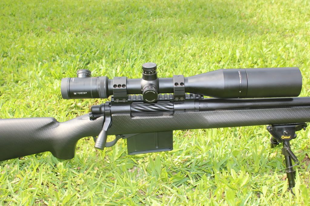

Yeah I saw some rings like mine saturday and they were oppisite of mine but when I asked they didnt really have an answer.What is the reason for the 6 bolt on the front?
Re: My 300 WIN MAG is Finished Finally
<div class="ubbcode-block"><div class="ubbcode-header">Originally Posted By: Andy Y.</div><div class="ubbcode-body">Yeah I saw some rings like mine saturday and they were oppisite of mine but when I asked they didnt really have an answer.What is the reason for the 6 bolt on the front? </div></div>
That's how the USMC rings were made for their M40A3' and 5's.
Its just a traditional way. More ring on the scope, for less movement under recoil. Guess it doesnt matter its just what most people are used to seeing.
