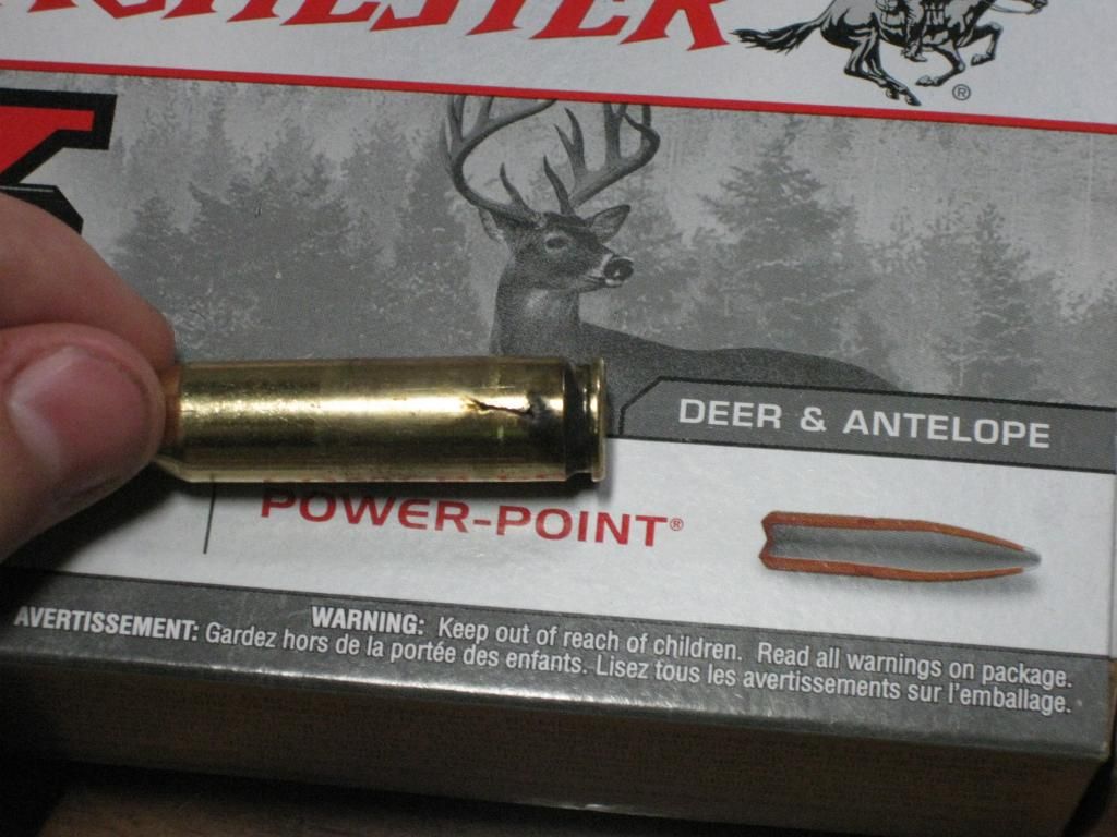

Hello all,
I was out at the range about an hour ago zeroing in my .243 with its new scope. I had a couple of rounds downrange and everything was going well and it was time to get that last little adjustment. Then I took a shot and I couldn't see through my scope and noticed something came back toward my face. At first I thought something happened to my rifle until I took my face off the stock and noticed smoke bellowing out of my receiver and some out the back of the bolt shroud even! I ejected the spent case and noticed it split real low. I've never had this happen, is this a possible overcharge of powder? Should I worry about anything in my rifle? It seems okay but like I've said this is new to me. One thing I can say is Thank god for eye pro!
