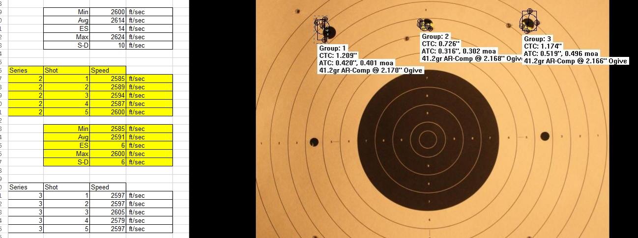

    I normally work up charges first then play with COL. Here's an example of load testing I did on my AR 308 shooting 168gr A-Max and AR-Comp. I found an accuracy node at 41.2gr and started working on seating depth. At 2.168" measured to the Ogive I got my best grouping and best SD/ES numbers.
    First round on each was off to the left so I adjusted the scope and shot the remaining 4-shots for grouping.
    What powder were you using for this? If varget 41.2 grains seems pretty low

    RIF: AR-Comp.
    42.8gr was getting light ejector marks so I backed down to the next accuracy node of 41.2gr. I could probably determine the best load without even looking at the groups just by the ES/SD numbers. Hence a chrono is very important when load developing.
