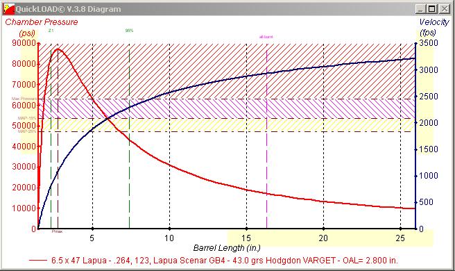

43grains of Varget in a 6.5x47 -- you sure? Seems WAY overpressure. QuickLoad predicts that is 87k psi at 2.80" OAL, 110% capacity. I attached the QL pressure/MV curve for those interested. To anyone that wants to go that high: USE CAUTION.
The top end w/ Varget that I have seen is 39.0-ish (+/- 0.5gr), which is close to 60k psi in QL. You can run the brass harder, for sure, but life of brass and barrel will suffer.
