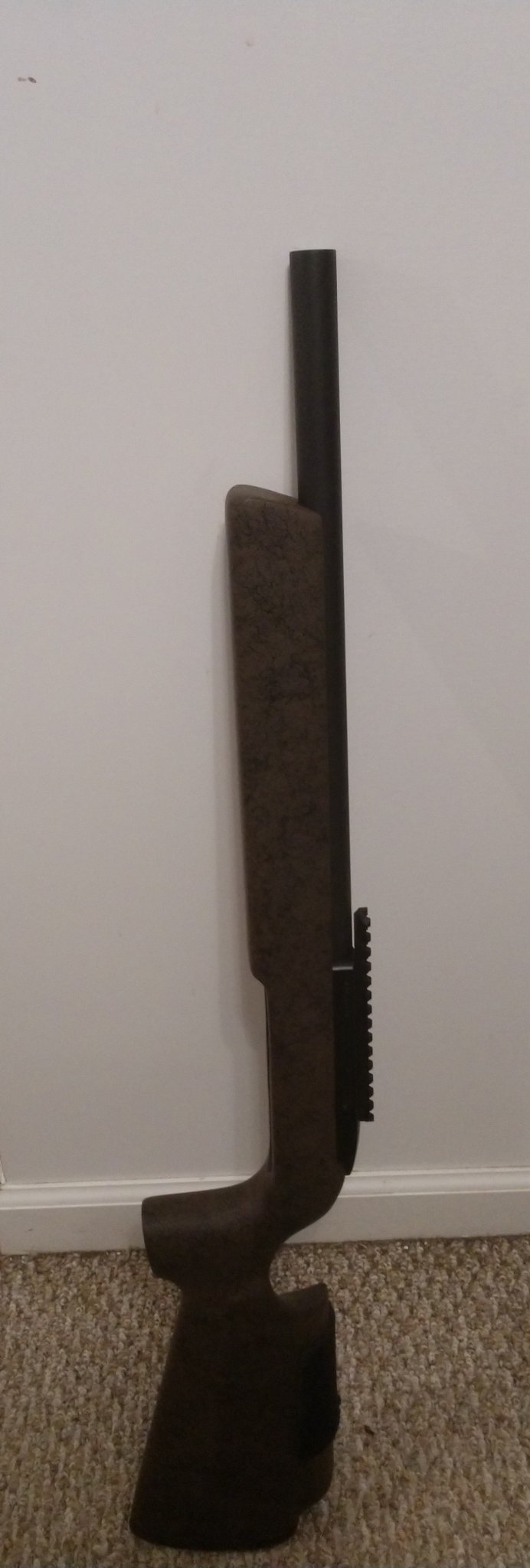

Bell and Carlson anshultz OD green
Kidd parts
1 stage,,kit with reduced spring s,,
charging handle,,guiderod,,springs
bolt release,,extend mag release
20minute Kidd scope base
Federson 16 barrel,pillar bedding.
Got a extended take down screw,,
oem just a tad too short
CPC bolt work radius,,pinned Kidd firing pin
For now maybe my spare red dot
Then as usally shoot this offhand
still undecided on scope.
Picture from before everything is finised
Just sent bolt to CPC

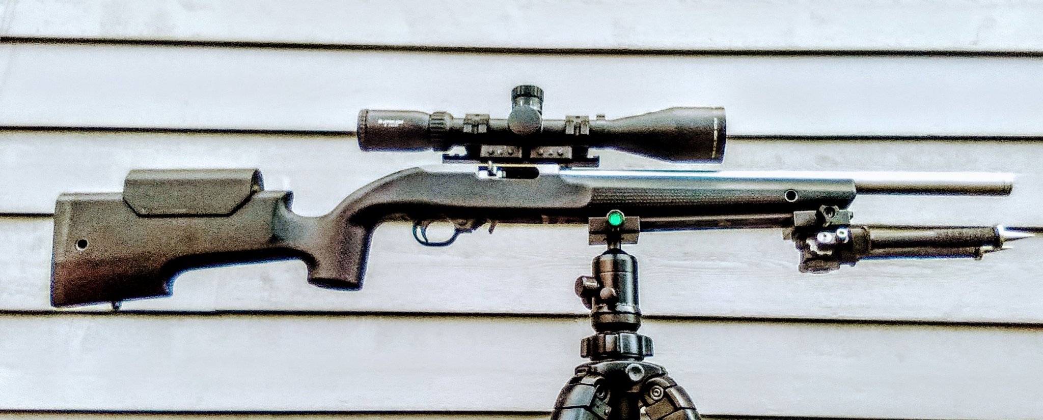

Summit Precision Carbon wrapped threaded barrel
Kidd receiver (anchored) with 20moa rail
Power Custom trigger
PMACA long chassis
Vortex Tactical 4-16x44 FFP
Burris PEPR mount
MFT Utility Battlelink stock painted black
Crappy Atlas knockoff bipod painted black
