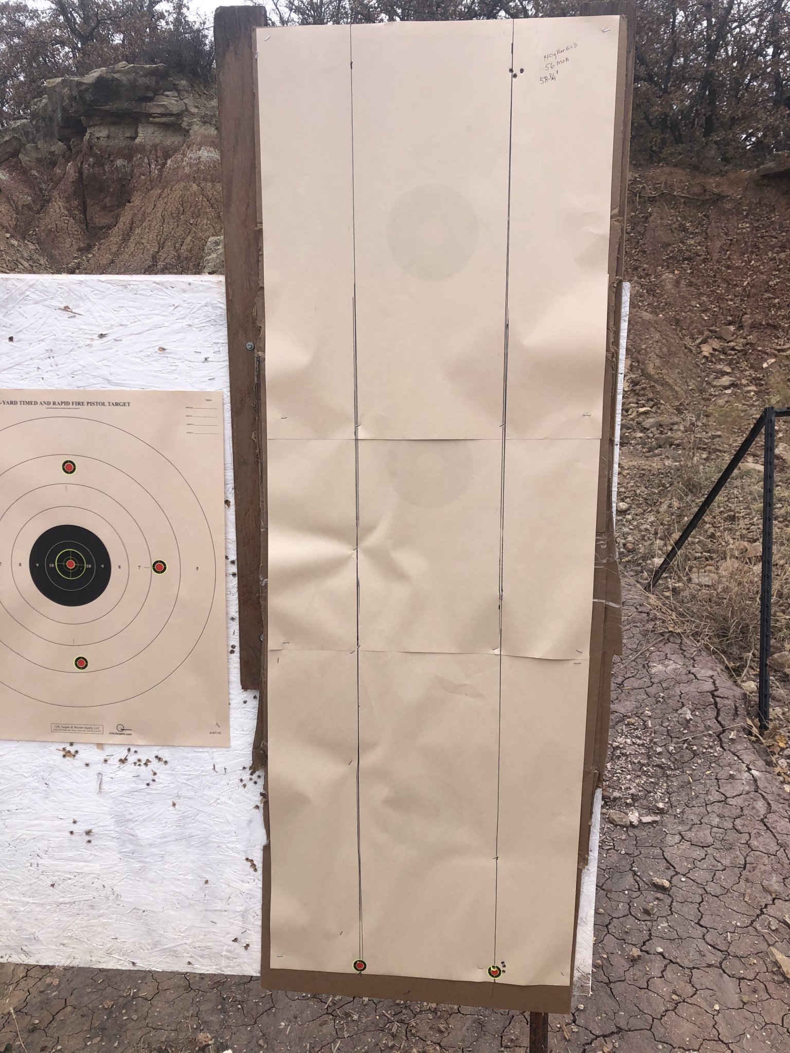

I’ll be as brief as possible. I can shoot to 1050yds on my farm. My son and I went to Triple C range Wednesday to shoot farther. My son’s 6.5CM with Zeiss v6 5-30 maxed out at 1200 due to lack of travel. He shoots prone/Harris bipod. I shoot off bench/bags. I gave him my Tikka/PVA 7.5 twist in MPA chassis with ATACR 5-25 to shoot farther.
I don’t hand load. I’m in my late 60’s and have enough hobbies. I shoot 140 and 147 ELD Match. Use a Kestral 5700elite. Range distances were true by Leica 2800. All inputs were correct. Environmentals were good as my 6CM hits were pretty close to expected.

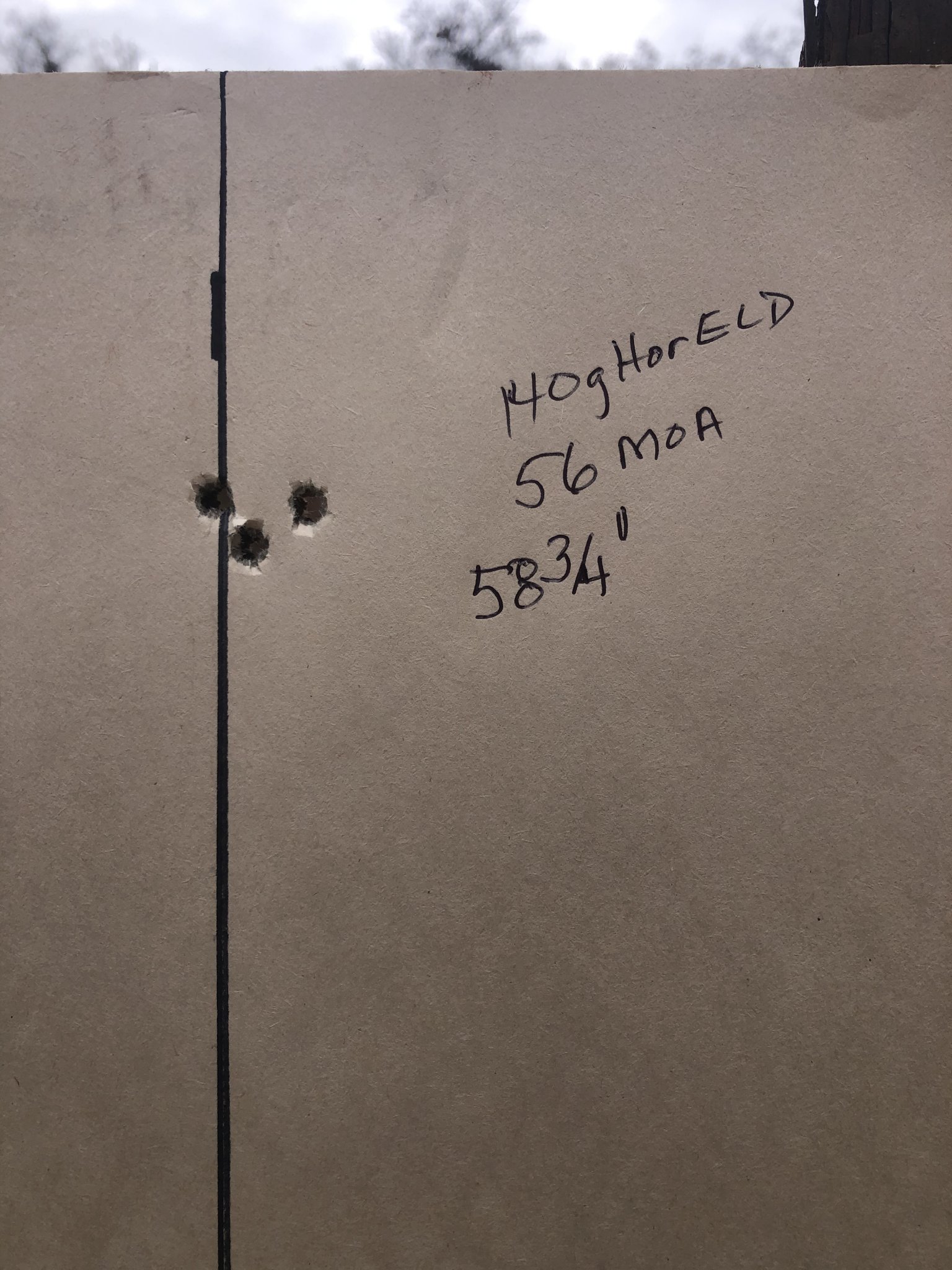

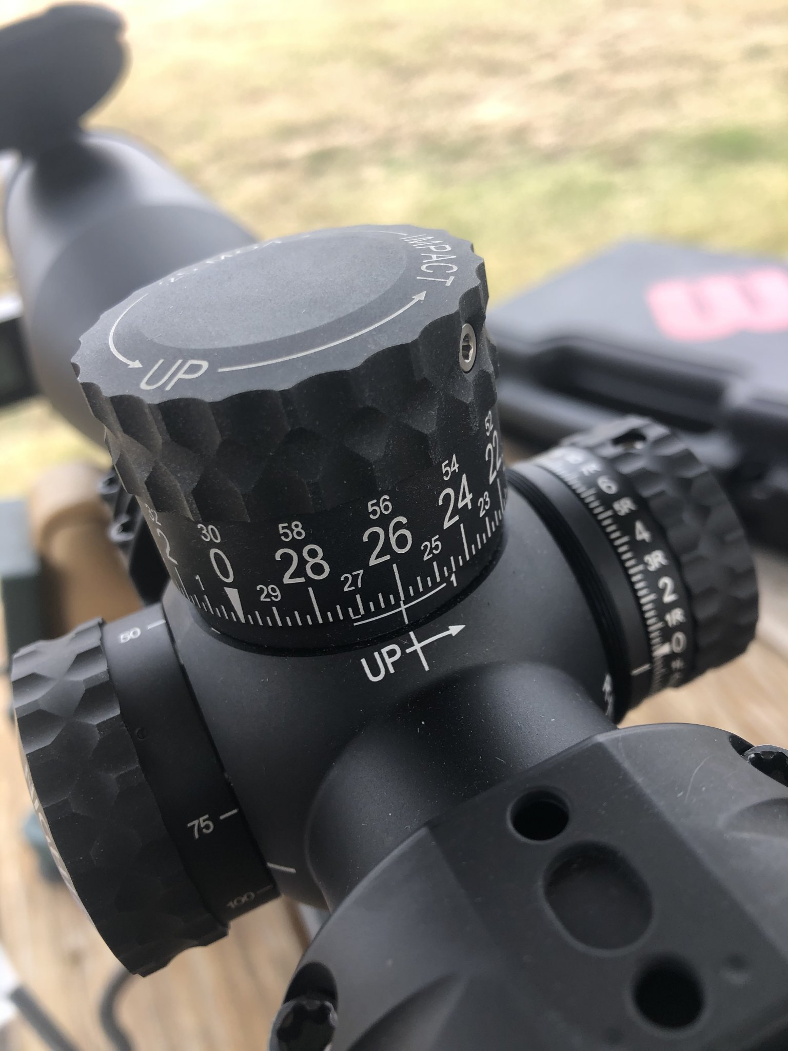

I was concerned about the scope not tracking or scope induced cant
I ran a taller tall scope test today and it seems ok.
100yds(tape measure) x .01047 x 56
moa. = 58.63
Actual = 58.75
My question is :
Is it possible to get the above results with those significant differences in expected vs true due to shooting off a bipod when rifle was zeroed off bags??

Do both scopes have the same movement per click?
