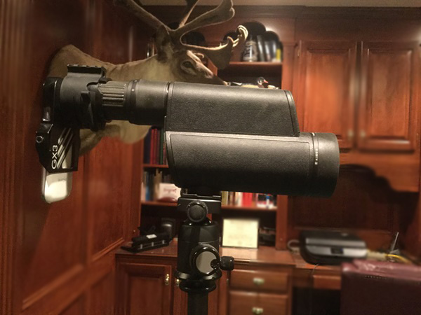

Phoneskope on my tripod, though I am now teaching my 7 year old to describe what the bullet is doing for me. He has a lot of fun 😬
