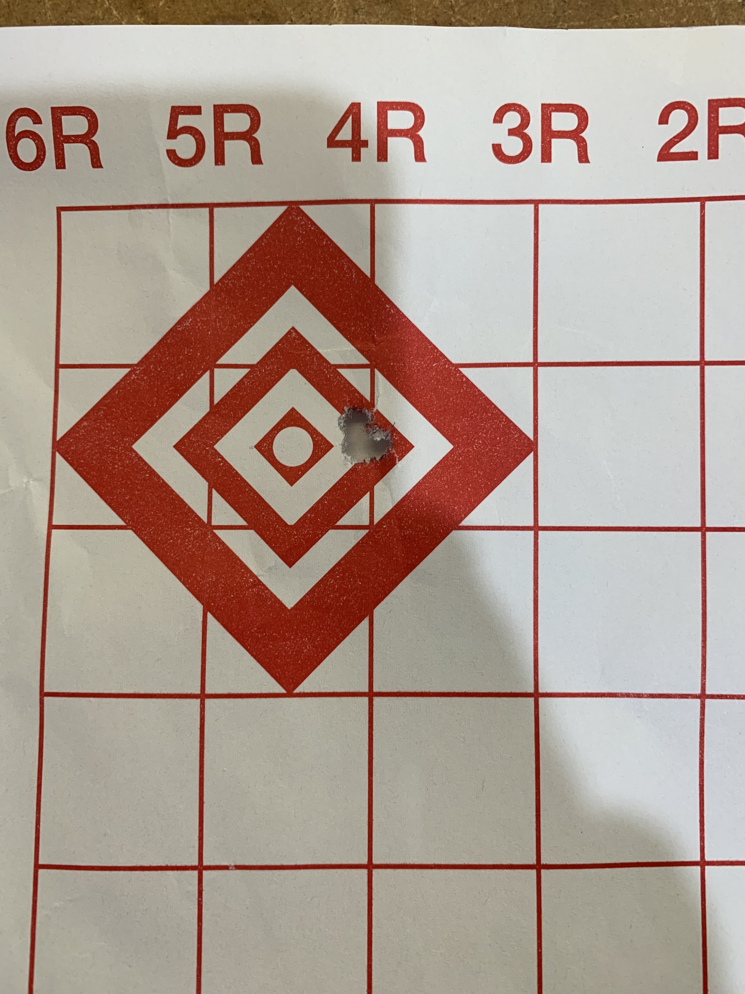

This is the first 5 after cleaning my barrel after my last match. Between the 2 barrels I’ve shot just over 1500 of the 109 ELDM’s.
Impact action
6GT
Proof steel comp @ 26”
.120 FB
Alpha brass
CCI 450
Reloader 15.5
2852fps
5 at 501yds verifying velocity

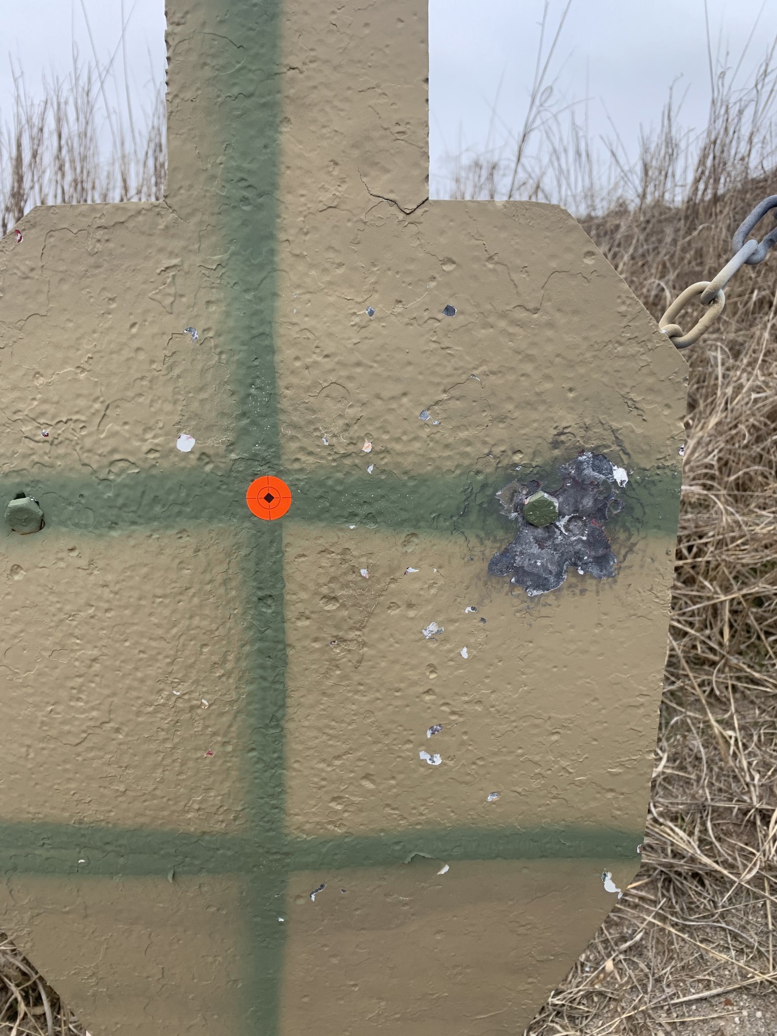

Had a one day match yesterday, 9 stages 86 rounds. First time shooting the 109 ELDM’s at distances past 1000yds. Had hits out to 1307 with them in my 6GT with the wind being a factor and not the bullets. So far my load with the 109’s seems spot on. I don’t see anyone having problems with them, this makes 5 matches I’ve shot them in so far.
