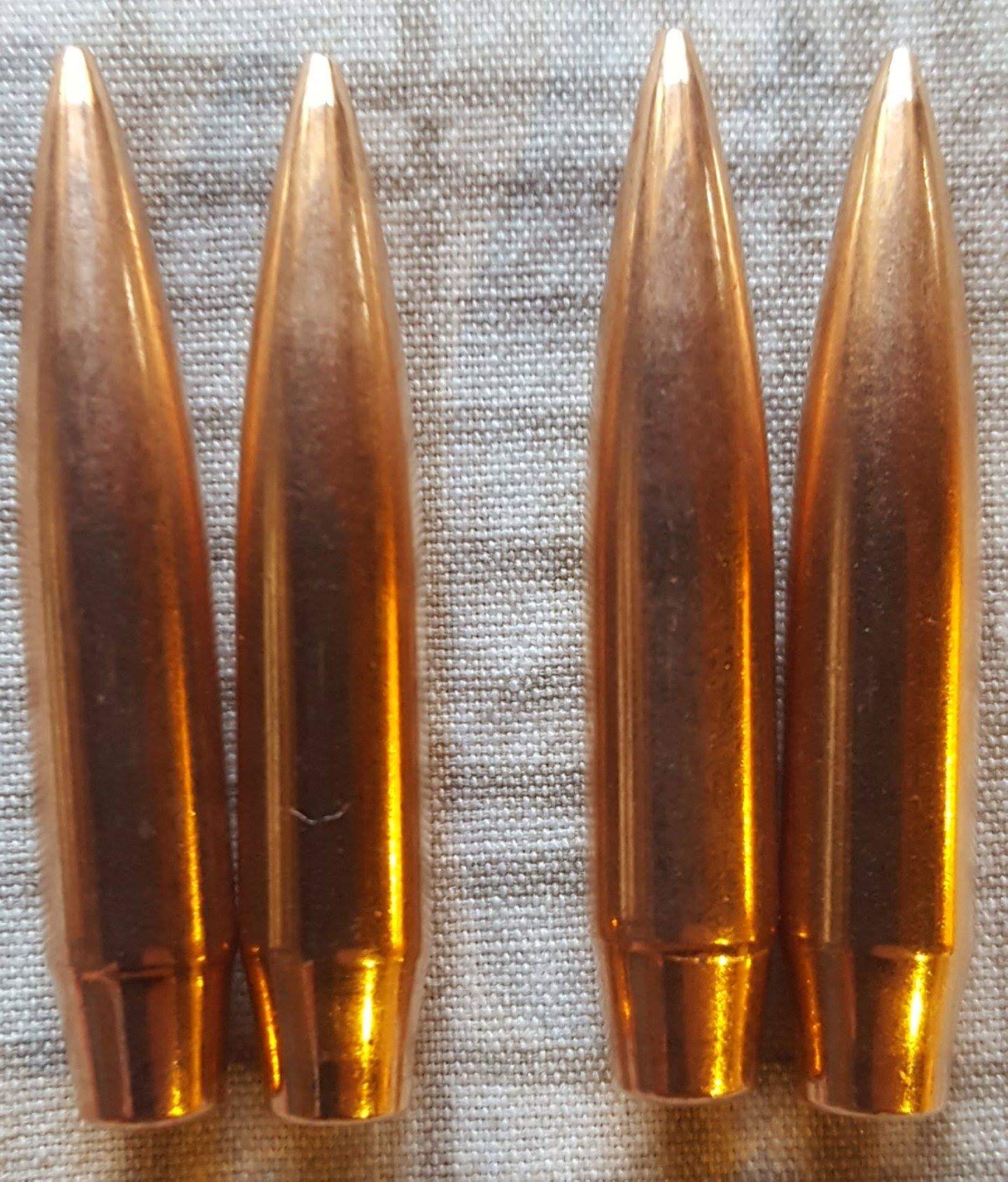

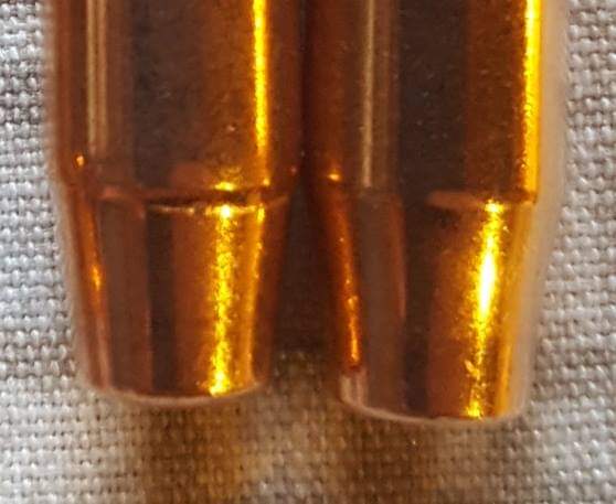

op,
can you measure the boat tail length?
on my current lot, i’m getting 0.210”
looks like the one on the right.

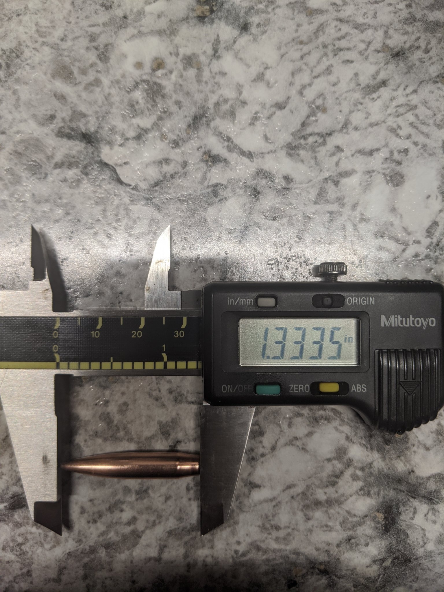

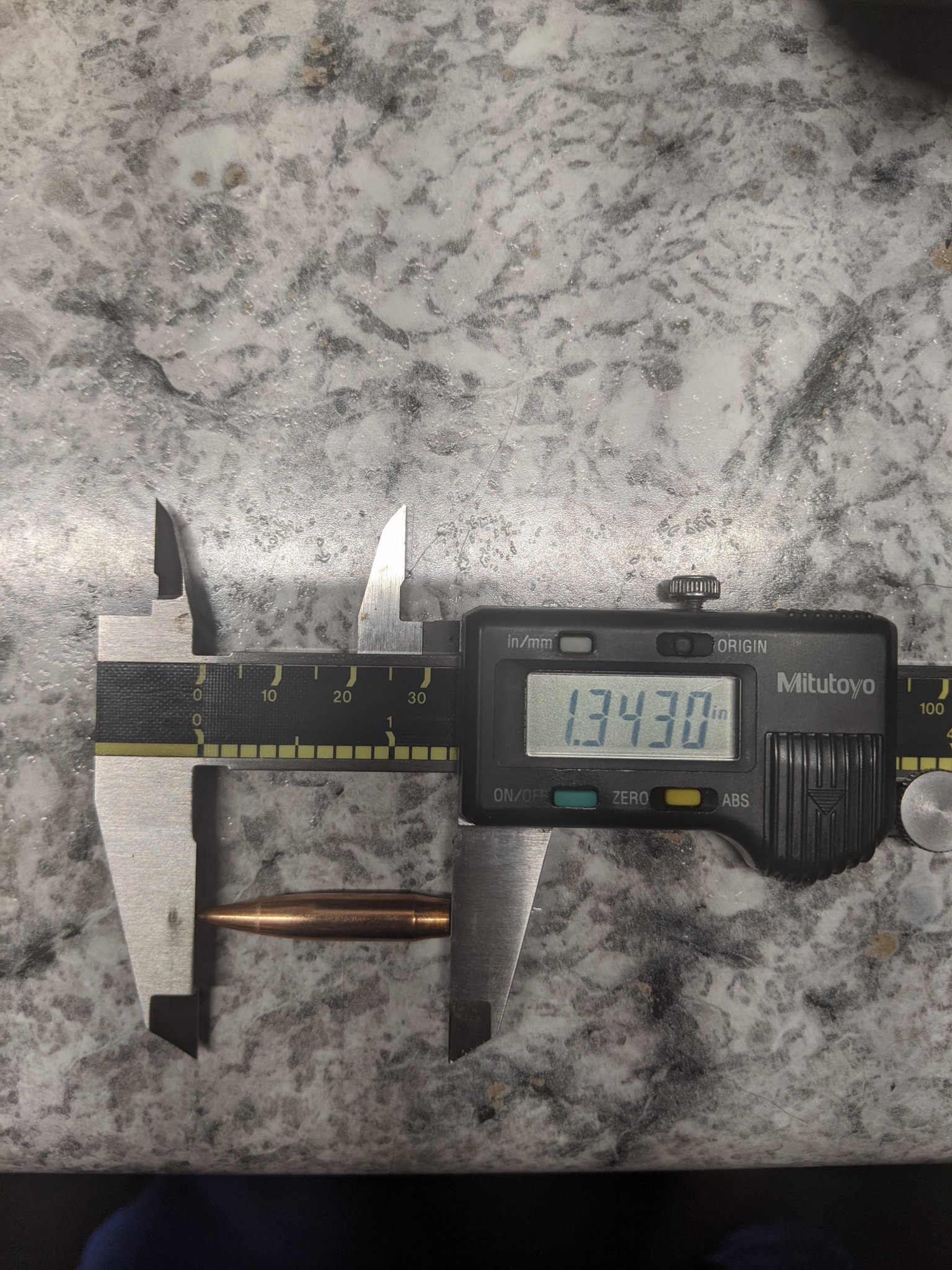

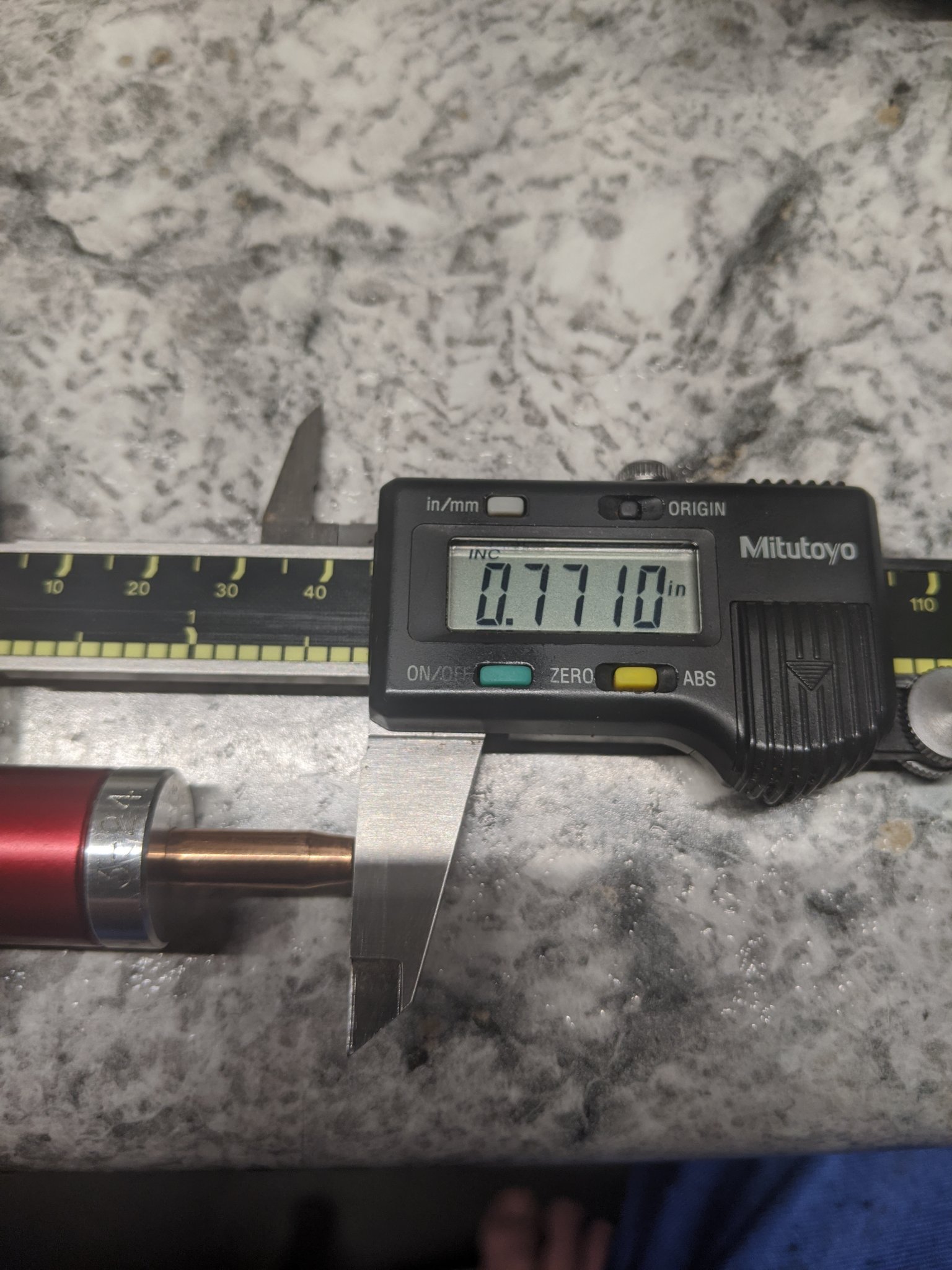

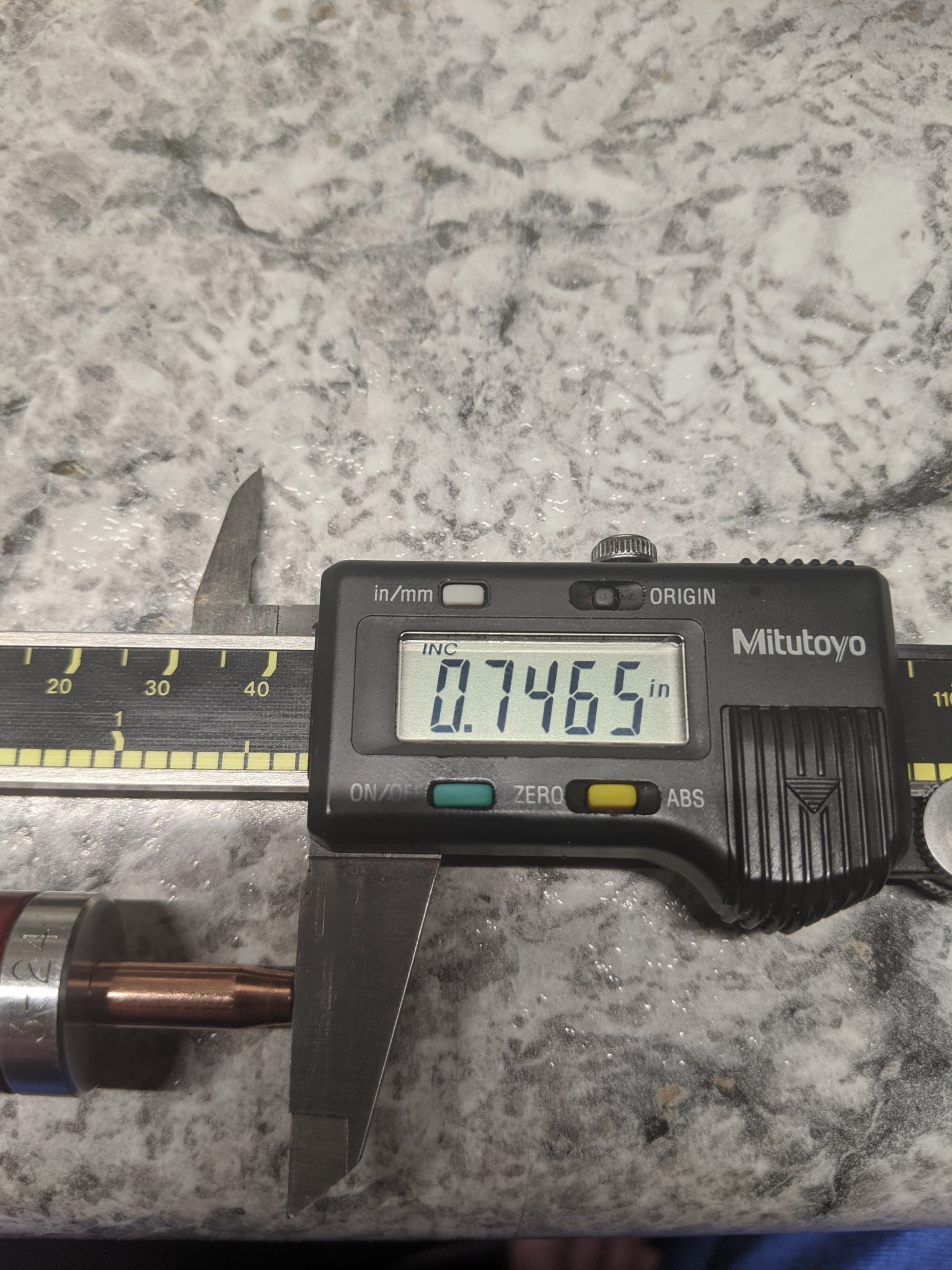

Just encountered this exact problem. Old lot is way different than my newly purchased lot. Old lot to the lands measured 2.201 cbto new lot measures 2.233 cbto.
