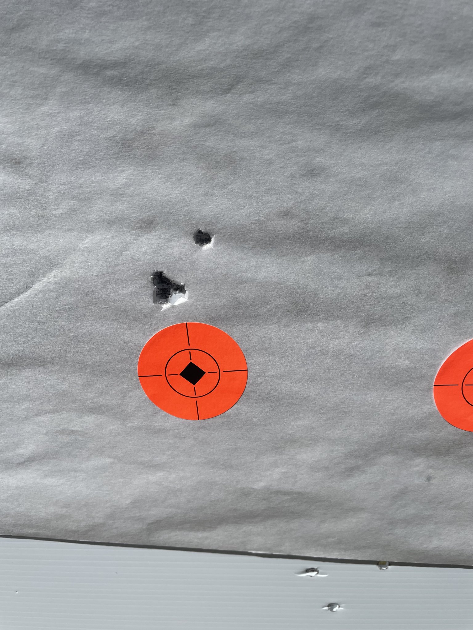

Was able to go out and shoot for accuracy 4 loads of 120 ELDm over 8208xbr. My largest load yielded the best results. 37.7 grains under the bullet with a 2.675 OACL was a 1/2” 3 shot group, 1“ 4shot group, and 2” 5 shot group. Speeds were slow coming out of the 16” barrel with 2645fps with a 7 sd for 5 rounds. There were slight ejector mark on the brass and I do not want to push further. I’m going to try again and do a load ladder with Varget and IMR4350 to see what results I can get. I’m happy with the speeds I get with 8208 XBR IF it is accurate... that’s still a big if.
pretty happy with my velocity numbers after comparing them with a bolt gun.
making a batch of 20 rounds with the IMR 8208 XBR with a 37.7 grain charge and Hornady 120 grain ELDm bullets. If it looks promising, I’ll start messing with OACL to try and tighten things up a bit.
Shooting some different charge weights to get more data. The 37.7 grain charge was wonky today with velocity and pressure signs in the rifle. I think that an accurate load can be found below max with some more work. I’ll let you know where I end up.
