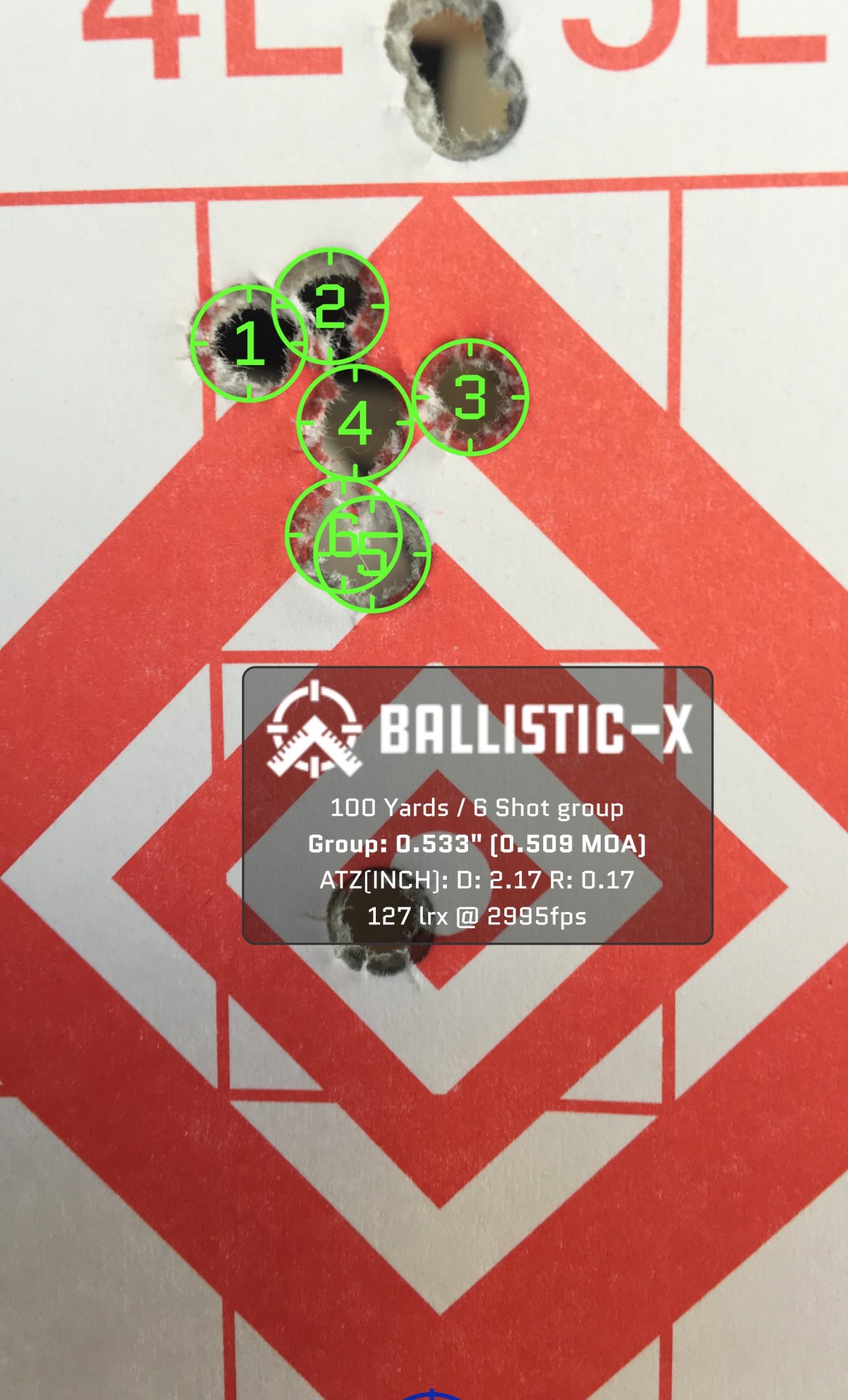

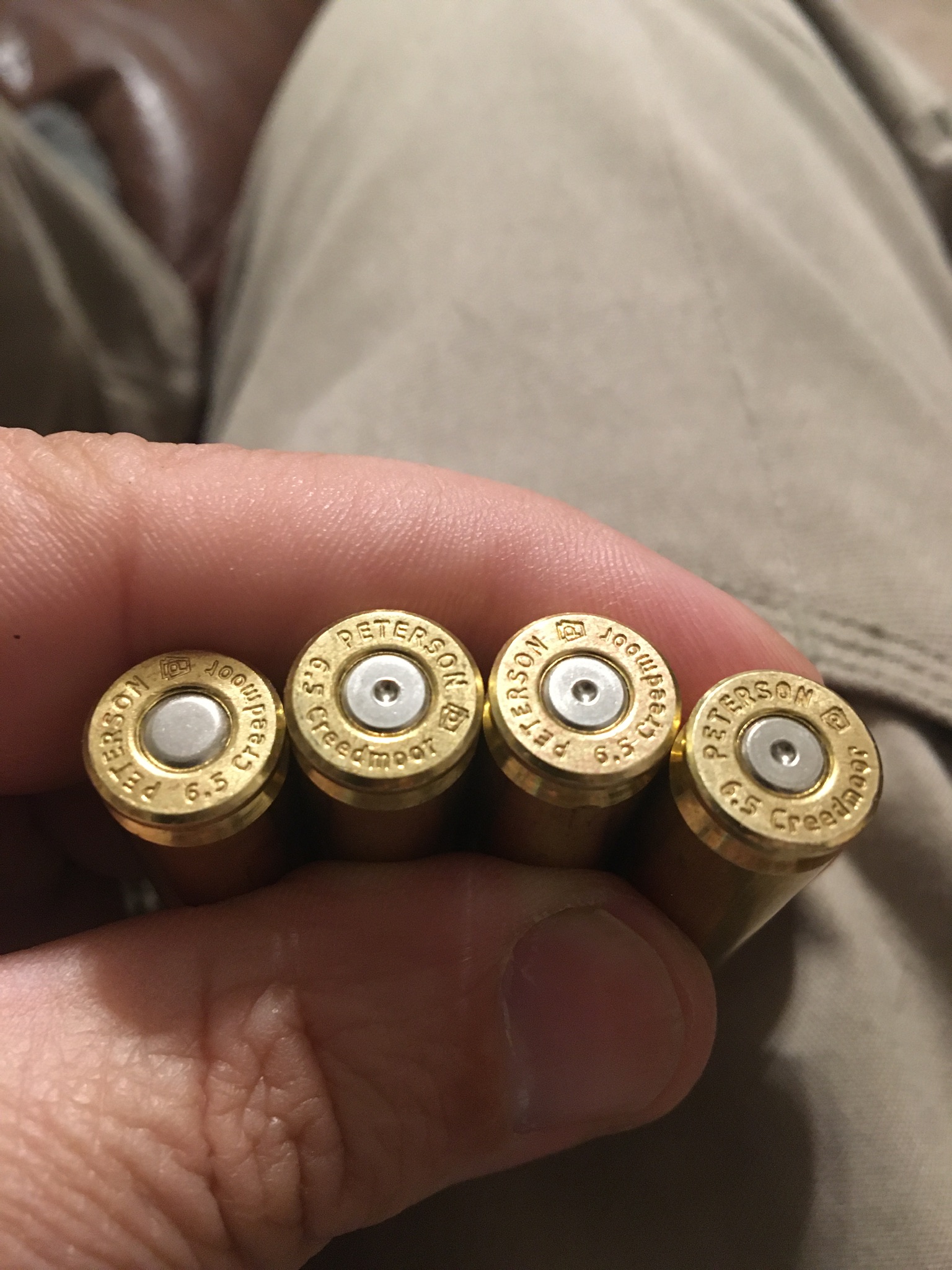

Attached the Magnetospeed and shot a string(slowly) of 9. Averaged 2997fps, I was a bit surprised as I hadn’t seen any velocities this high in my research, something approaching it in one publication @ 44gn however. Bolt lift was normal, primers slightly flattened, a very small amount of cratering on one.
Anyone else have any experience with a similar load? Not sure what inputs would be needed to run Quickload. 2.798 COAL, 2.205 CBTO.
Produced an acceptable ~.50 MOA, fwiw. First two went high, adjusted POA for the six shot group then removed the chrono for the ninth. 1” POI shift down without the Magneto attached.
My first 1lb batch of RL16 got me up to 3000 fps with 45gr through the 22" factory barrel on my B14 HMR, Lapua SRP w/ CCI 450. The 8lb batch was slower, only 2932 fps.
I'd say you're in a reasonable zone, esp with the longer barrel.
Reactions: Buckley
Visual inspection was looking like I was going to be lightly compressed at 43. I would imagine that with 45 it had a fair bit of crunch when seating.
Oddly, I don't have notes on it (I normally do), but yeah, I'm thinking you're right. I have this niggling memory that I was actually having to adjust the seating die deeper to achieve the same CBTO due to the resistance from the powder column. That sounds on-brand for this bullet, but I'm usually willing to compress extruded powder until I start seeing seating depth issues, then watch closely for pressure signs on the crunchier loads.
