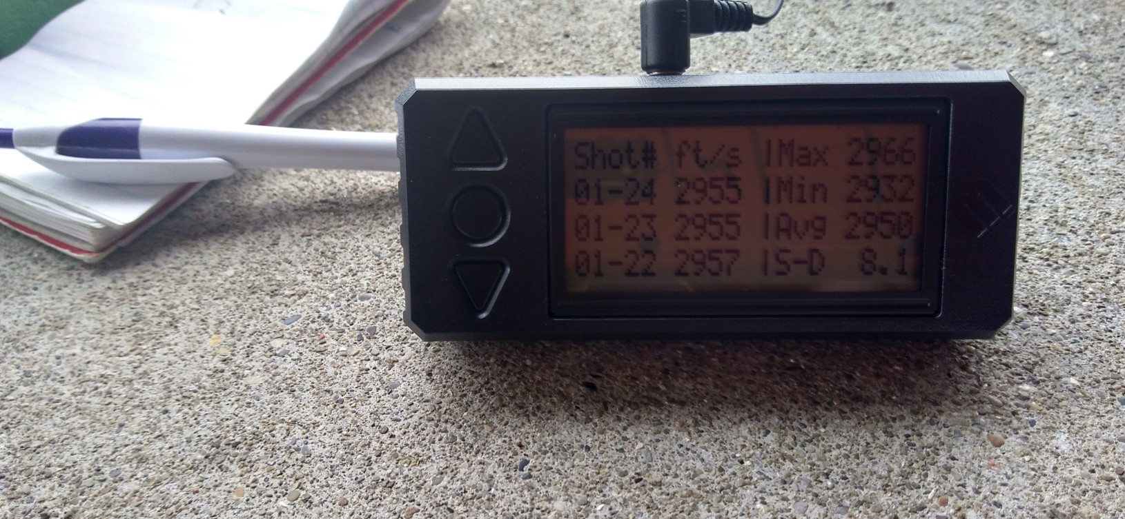

    I went to range today with RCC brass and 230gr A-Tip to see how will brass hold pressure.
    This is my load and in my rifle, please be careful because it might be different in your rifle.
    RCC Brass loaded with H1000, CCI BR-2 primers and 230gr A-TiP.
    Like i said in part one i will do concentricity of rounds loaded and i did, not to write out all numbers but out of 10 rounds 8 rounds where with 1 thousands of an inch and 2 rounds were runout of 1.5 thousands of and inch. In my books that's very good.
    My Weather 40 F, 28.6inHg, 64% Humidity My Altitude 1030ft
    76.4 GN = 2869 FPS no pressure
    76.7 GN = 2876 FPS no pressure
    77.0 GN = 2896 FPS no pressure
    77.3 GN = 2899 FPS no pressure
    77.6 GN = 2890 FPS no pressure
    77.9 GN = 2913 FPS no pressure
    78.2 GN = 2940 FPS no pressure NODE
    78.5 GN = 2938 FPS no pressure NODE
    78.8 GN = 2945 FPS no pressure NODE
    80.1 GN = 2966 FPS no pressure

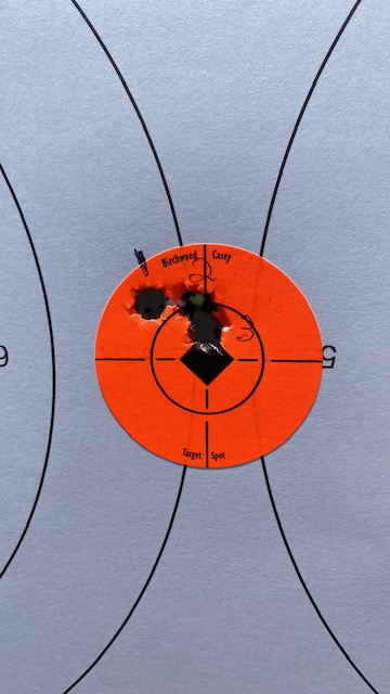

    Ok...load development update...with a SERIOUS caveat. First, since I'm now poor after this purchase I don't actually have a scope that is valid for this setup....so....after the first monkey spank group I heard a metal on metal clanking and I broke the borrowed scope. So the other 2 5shot groups opened way up and you can't invalidate them as accurate...because the scope went to crap.
    Details:
    Cartridge: 300 PRC
    Bullet: Hornady 230gr A-Tip
    Brass: Hornady once fired....shot yesterday
    Primer: Federal Gold Match Large
    Powder: Hodgden Retumbo
    Barrel: 28" Bartlein 1-9 Twist with a Lil'B brake, Heavy Varmint, spiral flute.
    Action: Defiance Deviant Tactical, Fluted, 6mil rail
    Trigger: TriggerTech Diamond - set to 6 ounces
    Scope: (laugh) Vortex Crossfire (/stop laughing)
    Distance: 100 yards
    Temp: 80F
    Wind: 10mph from 10o'clock - Steady
    Mirage: Negligible
    Elevation: 910ft
    Shot angle: Even ground...very flat
    Shooting position: Very steady benchtable with solid seat, front rest and rear small bag.
    Reference following loads with pic of target below
    Ammo:
    1. Factory 225gr ELD-M - reference load
    -----Start of 230gr A-Tips with Retumbo-----
    2. 68.5gr - shot way low, audibly softer, recoil softer, felt like a wimp load
    3. 70.0gr - came up near the factory load with similar audible and recoil.
    4. 71.5gr - basically same damn hole. Audible and recoil weren't discernible from #3
    5. 73.0gr - basically same dman hole. Audible and recoil weren't discernible from #3 or #4
    These three different powder loads shot a 3 shot group under a 1/4MOA...to me..that is a nice node
    Reloaded in blocks of 5 for the next groups
    6-10. 75.0gr Group - Shift the windage to pull the group left of the other group. Measued .473 with a dial mic. Target is .018 thick cardboard and flaked around the holes...hard to measure. For a gun with less than 30 rounds to this point....this group made me think naughty thoughts.
    11-15. 78.0gr group - Again, shifted windage to pull the group away from the previous.
    First shot I heard a metal on metal clang...didn't know what it was.
    Second shot went way low and then the adjuster ring for the parallax slid down the tube toward the elevation knob.
    Third shot I noticed an artifact in the lens.
    Fourth Shot I noticed something like extra scope shadow in the bottom left.
    Fifth shot didn't seem to get any worse
    This group can't be covered by a Quarter...It isn't the loads fault...I'll be able to buy the Razor GenII in a few weeks and revist this load again.
    16-20. 78.5gr Group - Same issues with the previous group and about the same results. I shifted everything left again to pull the group out of the path of the other group. I'll revist this load when I get the new scope.
    21. 80.0gr - OVER SPECS - Shift windage back to original wind zero and it shot high. Audible and recoil were very noticeable but brass appeared fine. When I de-prime I'll take notice of any primer pocket issues...and when I reprime, I'll see if it is loose or is noticeably easier to insert.

    I just got back from the range where I did my big Reloder day (mostly RL-26). So, if you're thinking of trying RL-26, and can find it for sale somewhere, I wouldn't buy it. Instead, let me know where it is, and I'll do the precision shooting population a big favor by taking it out of circulation.
    Two words: OH. MY.
    Let's get to the meat of the day first: Reloder 26.
    My first load was 74.1 gr. All groups today were at 300 yards and with the 225 gr ELDM (as always). I had expected this load to fall in the mid-2700 fps range. When I fired, I almost missed the target - as in the WHOLE target - because it fired high. The Labradar registered 2907 fps. The total group averaged 2913 with a 13 ES and 6.7 SD. Wow. Group size was 1.27" at 300 yards.
    Here is all the data:
    74.1 gr RL-26:
    Average FPS: 2913
    ES: 13
    SD: 6.7
    Group Size: 1.27"
    74.4 gr RL-26:
    Average FPS: 2926
    ES: 21
    SD: 8.8
    Group Size: 2.42"
    74.7 gr RL-26:
    Average FPS: 2932
    ES: 16
    SD: 9.2
    Group Size: 1.48"
    75.0 gr RL-26:
    Average FPS: 2950
    ES: 29
    SD: 13.9
    Group Size: 1.82"
    75.3 gr RL-26:
    Average FPS: 2965
    ES: 7
    SD: 3.1
    Group Size: 1.32"
    75.6 gr RL-26:
    Average FPS: 2979
    ES: 5
    SD: 2.3
    Group Size: 1.52"
    75.9 gr RL-26:
    Average FPS: 2999
    ES: 25
    SD: 10.9
    Group Size: 2.33"
    76.2 gr RL-26:
    Average FPS: 2994
    ES: 12
    SD: 5.6
    Group Size: 1.28"
    76.5 gr RL-26:
    Average FPS: 3021
    ES: 31
    SD: 13.6
    Group Size: 2.8"
    Slight pressure signs
    76.8 gr RL-26:
    Average FPS: 3031
    ES: 21
    SD: 10.5
    Group Size: 3.21"
    I am very surprised by the velocities I got with this powder - well above advertised. I am also happily surprised by the consistency of certain loads (75.3, 75.6, 76.2). Clearly this powder well outperforms either Retumbo or H1000 in my rifle.
    Next, I did my neck tension test. I ran groups at .001, .002, .003, and .004 inches of neck tension. I'm not really a fan of .001, but it clearly won the spread contest. This test was with 76.2 gr of H1000.
    .001 Neck Tension:
    Average: 2856
    ES: 8
    SD: 3.6
    .002 Neck Tension (what I ran all other tests at):
    Average: 2874
    ES: 16
    SD: 8.6
    .003 Neck Tension:
    Average: 2871
    ES: 25
    SD: 11.1
    .004 Neck Tension:
    Average: 2875
    ES: 44
    SD: 19.8

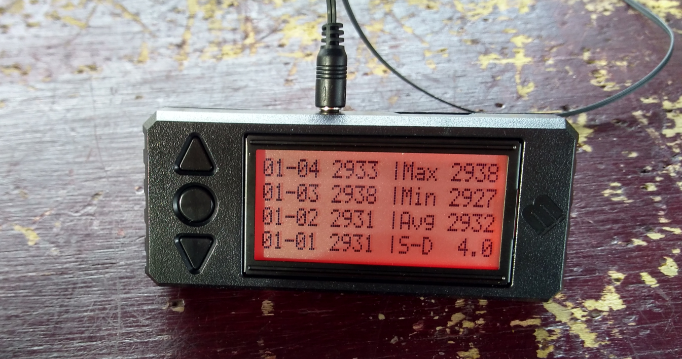

    Update from day 2 at the range:
    Good news and bad news here - fortunately the bad news is more about data collection than anything going on with the build.
    Bad news first:
    My Lab Radar was failing to pick up a fair number of shots. I'm pretty sure the blast from the Little Bastard brake is knocking it around. I love the Lab Radar unit, but my biggest issue is that they have crappy solutions for mounting it, especially for use with larger caliber rifles with brakes that blow backward. I think I'm going to have to craft something that clamps it in and allows sand bags to weight it down (current thinking is just getting a drill press vise, and mounting it to piece of plywood).
    The main issue with this is that of my nine neck-turned, annealed rounds, only three registered, so there's just not a big enough sample size to gauge the difference vs. other.
    Here are the muzzle velocities I was able to capture (working backward):
    2956
    2928
    2950
    2933
    2945
    2935
    2950
    2943
    2932
    2934
    2943
    2945
    2931
    2924
    2945
    2954
    2925
    2932
    2924
    2930
    The three neck-turned/annealed rounds I was able to capture
    2936
    2953
    2930
    There's still a big ES, but the numbers tightened up considerably. If I had already done load development and was getting the spread I'm getting here, I'd not be happy, but this isn't bad considering.
    More notes:
    Versus first set, average velocity ticked up slightly from 2935 to 2938 (roughly .1%), and standard deviation went down to 9.9.
    Group size decreased. Best was .34 MOA, with most hovering near half MOA. I expect these to go down with load development. I will also probably
    No signs of overpressure on any brass.
    Load: 78.5 gr H1000, 225 gr ELD-X, Federal 215M primers.

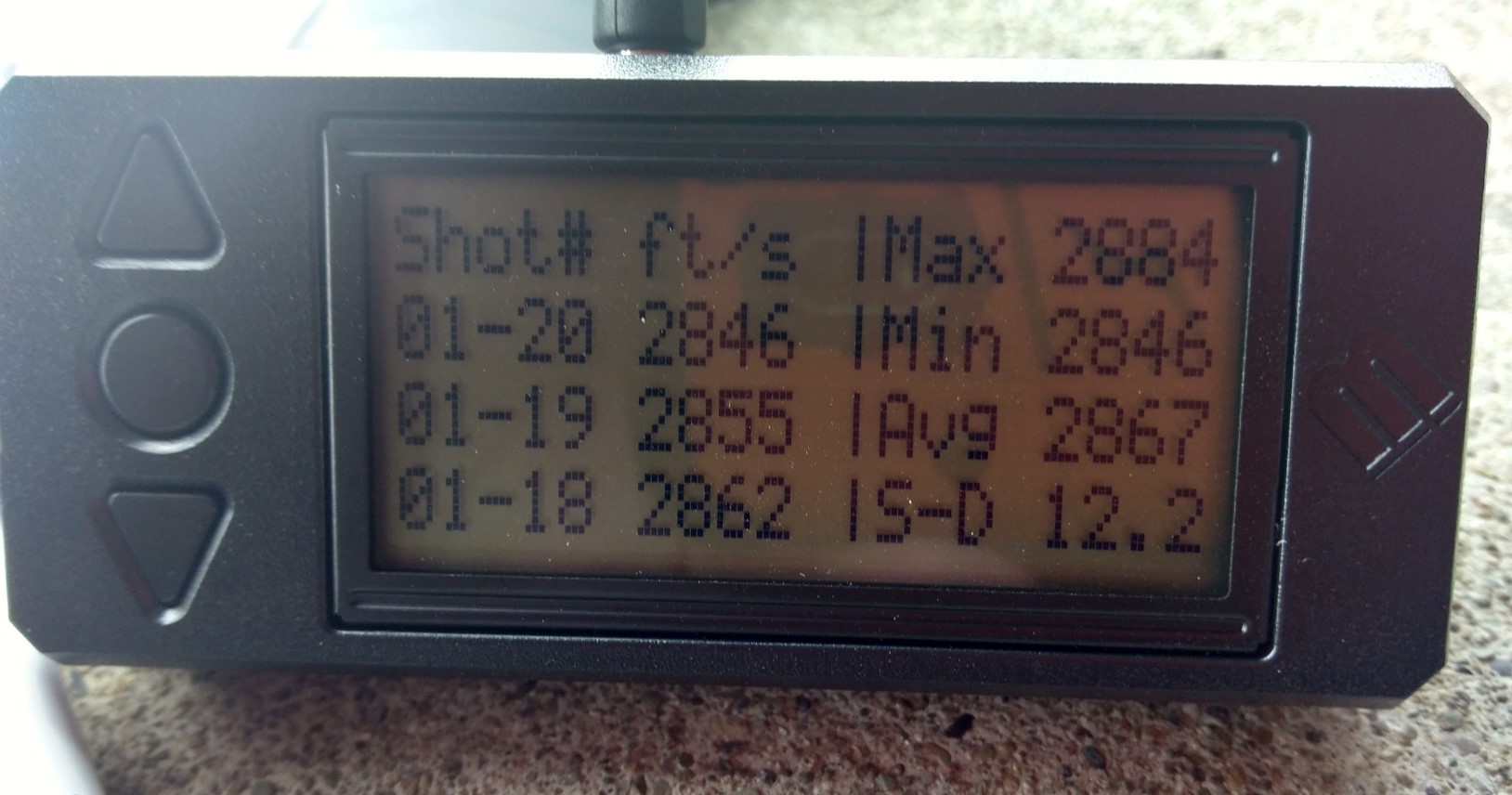

    Hornady Brass: I think I'm guilty of Group Think Bias. Let me show you a pic:
    Yesterday I shot 50 rounds of 78.5gr Vihtavuori N565 with 225gr ELD-Ms using FGMM #210 LRP....Not Magnum Primers....35F. This was firing #6 it seems after checking my logs. The above pic is my first 5 shot group. I did 10 5 shot groups and saved the data and this morning I looked at it.
    For 50 shots my slowest was 2925 and my fastest was 2939...for an ES of 14 for FIFTY shots. Of the 50 shots I had only one at 2925, one at 2927, one at 2936, one at 2937, one at 2938 and one at 2939.....other than those six...this stuff was TIGHT. Of the 50 shots... 35 of them were measured at 2931fps.
    Now, let's be real here. A traditional optical chrono would error out if you shot back to back 2931's....I show strings of 6 in a row at 2931....wish I would have snapped a pic of that. So...if the online Standard Deviation Calculator is correct...over 50 shots...we had a SD of 2.26274 That is insane!
    So my question is this....if I had 'better' brass....what would that do for me? Would it simply remove all the headache and prep work I did to get here? If so...it really wasn't that bad. I've only lost one piece of brass so far and that was after...ahem...pushing things too far on a load work up and shooting a piece I knew was beyond pressure range....yea...stupid. The primer just falls out with a light tap...so it becomes a future brass hammer.
    Like I said, for years I've been on the 'Hornady brass is crap' train...and yea...some of that is warranted with some of the calibers I've shot....but 300PRC may not be as crappy as we think. I know it isn't going to hold up like machine turned brass...and it might be inferior to Lapua, Peterson, ADG and whom ever else comes to market....but all these "I'm not going with the 300PRC build because it has crappy brass" comments are starting to look like complete bovine excrement.
    So, I'll hop off the group bias train that is anti Hornady brass at the moment...because my numbers tell me that until brass that is both better and affordable comes along....I'll stick with what I got and enjoy my 300PRC with no nagging questions in the back of my mind.
    I hope everyone has a wonderful day and gets the chance to get out and Shoot!!!

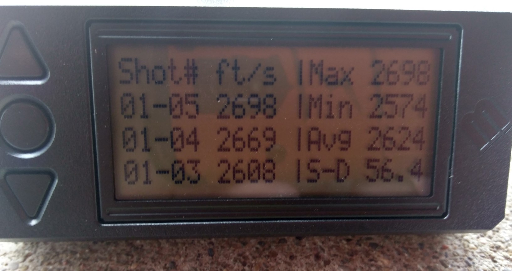

    Now to the exciting part: 250gr A-Tips!!!
    Only loaded 5 rounds. Started at 76gr and worked my way to 80gr of Reloader 33.
    76.0 grains = 2574fps
    77.0 grains = 2574fps <-- what??
    78.0 grains = 2608fps
    79.0 grains = 2669fps
    80.0 grains = 2698fps Slight swipe/ejector mark. Very minor
    This was the worst of the three powders tested. RL-33 can stay in the cabinet for now.

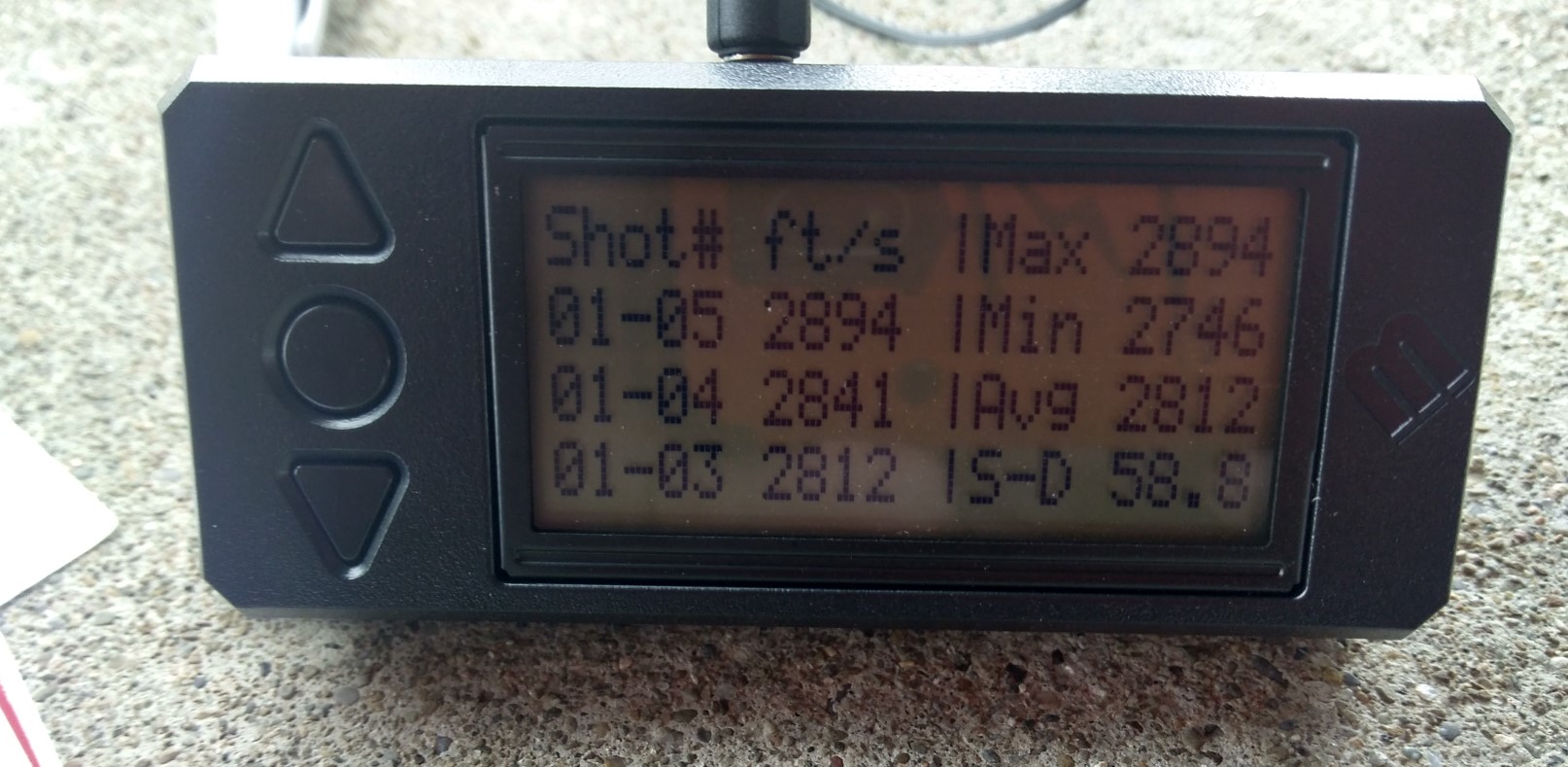

    Next: Retumbo
    Only loaded 5 rounds. Started at 76gr and worked my way to 80gr of Retumbo.
    76.0 grains = 2746fps
    77.0 grains = 2768fps
    78.0 grains = 2812fps
    79.0 grains = 2841fps
    80.0 grains = 2894fps Slight swipe/ejector marks. Very minor. Depriming was still showing tight primer pocket.

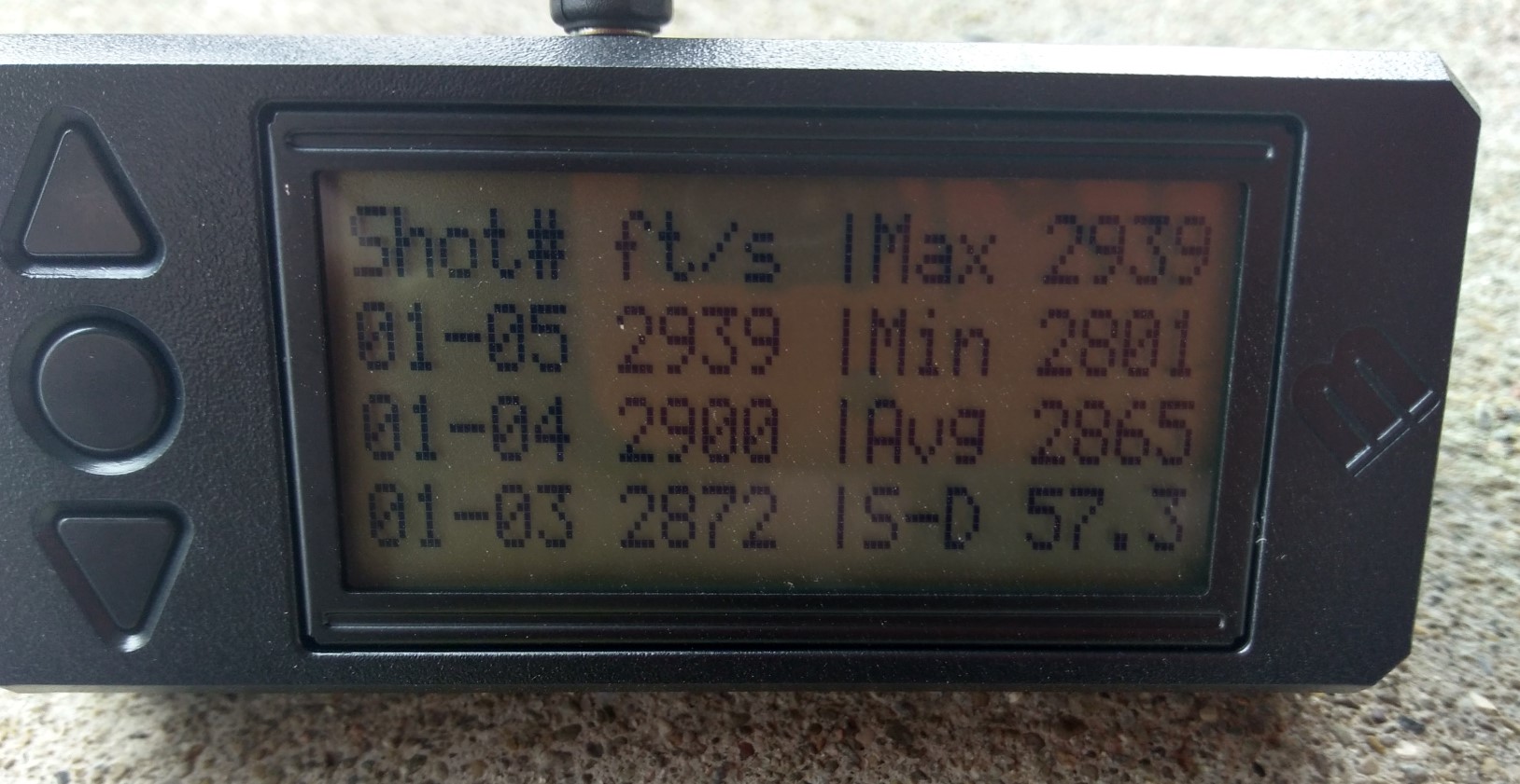

    Now we are getting somewhere. I was happy with this load....until I did some Vihtavoruori N565.
    Only loaded 5 rounds. Started at 76gr and worked my way to 80gr of Vihtavoruori N565.
    76 grains = 2801fps <- started checkinf for pressure right away at that start speed. No pressure.
    77 grains = 2817fps
    78 grains = 2872fps WHAT!!!!
    79 grains = 2900fps Holy Jebezus No Pressure signs
    80 grains = 2939fps and I almost fainted. Very very light pressure swipe marks. Less than the other two powders at same load.
    I think for my gun... N565 wins hands down....no contest. A little info:
    Temp was about 30F
    Wind was about 10-12mph switching between 7 and 8 o'clock.
    It was cold, damp, and miserable...but I had fun.
    I seated these to where the start of the boat tail married up with the flare from neck to shoulder. Just like I do with the other weights....however, this made them too long to magazine feed and had to be individually hand loaded.
    Once I hit 78grains of N565, I was slamming the 300, 400, 500 yd 8 inch steel targets with the same dope I had for the 230's. I'll load up more next time to see how they perform at distance. I will also load some up and take to a closer range to me....to shoot a few groups. But I'm really interested in seeing how they react at long distance. See how stable they are in my 1-9tw Bartlien at 28 inches. See if I can get some consistent impacts at 1000yd+
    Well, I hope this data helps some of you.

    N565 Target Pic:
    What's that in the bottom right? It is a 'control' group...heh...actually it is 5 rounds of mixed powder and bullets that I was fouling the barrel with. I had just done a good scrubbing of the barrel the night before. You don't see 5 holes? The first shot was off paper to the right due to not looking at my scope dials and having the windage turrets moved 2 mils. IT's good to have those mistakes when not on the clock...when it doesn't matter.

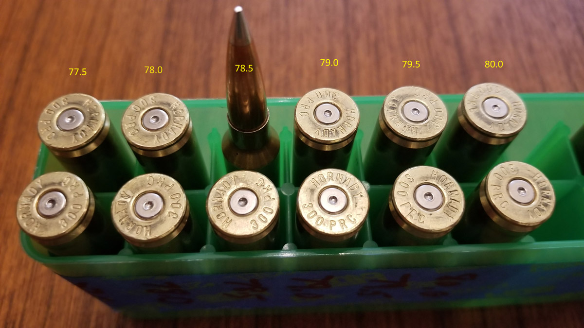

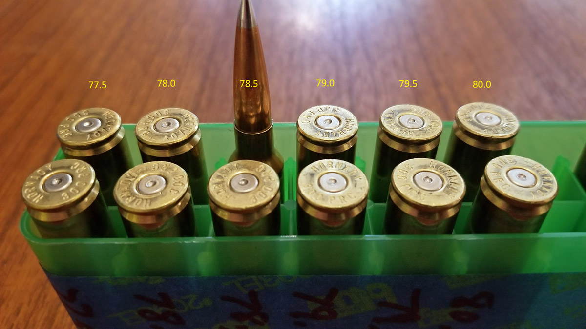

    (post 2719):
    Purchasing a string gauge is on my list of things to buy....Trying to be a good steward and help with powder development for the GordonsReloadingTool software.
    I am backing down from the max I tested. As you can see below... 79.0 grains of N565 and RL-26 is no bueno.
    N565 on top....RL-26 on bottom

    @TripleBull Today I reworked up my load for next weekends events. We run similar loads.
    Today was a nice cool summer day.... 78-80F during the session....no wind....sunny. 900ft ASL Using a Magneto Speed V3.
    Some of my groups and velocities I tried loads on....sucked compared to my set in stone load...but at the end of the day I found a new load.
    First...my barrel has 1034 rounds through it now...so things change. I will rebarrel and most likely go back to my old load...which is almost identical to your probable load.
    So here is some specs.
    28" Bartlein 1-9
    ADG Brass 3rd firing
    VV N565
    A-Tips 230gr
    Federal 215M
    OAL came out to 3.850"
    I jumped from 78.0gr to 78.5 grain. I also...GASP...went from an LE Wilson neck sizing die....with a .334 bushing...to a Full Length sizing die...with the same .334 bushing. I bumped the shoulder back 2 thou. Everything was freshly annealed. Neck tension 2 thou using a Sinclair Mandrel. Bullets seated with an LE Wilson Arbor press die....K&M arbor press.
    so...over 1000 rounds down the tube... here is my new load:
    Max speed of 2952fps
    Min Speed of 2939fps
    AVG speed of 2946fps
    Standard Deviation of 5.7
    Group size on said group: 0.34" at 100 yards.
    I may have breathe just enough life into this thing to get me through a few more comps....then a rebarrel. We will see if I was successful at 1 mile and 1000yd tactical
    Reactions: TripleBull

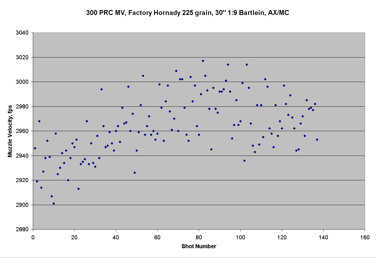

    How many rounds are you guys shooting before your barrel speeds up?
    I'll be joining the 300 PRC club this week with the arrival of an AXMC, which will have its 300WM barrel change to a 26", 300PRC WinTac (believe those are Bartlein blanks). My plan is to shoot factory Hornady 225s to gather some data and let the barrel settle. Once it speeds up, I'll start load development with N565 and RL26 using Berger 220s and H225s. I'll post the data to the thread once I can get the powder in hand (found it, just awaiting order fulfillment and shipping).
    I looked through the thread (thanks OP) but did not find data for the Berger 220s - if anyone has been shooting the 220s - please post it up. TIA.
    ETA - This thread needs to be tacked to the top. :)
    I noticed my 28" 1-9tw Bartlein speeding up in the first 50 rounds....then after a 100 or so...it was locked in. I thought it was still speeding up...but it was more me using different powders and stuff.
    I also didn't do any stupid barrel break in procedures.
    Appreciate the reply. I do a wet patch the first five rounds just to see if there is any fouling, if not (and there usually isn't) I just keep shooting.
    I also shoot an AX in .260 and did a lot of load development with differing powders and bullets. I'm going to keep it simple for the PRC and stick to RL26 and N565, and the 220 Bergers and the 225 ELDs. I made the mistake of buying the rifle before I bought any components, so the search was a pain and the processing / shipping delays are killing me.
    I still haven't located any ADG brass so I'll shoot the Hornady for a while, then adjust loads once I get a stock of the ADG. Found some primers locally (note the "good" price) and bits and pieces are arriving daily, including a Dave Tooley AXMC 300 PRC barrel. And wouldn't you know it, but I totally forgot to order a darn shell holder, which won't be here until Saturday.
    This plot is the first 140 rounds of factory ELDM 225 through our barrel. The peak of the hump was a very hot day and the last day was cooler in the fall.
    I appreciate data and the chart, which reminds me I should try and shoot the same ammo through break in. I have 200rds of the H225s coming from two different sources, 60rds of the 212 ELDX Hunter (just because I wanted to shoot something!) and I ordered 100 rds of 220 Bergers in Hornady brass with 215Ms using IMR 7977 (they were out of ADG brass) from Unknown Munitions. I need to temper my schoolgirl giddiness on joining the magnum club and do this right.

    I went back to the range this afternoon to try some more load development. Unfortunately I'm still trying get my LabRadar figured out, but it was not cooperating at all this afternoon. That was strike 1.
    I loaded 2 rounds each at 77.5, 78.0, 78.5, 79.0, 79.5, and 80.0 (H1000, Hornady brass, A-Tip 230, 3.685", CCI LR Mag primers). One of the 78.5 rounds would not completely close the bolt and I have not had a chance to get out the calipers to figure out what it's issue is.
    The wind was blowing hard and gusty so I decided to shoot at 100 yards instead of 200 yds. That was strike 2.
    Without any velocities and being at 100 yds (looks like one giant node. LOL) there was very little 'learned' today.

    Doing some load development. Ruger RPC, H1000, Hornady brass, Hornady Match sizer die with 0.334 neck bushing, A-Tip 230s, CCI 250 primers, 3.685" COL. 200 meters.
    Not sure why 78.5 offset to the right so noticeably.
    Edit to add: I wasn't running my Labradar as I am still working on a mounting solution that works well when shooting the 300 PRC, however previous tests showed 78.0, 78.5, 79.0 were all in the 2800 +- 15 FPS range.
