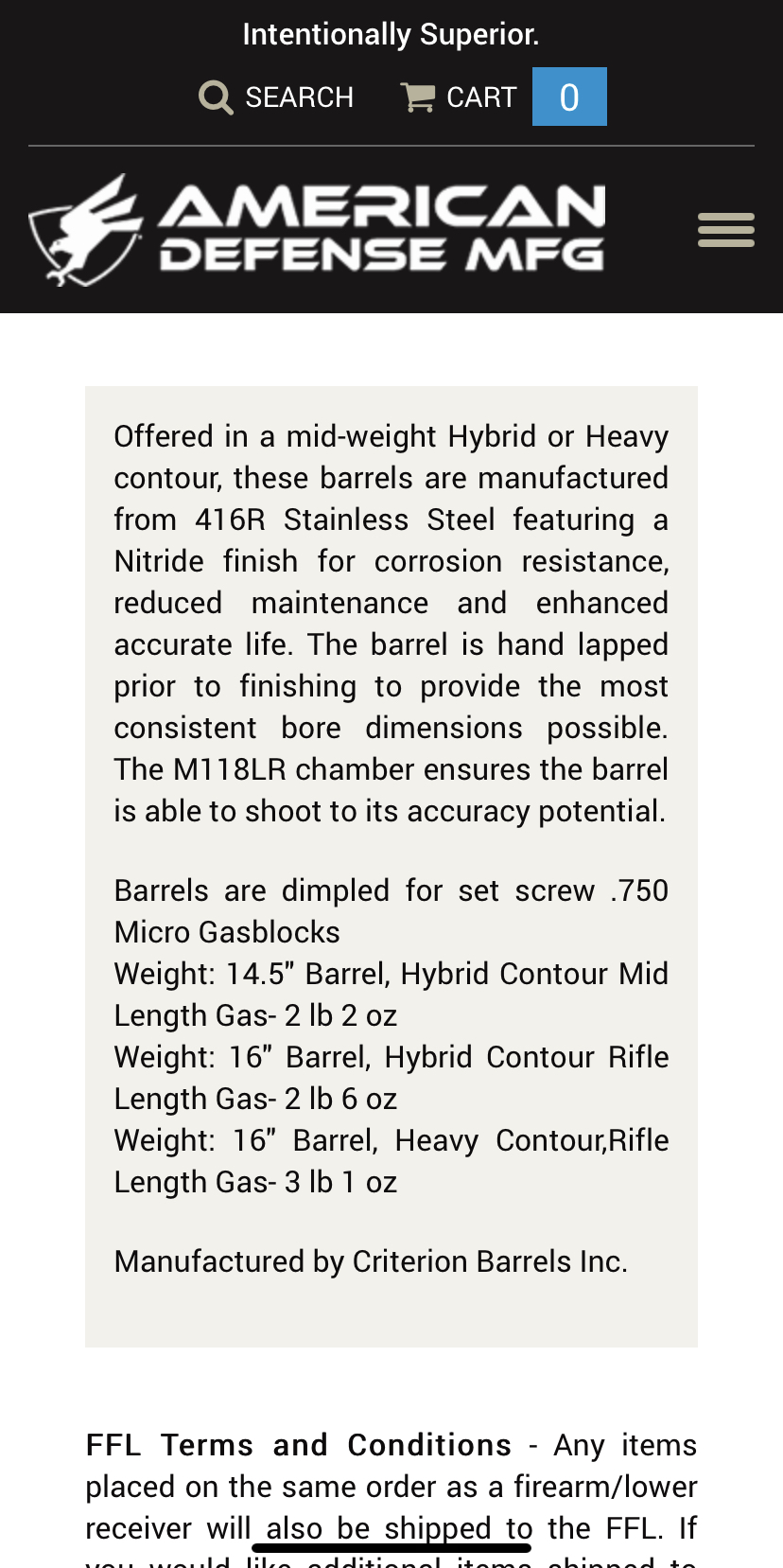

But I guess where I'm stumped is what would be the best barrel for it around the $350 or less range? I don't plan to ever shoot it past 300 yards.
The only looking into it so far that I've done is Criterion barrels, not sure how you guys feel about them. But they offer some 308 options in 16 and 18 inch, so I would have to cut it down. The guy at Criterion did tell me to NOT go with chrome lined or nitride barrel if I plan to cut it down because it could ruin it, stick with Stainless he said.
I'm open to all suggestions!!!!!
X-Caliber, McGowen, and others will custom make a barrel around that price range. Criterion is great, but I would not bother cutting an existing barrel down...

A quick google search shows V7, Spikes Tactical, Ballistic Advantage, X-caliber, and a couple others. I didn’t check prices. Armalite shows a 14” option if you wanted to use an armalite bcg & gas tube.
ETA: Again, check with ADM

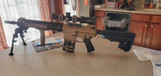

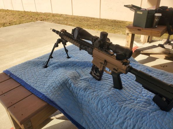

I think that alot of this stuff really depends on what you want to do with a particular rifle and thinking about what makes sense. I have an 8lb SR25 set up with just an EoTech and honestly, it handles pretty nice, I could see swapping the Eotech for a TA33 and calling it done for a walk-about rifle on the east cost. a 7lb SF 308 with a lpvo could be pretty neat for a similar role.
