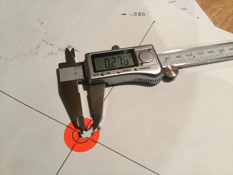

    Looks like more jump is all I needed. I set back .080 off the lands and I think I'm done.
    Im not much of a group shooter but I shot one group of 5 and I think it's a winner.
    Thanks for all the advice.
