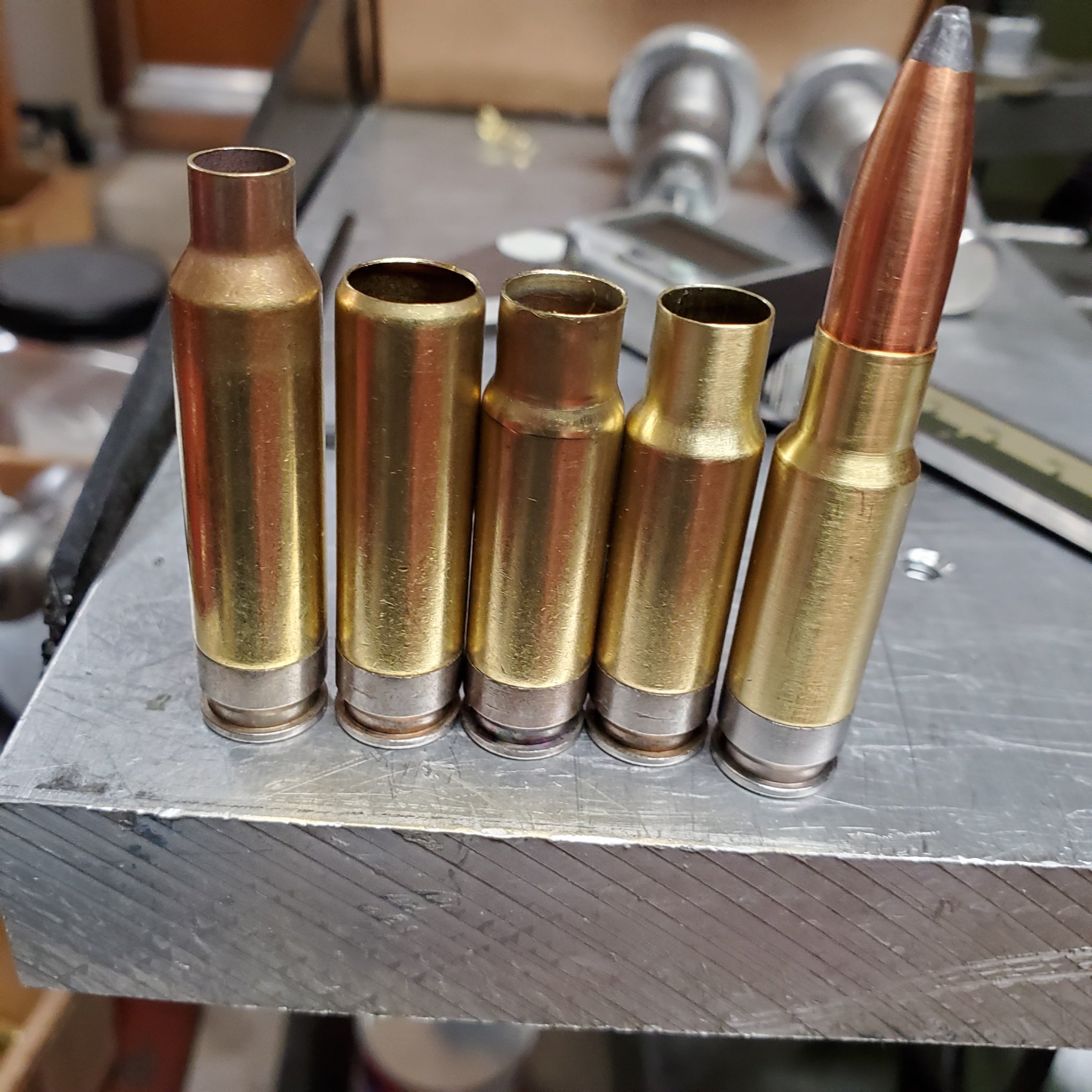

7-08 Would probably be the easy button.
The easiest is the 277 Fury.
But any caliber based on the 308 case can be improved in velocity without going to the full 80,000 psi.
Primer pockets stay tight.
I run 358 Win, 308 Win, 6.5CM, 8.6 Blkout, all with hybrid cases.
So you can improve your 6.5 CM to complete with the 6.5 PRC with hybrid cases.

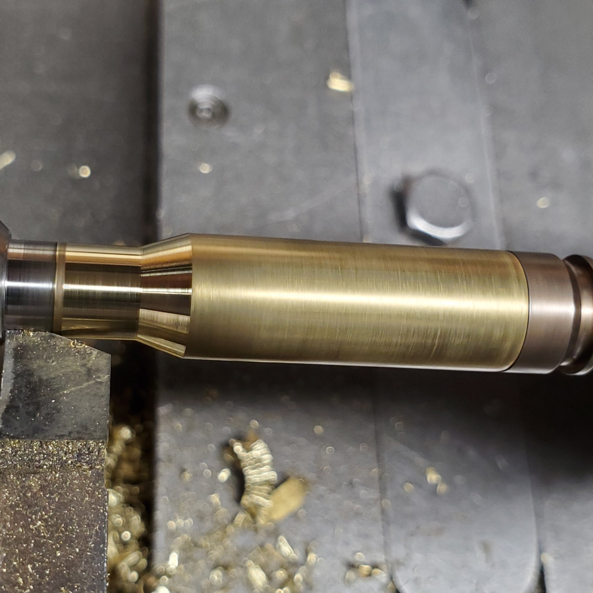

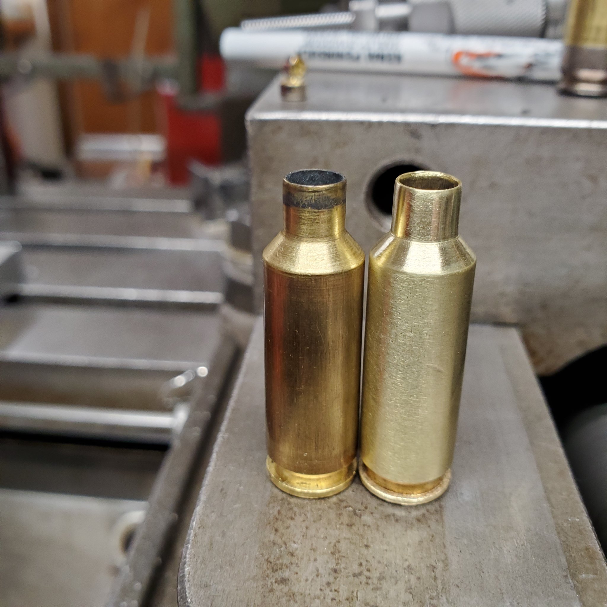

Hybrid cases from 264, 308, 338, 358, and 375...and steps in making 8.6 Blkout.
I modify them by the hundreds.
Test 308 high performance loads.
And how I neck turn, but into the shoulder is good enough with hand tools.

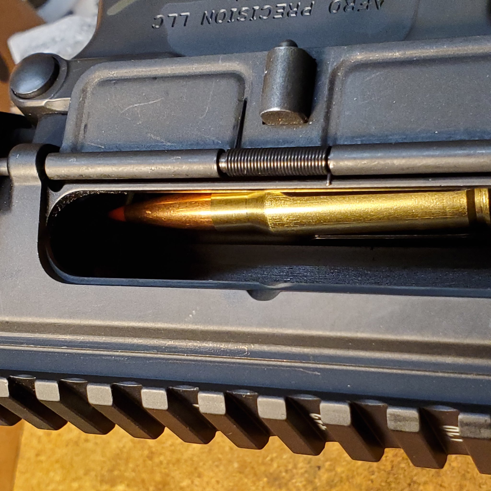

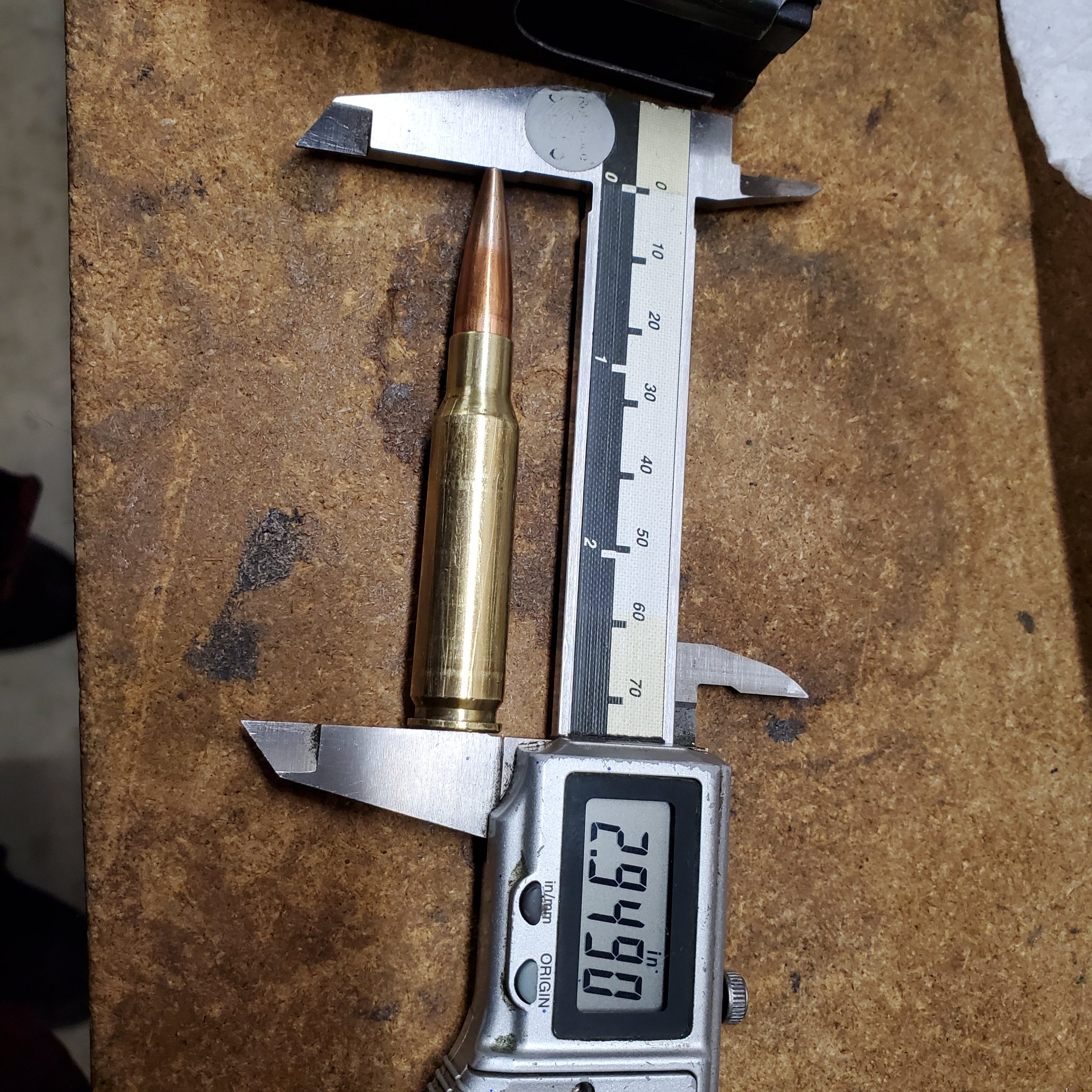

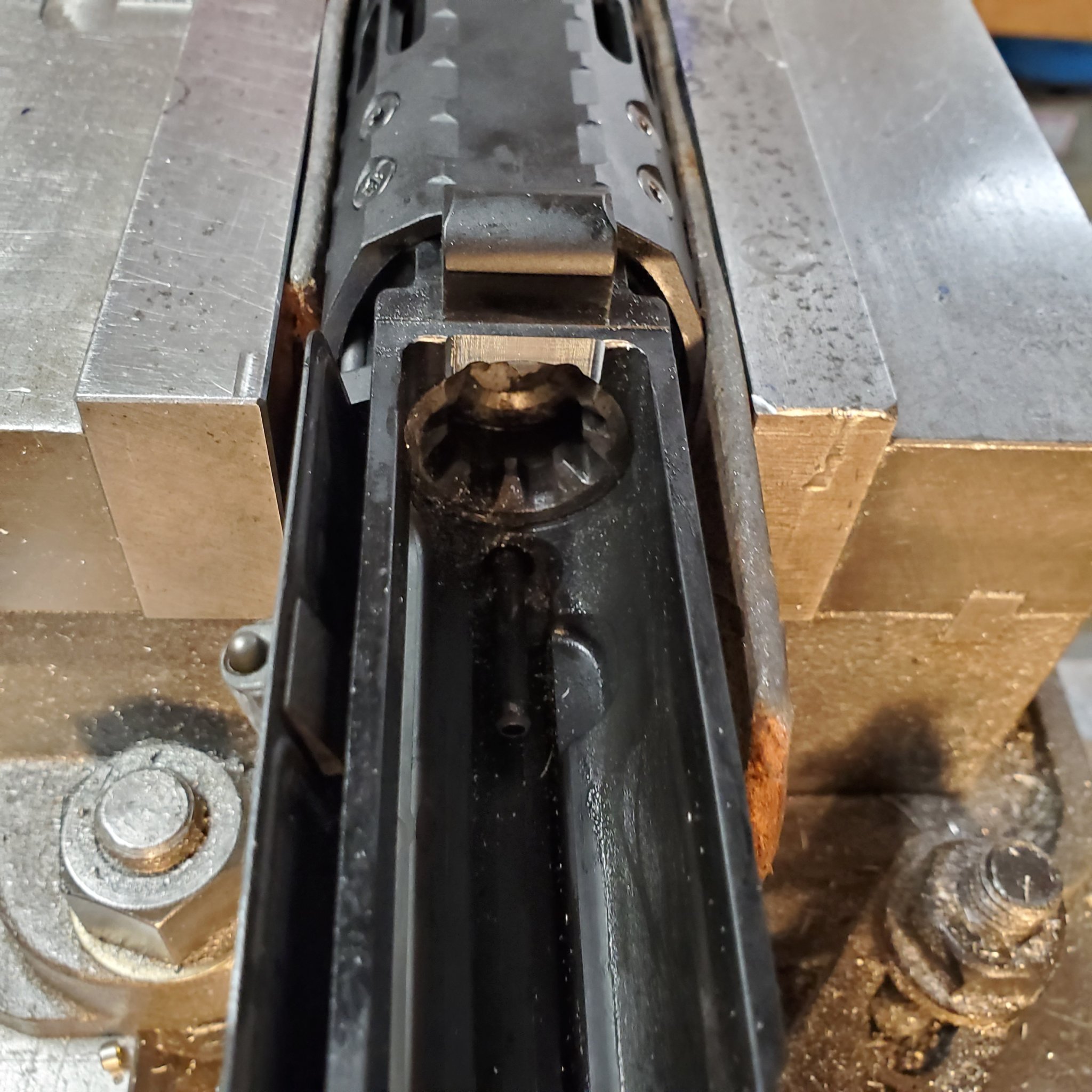

How do you fit a 230 atip in a 2.80in coal AR10 magazine ?
You modify your AR 10 to feed 2.960" cartridge, with your Bridgeport mill and carbide end mill, and mags too.
But I'm not shooting 230 gr Atips in the AR10...but I could. That would be my bolt gun where 250 tips can be fired out of the mag.
And use a long action for your 308 build and go 3.4" for 250 ATips in your 308...if ya want with an 8 twist 30" barrel, for maximum effort.

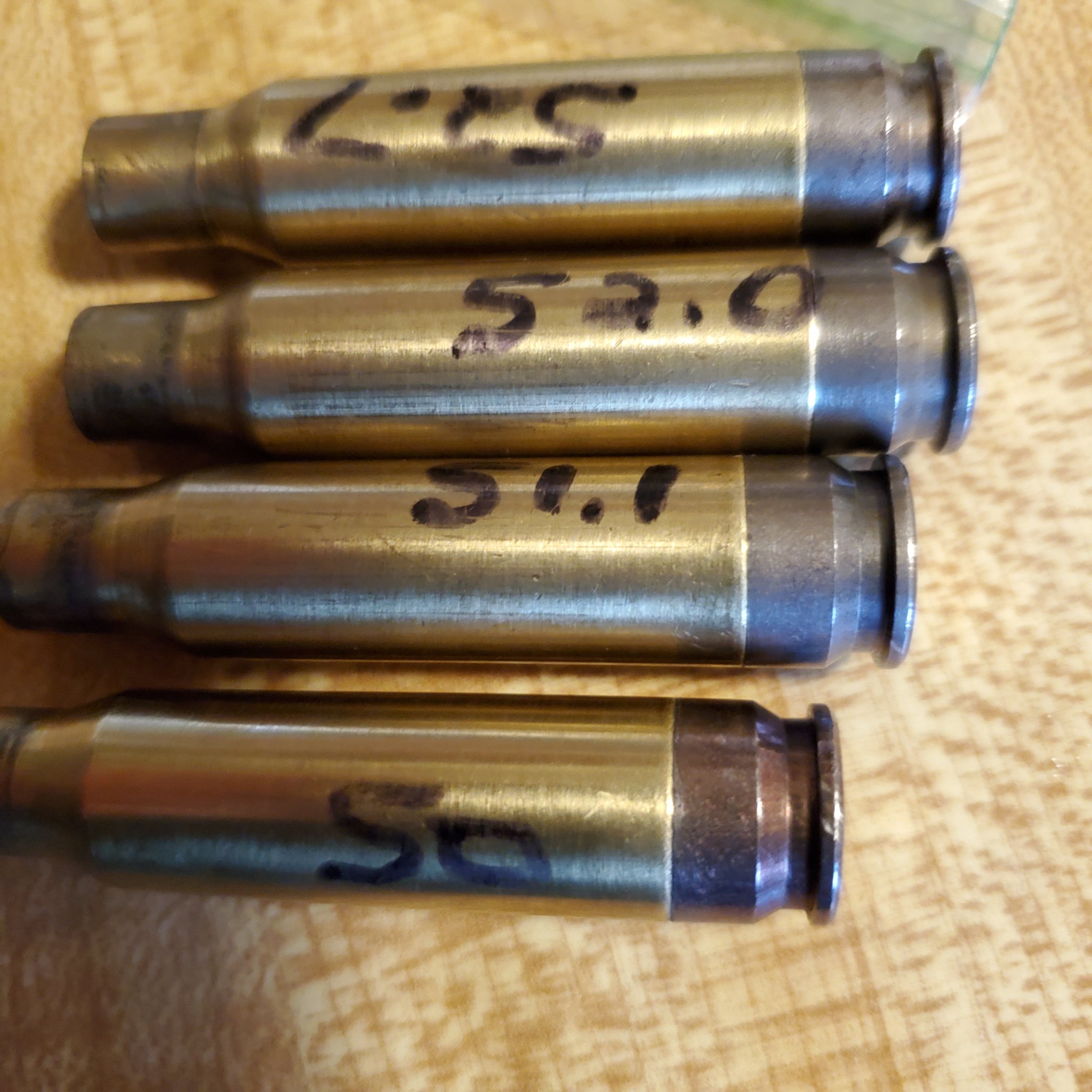

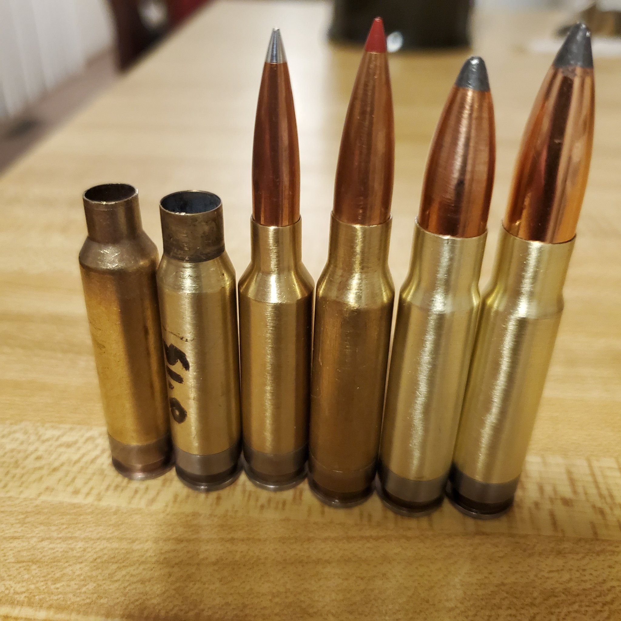

I have both 2 6.5 CM's and 8 308's ...so I know what they are capable of ...if you handload, and chamber your own rifles, use heavy high BC bullets, 9 and 8 twist barrels, the 308 can easily out perform the 6.5 CM.
You need hybrid cases to bring the CM back into contention. Then it's pretty good again. I use the both, but dropped the 6.5 CM for awhile, because it couldn't keep up...until I acquired hybrid cases, and run high pressure handloads with RL 26, so now it's back in the lineup...plus a new 26" Bartlein 6.5 CM barrel, ready to go.
I’m told that those slower powders with longer duration port pressure cause excessive wear on AR platforms and might be a tad risky. If I remember correctly Hornady published an article on the subject and recommended NOT using Superformance with AR platforms.
Have you seen any indicators of premature wear & tear on your rifles components?

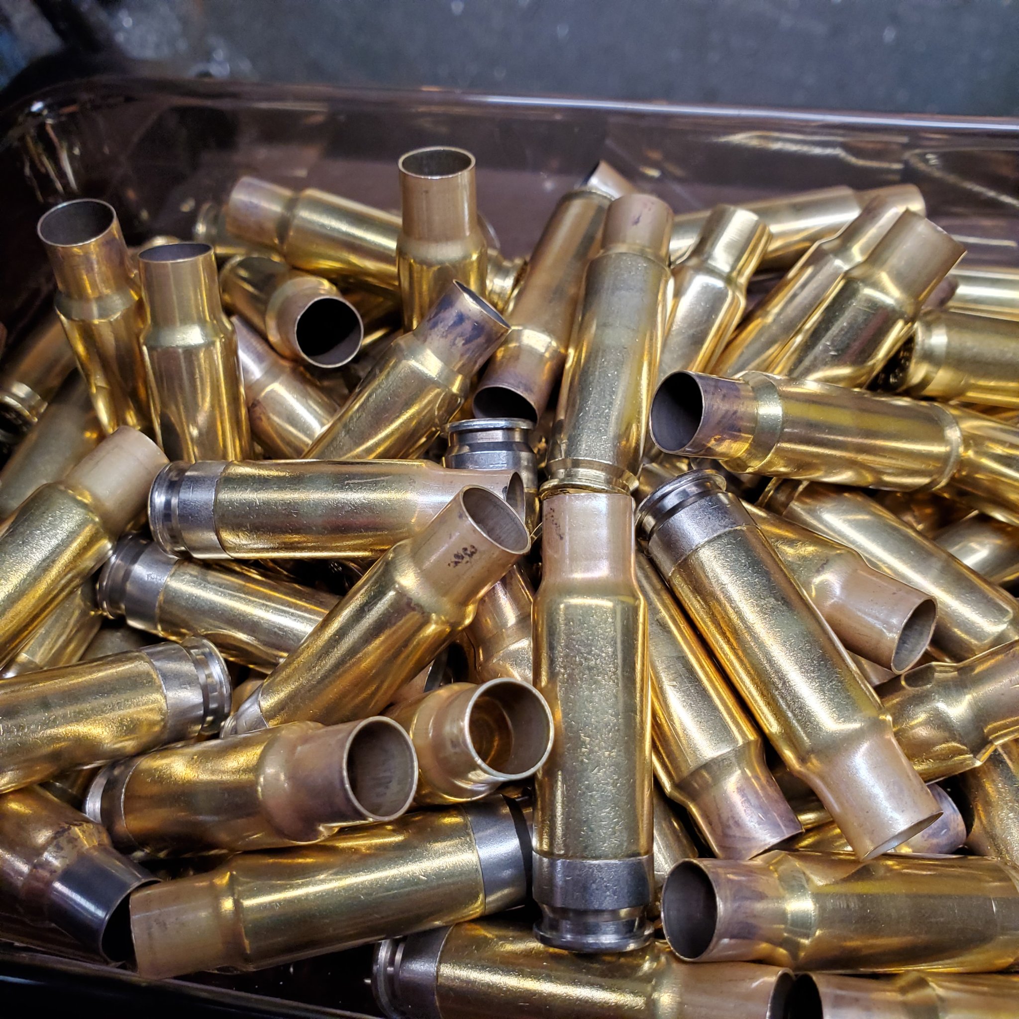

I have a couple thousand, and I purchased the last 300 available...for now.
I use them for 8.6 blackout, 6.5 CM, 308 Win, and 358 Win.
Here are some pics, and one string of 308 Win 200 gr SMK .715 BC at 2874 fps ave, probably out shoots your factory 6.5 CM, in every category, and they have been up to 2952 fps in the long barrel.
So that's why the cases are needed to bring my anemic 6.5 CM back in contention with the 308, using 150gr SMK or 153 Atip bullets.

So I've built a 510 Whisper, a 338 Spectre, a 30 RAR, 8.6 Blackout, 338 RCM,...so I've been busy, and do not shoot hybrid cases every time I go shooting ...I have other interests that require aot of time.
No you can not substitute RL 25 for RL 26 and get the velocity.
Any regular commercial sizing die works on every caliber I've tried...the SS cases heads are slightly undersized just like your brass cases...so the sizing die does not size down the SS case heads.
I do not anneal after every firing, just on the initial sizing, along with neck turning.
And a .002" shoulder bump is enough just like loading regular brass cases, cause they are brass except for the SS head portion. And one can get atleast 5 firings from the hybrid cases, most likely much more.
My next 308 load will be copper 110 gr to see how they fare in an 8 twist with hybrid cases, in a bolt gun.
The next project is to put the 510 Whisper into an AR 10 or even an AR 15, with 300 gr Barnes bullets for the most muzzle energy possible out of an AR.
It requires alot of work, complete barrel profiling, chambering, threading, gas port, barrel extension, gas journal, etc..including mag work, case making, and bullet making for sub work....Why? Cause no one is making .510 barrels for ARs.

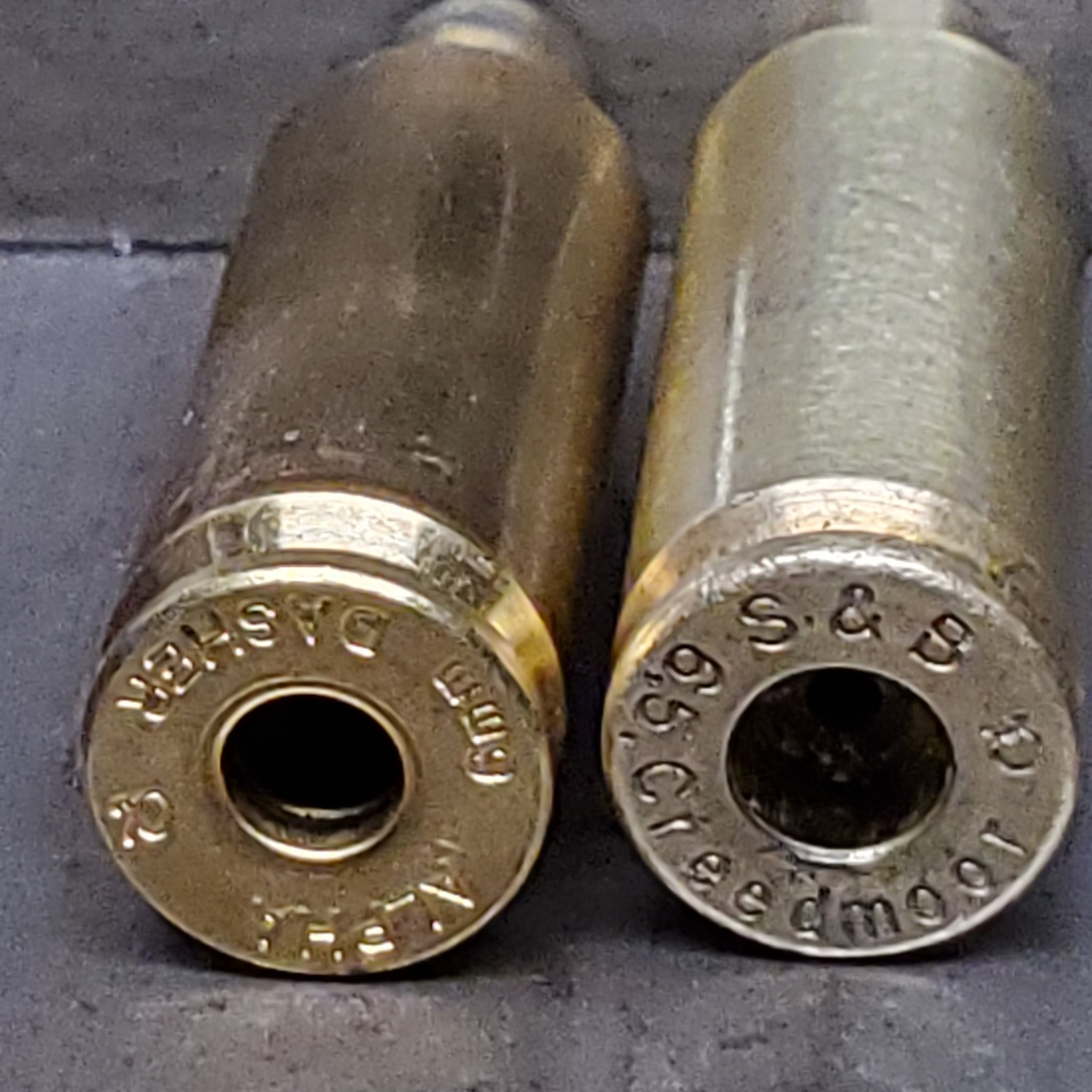

Have you tried Alpha brass yet?
They seem to take much higher pressure than normal.
Yes I use it exclusively in my 6 Dasher.
Alpha 6 Dasher brass can take pressure better.
As an example I run 110 SMK at 3085 fps as a standard LR load, 3020 fps for 115 DTAC, or 58 GR varmint bullets at 4100 fps.
Alpha brass gives me all I need in 6 Dasher for accuracy standard loads and higher pressure loads too.
But you can make 6 Dasher from Hybrid cases, but with LR primers...which is quite a bit of work and not really needed, unless you want maximum effort.
Pic of turning a 6.5 CM into 6 Dasher...you can do the same with hybrid cases, and see if you can reach 3200 fps with 110 SMK.
I convert hybrid cases for other calibers like 8.6 Blackout to get 338 Federal performance out of a 6.5 twist bolt gun.
The 3 twist auto is a bad choice in my book, so I scrapped it... go 6.5 twist in the 8.6 Blackout.
So yes I recommend Alpha brass for those who do not want to deal with hybrid case forming.
