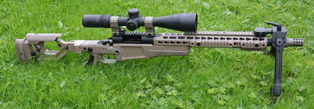

I just recently built a 6mm Creedmore with a 16.5” Criterion barrel on a Mausingfield action, SilencerCo Harvestor suppressor with Magpul Hunterstock. I haven’t shot much past 300 yds but at that range I’m getting 1/2 moa groups on paper and have shot several critters in the 150 yd range with Hornady 108gr Eld match ammo with full penetration on critters in the 30-40 lb range. No regrets! It is perfectly suited to what it was built for a compact super accurate gun, fast and easy to get out the window of the truck for quick shots on fast moving targets. Criterion advised against cutting a longer barrel due to run-out variations etc but spun me up a medium varmint 1-8 twist barrel threaded for not a lot of money. I was getting some static aboutgoing that short. Sorry, I don’t have a picture of the gun but I do have this....
Fucking beast!!!

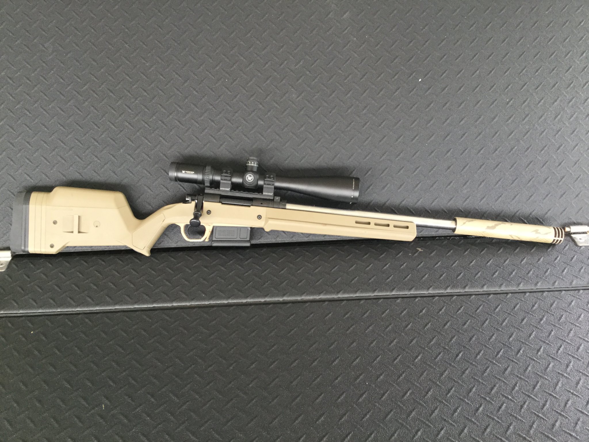

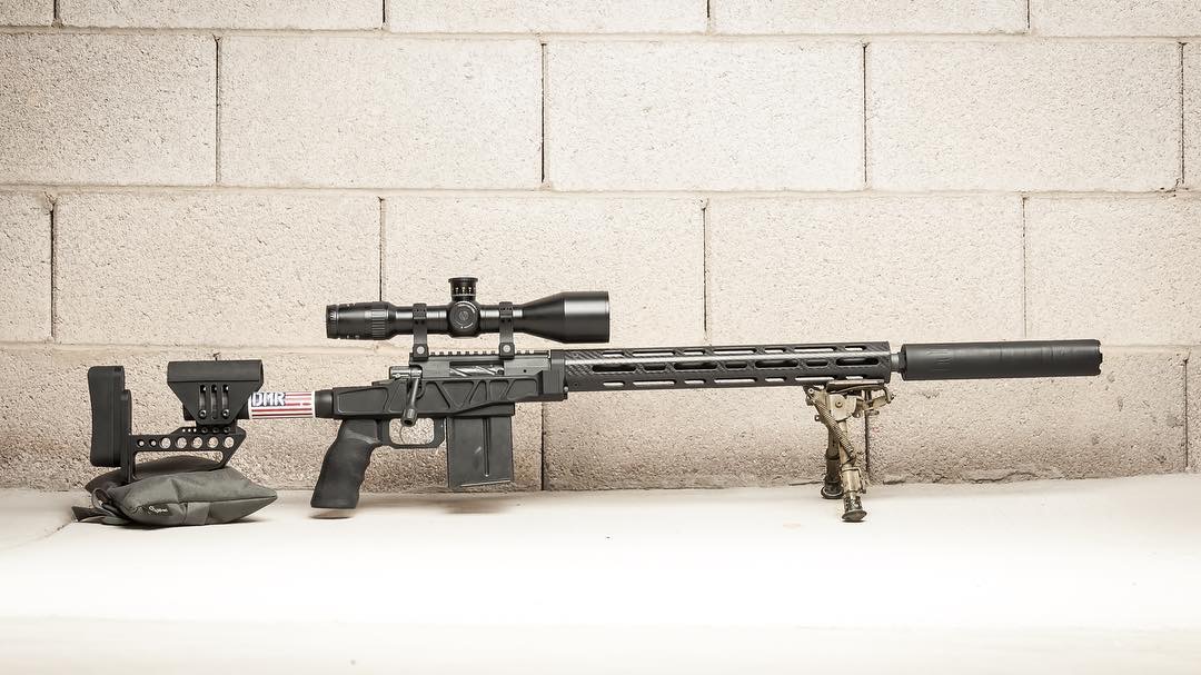

Just put this together: 16.5 inch proof 6.5 creedmoor bighorn prefit from altus shooting solutions
Bighorn tl3
Manners MCS-TA with mini chassis, altus badlands camo
triggertech special
Schmidt and Bender 5-20 ultra short
Badger Ordnance 34mm alloy rings standard 1 inch height
silencerco omega with area 419 attachment
7.8 lbs bare rifle
11.3 lbs with scope suppressor and bipod.
Only 30 rounds through it, all factory stuff and it's shooting pretty good can't wait to start with some load development. Getting 2540 fps with factory hornady 143 eldx's.

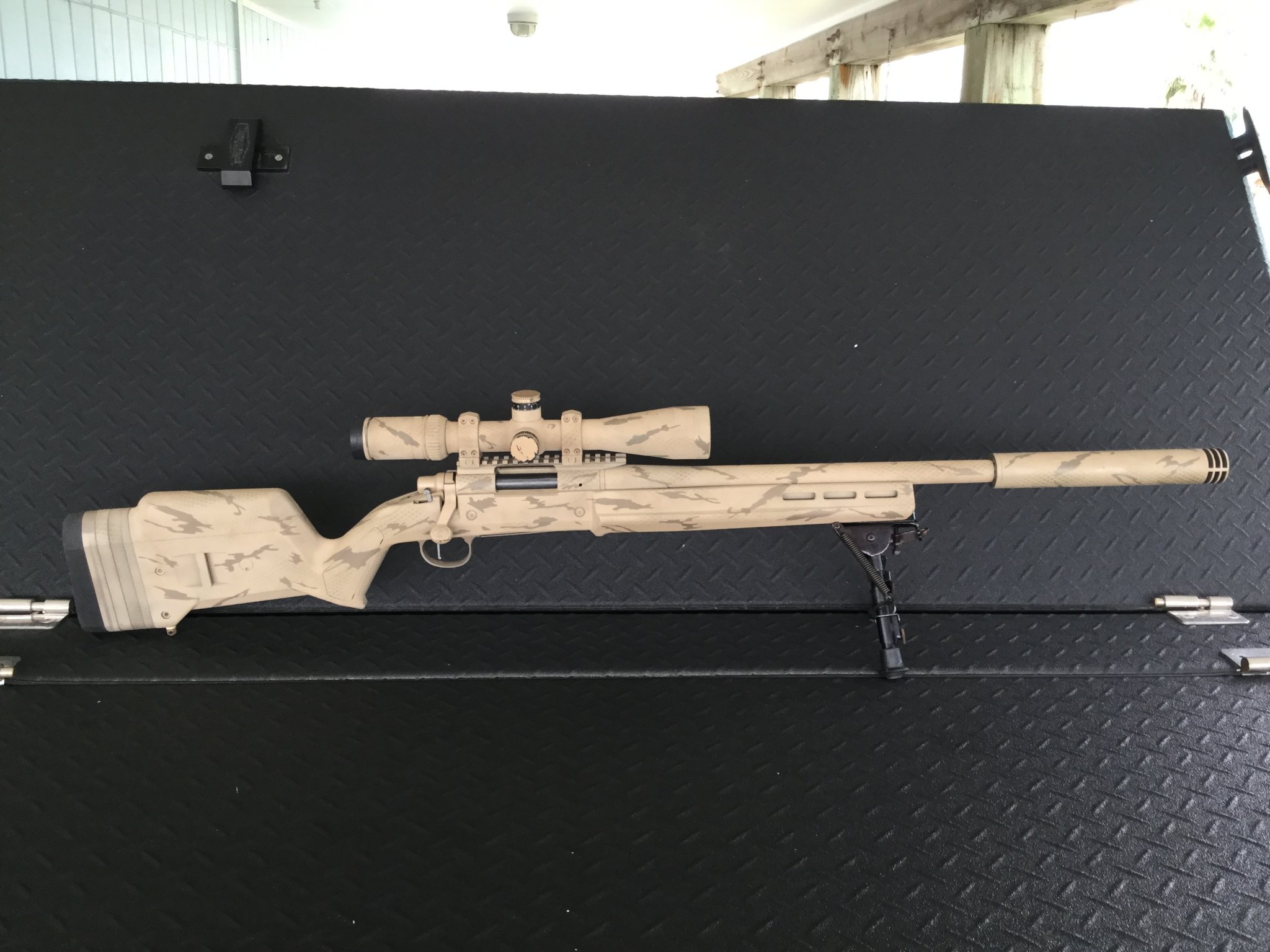

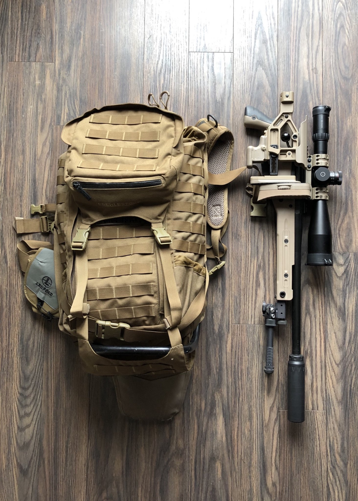

Pics cuz she was a looker.

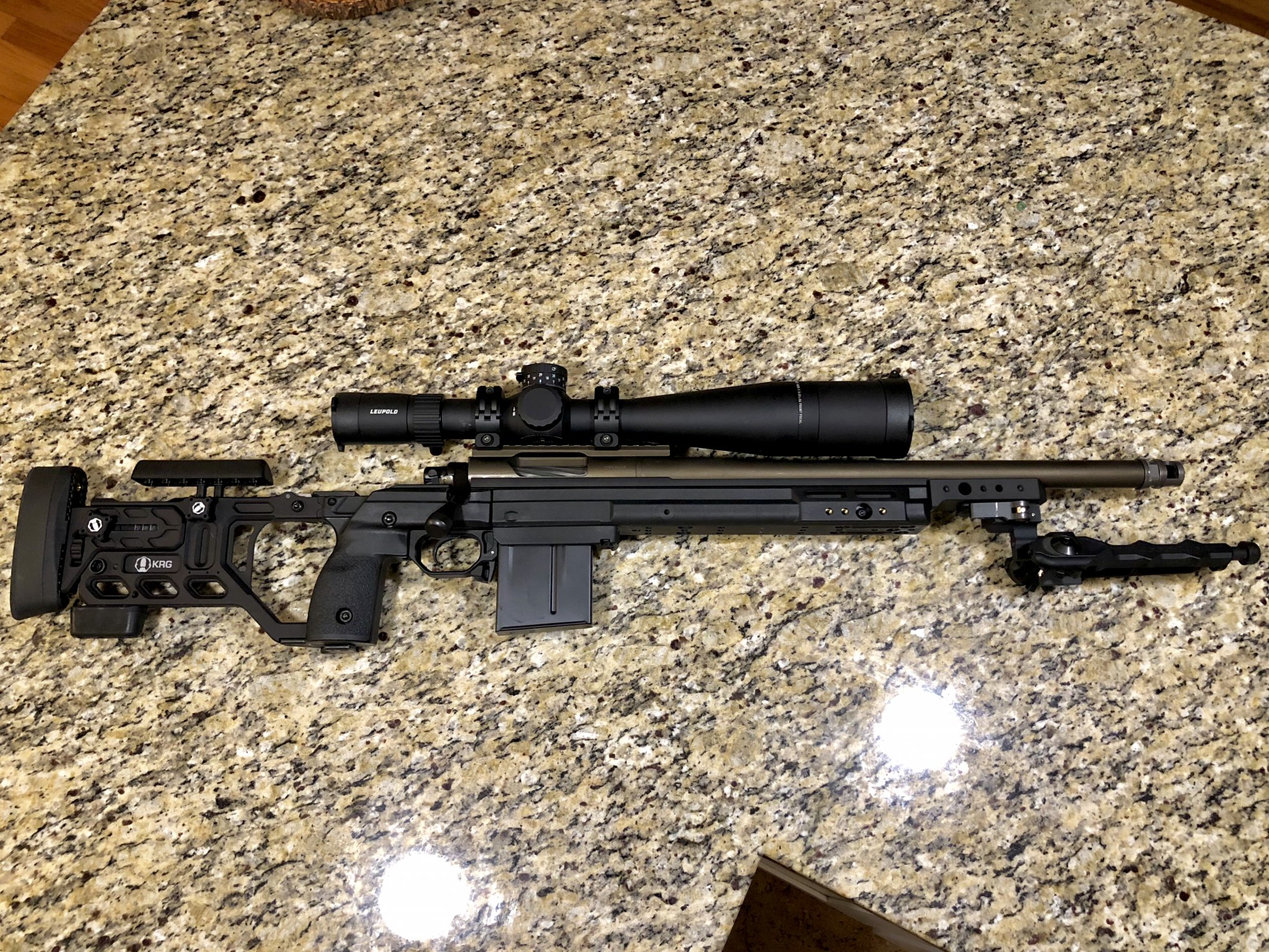

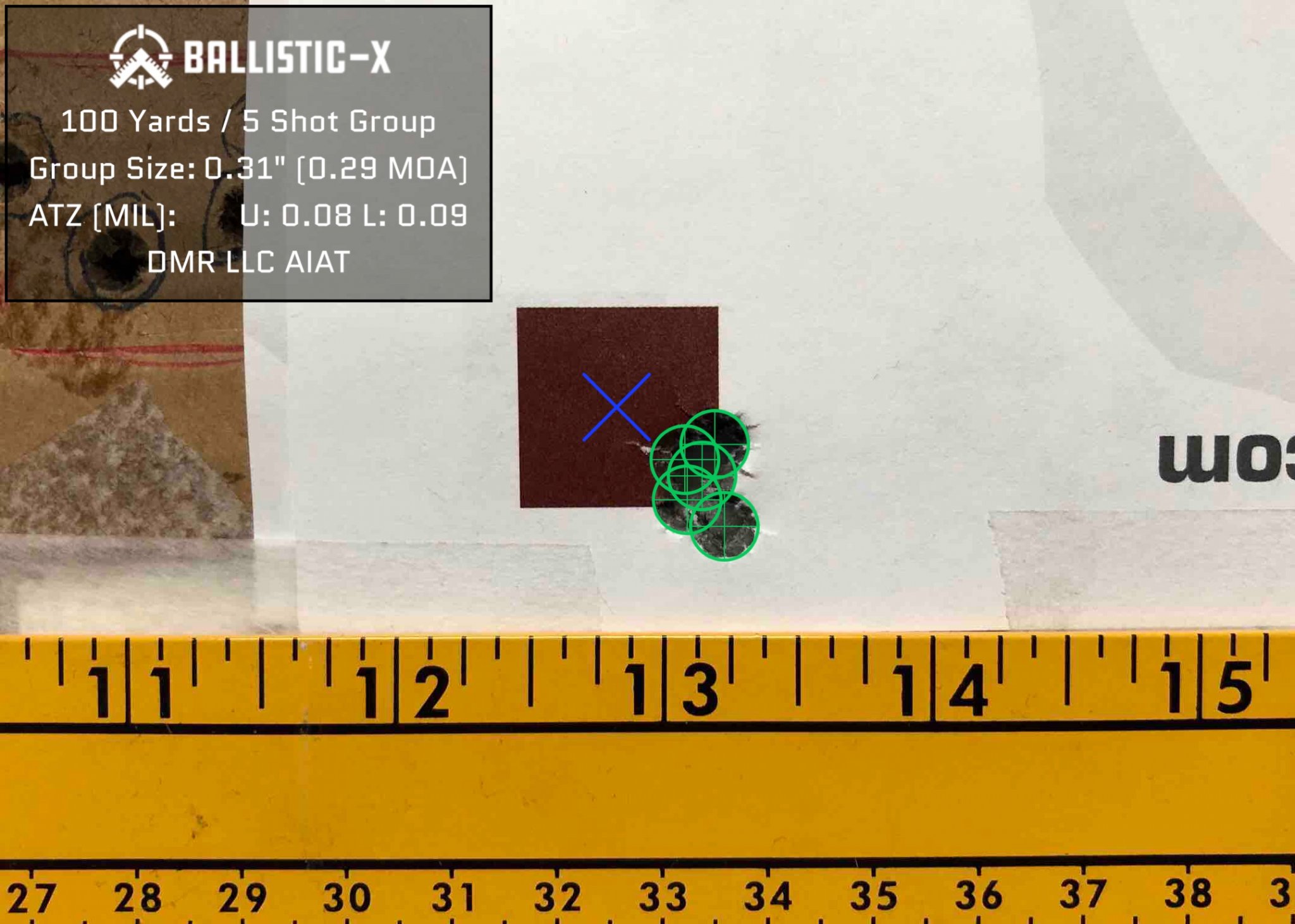

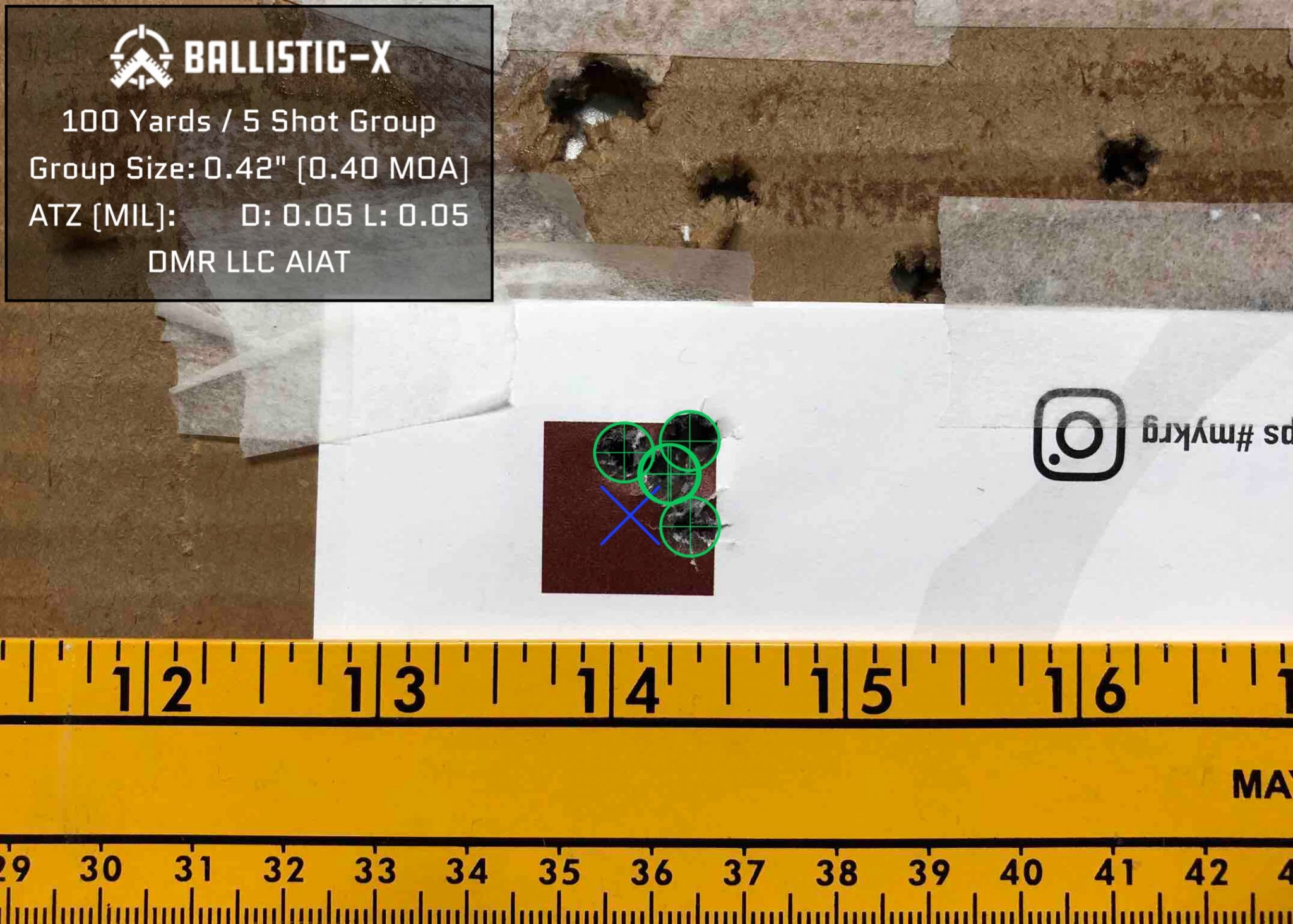

That rifle is an absolute shooter and off to a happy home. I ended us going with an AIAT and 16.5” 6.5 CM barrel. I really like the AI but realize it’s chunky!
I’m still very early into this barrel’s life at 130 rounds but it is getting a long with Factory Federal 130 Berger and hand loaded 140 Berger Hybrids + H4350. I will get more chronograph information once I get at least 200 rounds down the barrel.
