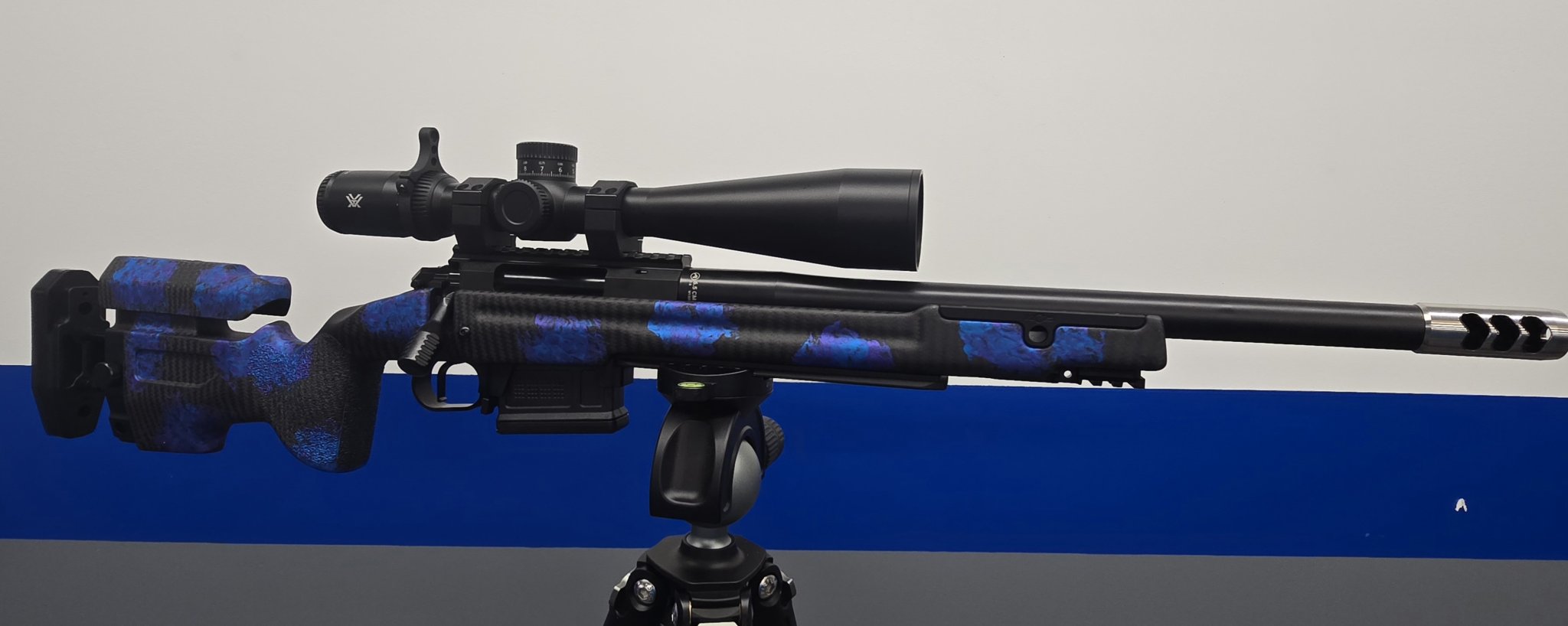

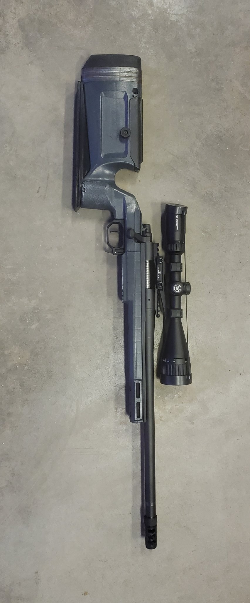

Threw together this budget build as a backup/ loaner rifle for any of my buddies/ family that go out with me.
-factory rem700 .308 sps varmint cut down to 18" and threaded.
- krg bravo from here on the hide
- area419 hellfire from here
- area419 curved scope base (20moa)
- vortex high cantilever mount
- vortex crossfire 2 (4-12x50)
- TT special flat.
built it pretty cheap and just going to run whatever factory ammo works good for it. Will probably thread the bolt handle and throw a knob on it this week.
Painted this one. Here's an updated picture.

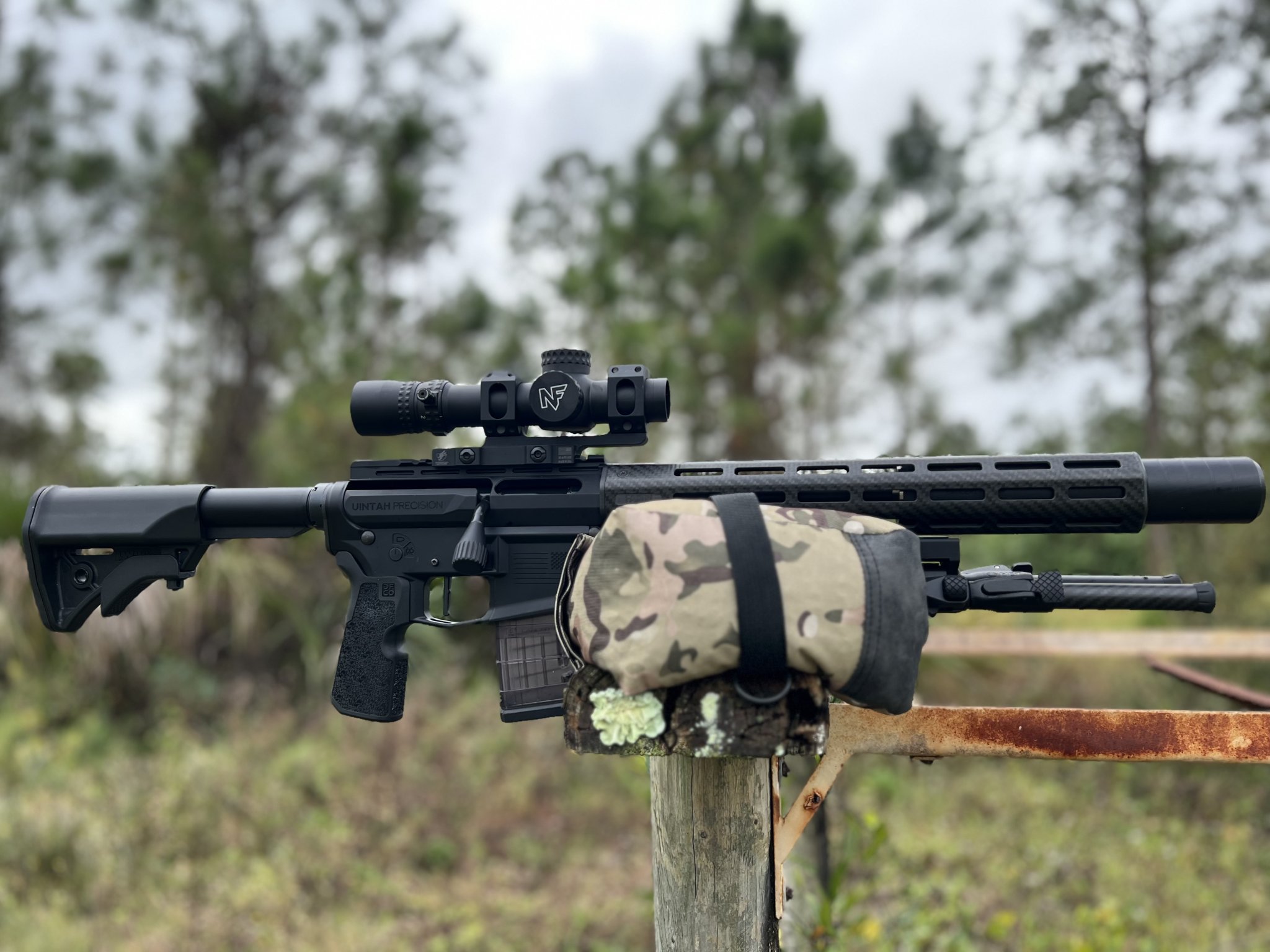

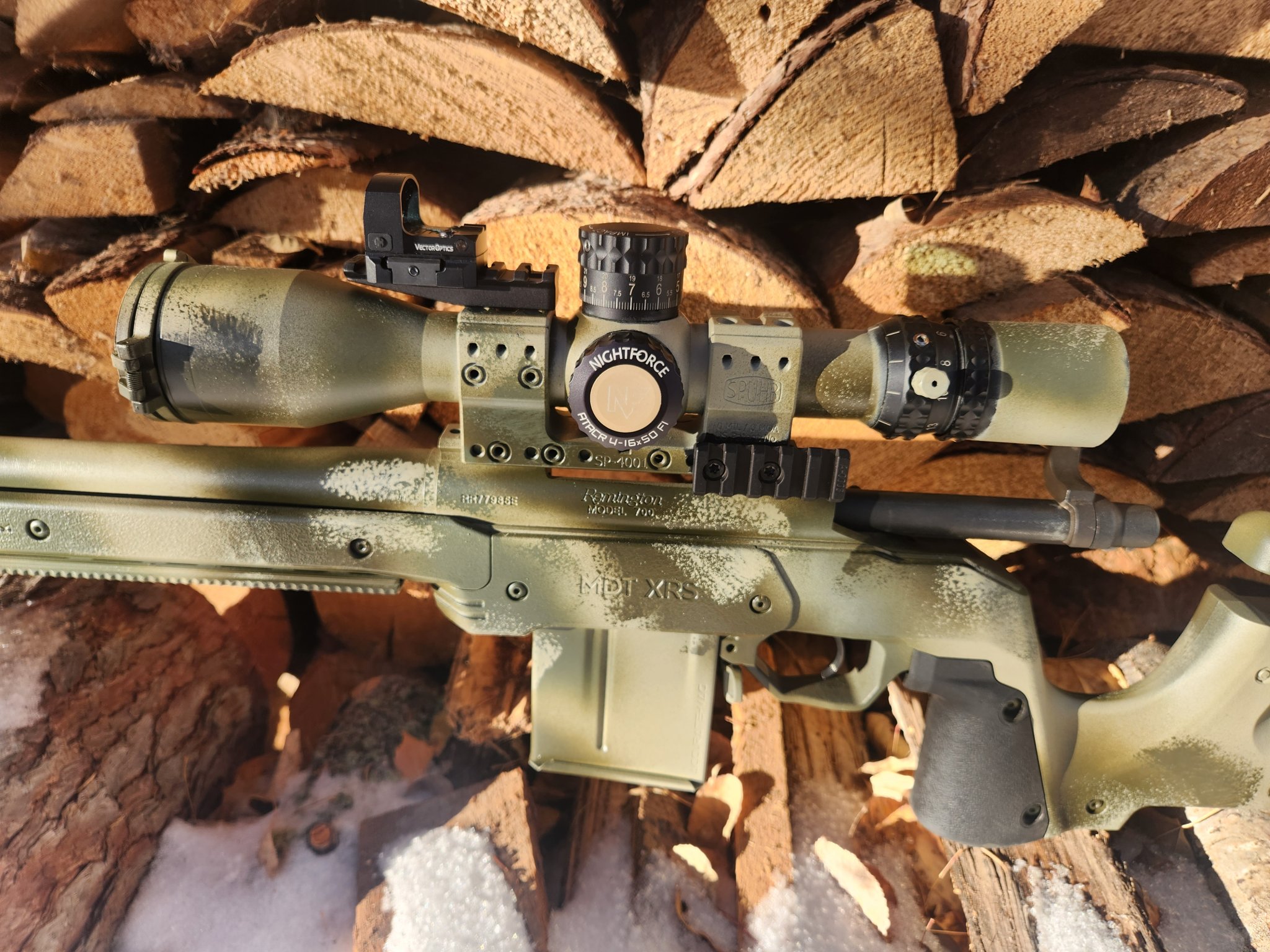

Here's mine. Seekins Havak Hit with an 18" MTU. Swapped the vertical grip out for an Ergo Deluxe, trimmed the cheek rest so I can remove the bolt without folding it, Area419 bolt knob with extension, Crosstac MK109 brake. I'm currently working on designing a full-length fore-end enclosure to 3D print for it. I had some problems getting the barrel done by Straight Jacket initially, had it fixed locally and it's a fuckin' hammer. Best group was 0.24" 10 shot group with factory ammo. Once I can accept funding the ATF I'll get a can for it.

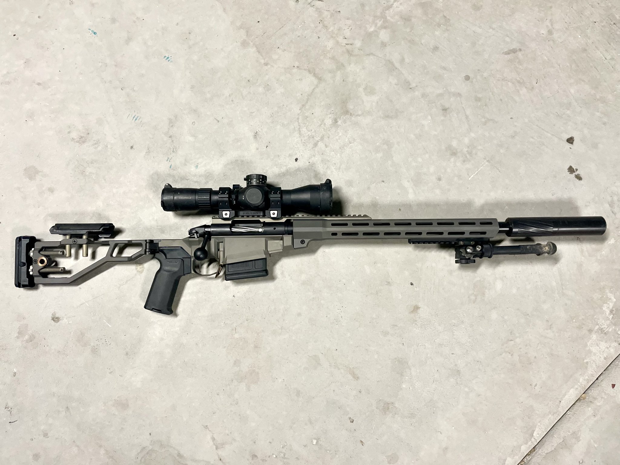

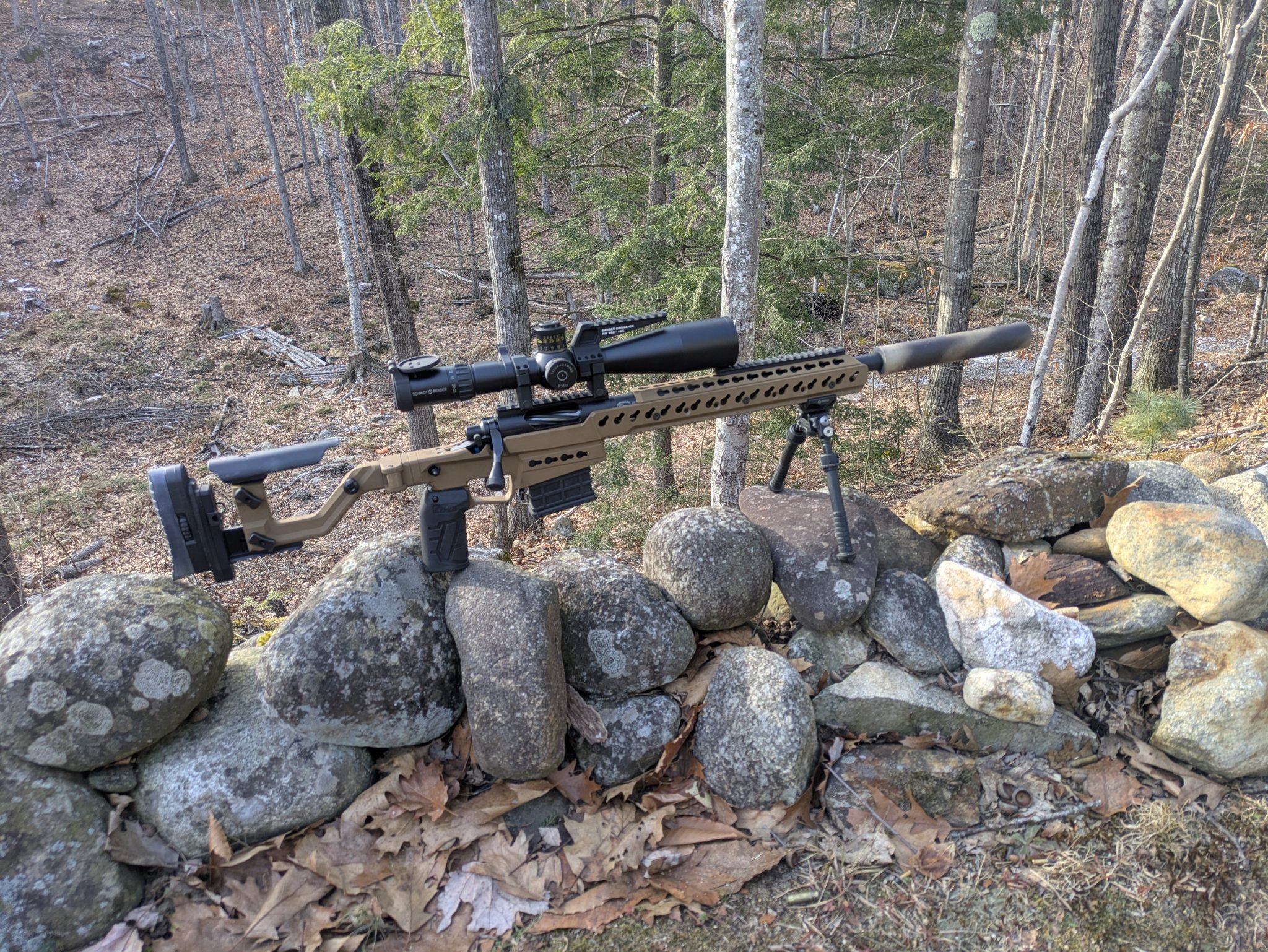

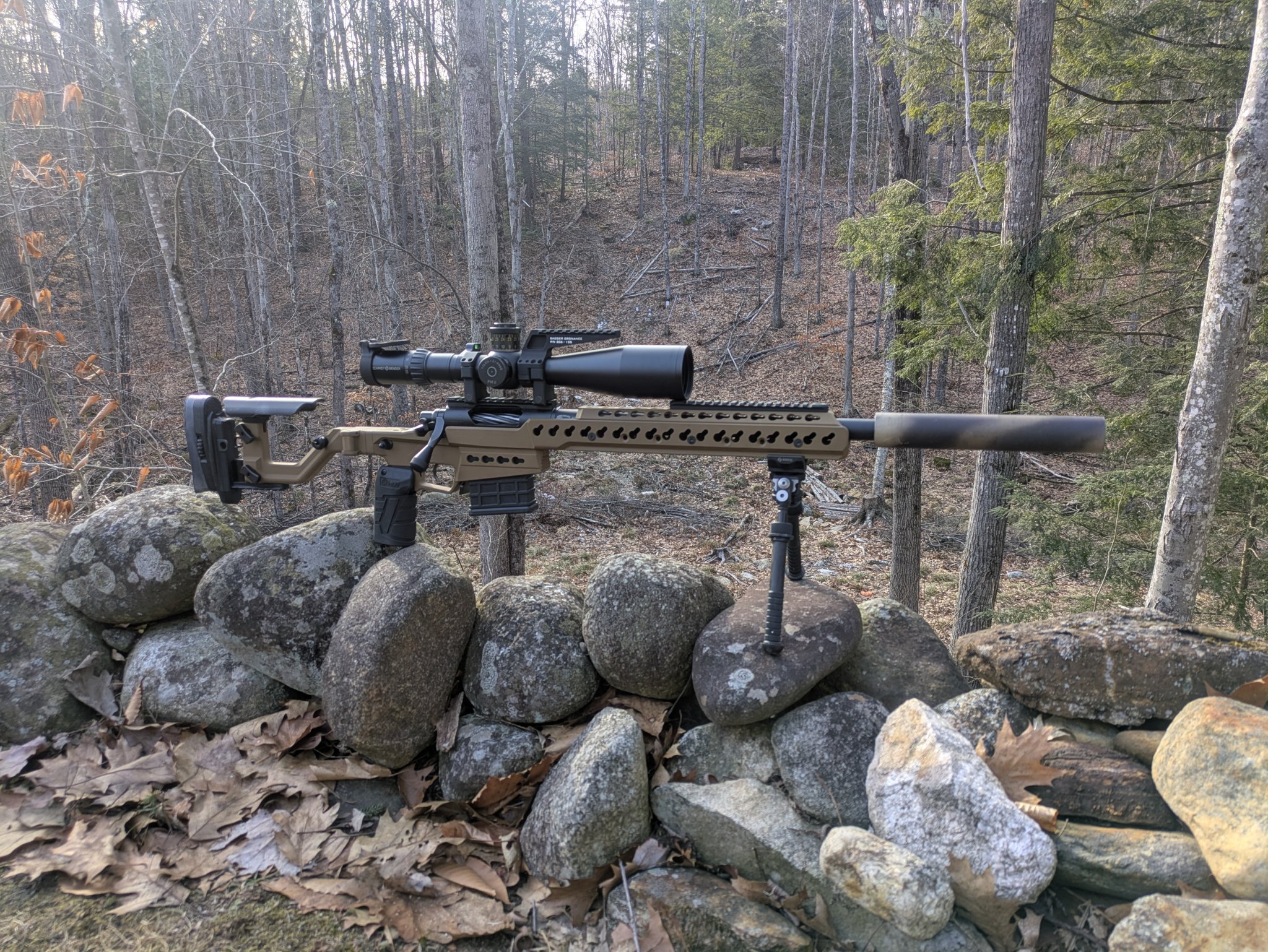

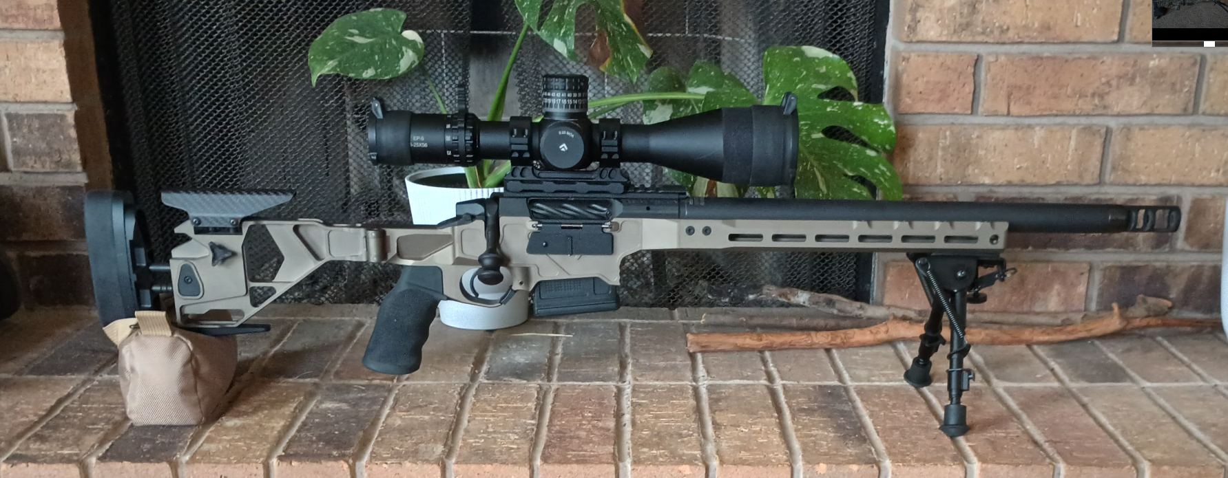

18” 6creed
Bergara action
Q Sidechick chassis (still need to chop a Fix rail to run on top of the fore-end to run clip ons)
Proof steel barrel (once this one is toast, going to a CF barrel)
Leupold mk5 3.6-18 in TierOne medium height mount
Trigger tech diamond
TBAC ultra 7
Atlas
108 eldm handloads just north of 2900fps with some h4350 behind it

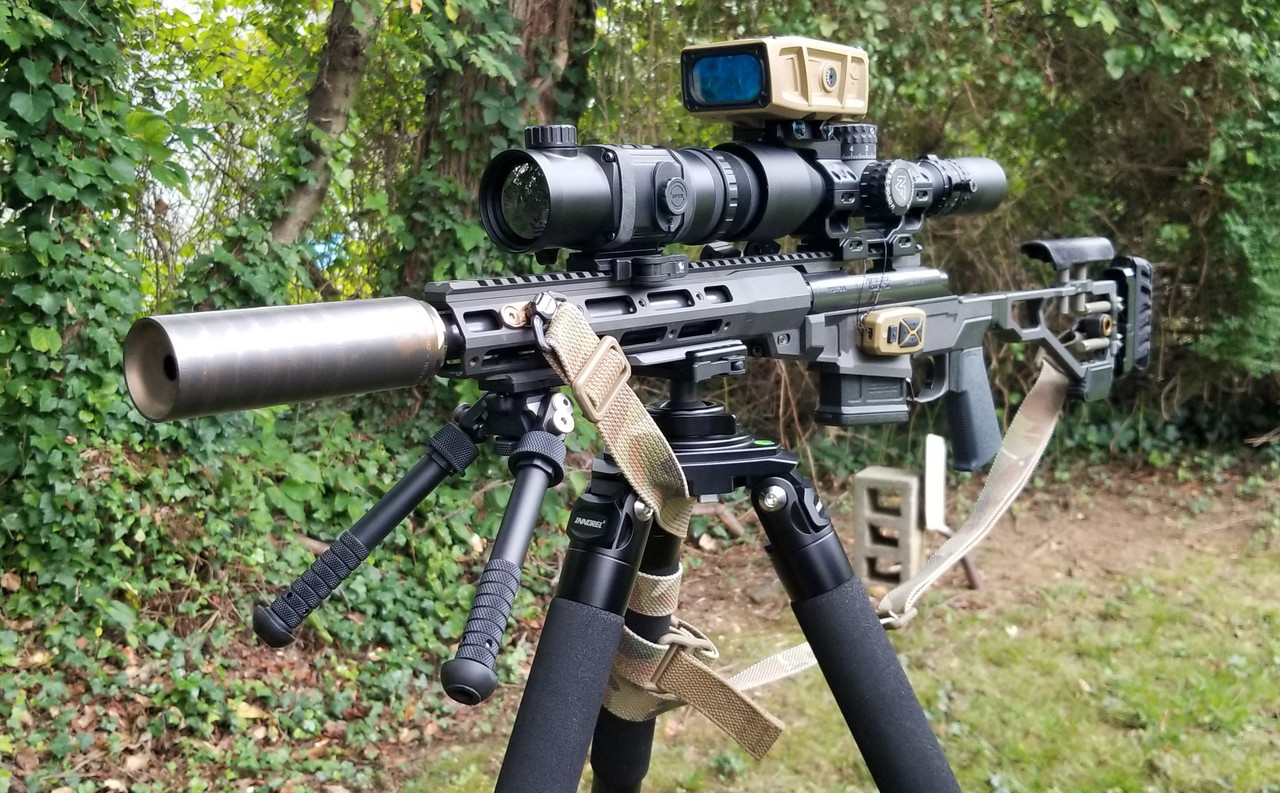

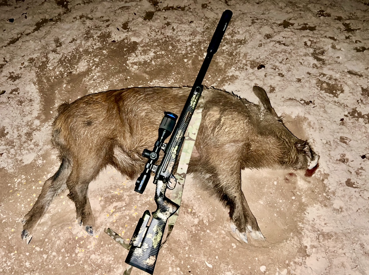

I had an old REM 700 Police that I rebarreled for my thermal rig with an 18” Krieger M24 and put it in a Manners LRH. It is silly accurate and hammers game. One pass of 308 Lapua brass through an expander and ready to roll.
Anything 08 based works great with 16-18” barrel…have also done an 18” 6 Creed and have a 16” 510 Whisper in the works for subs that will likely become my next thermal rig

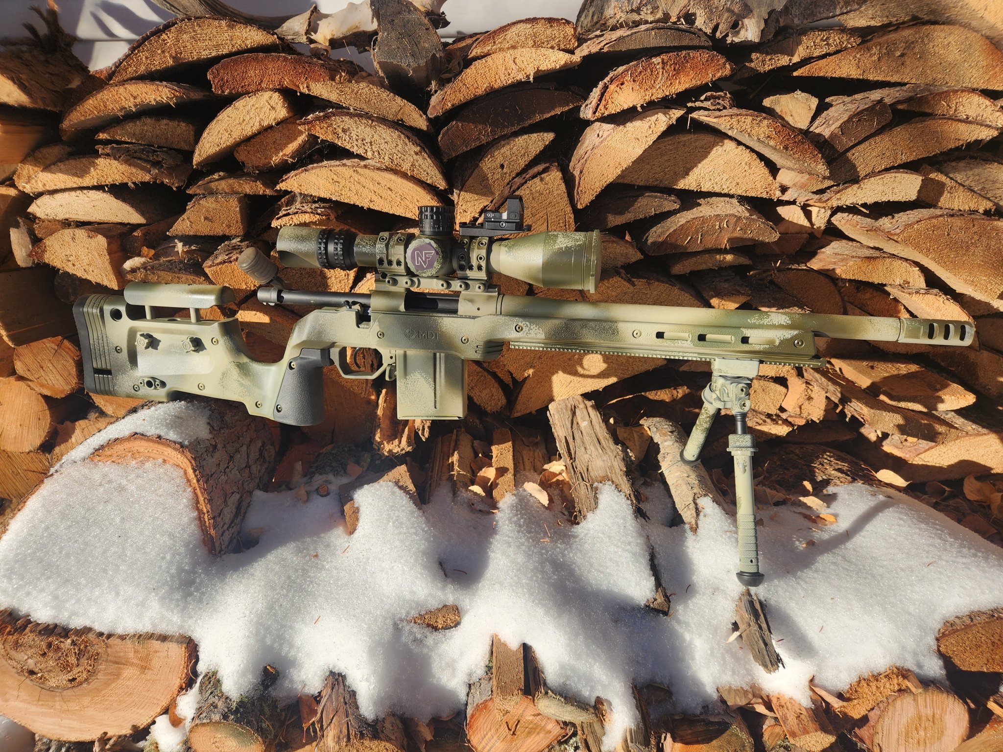

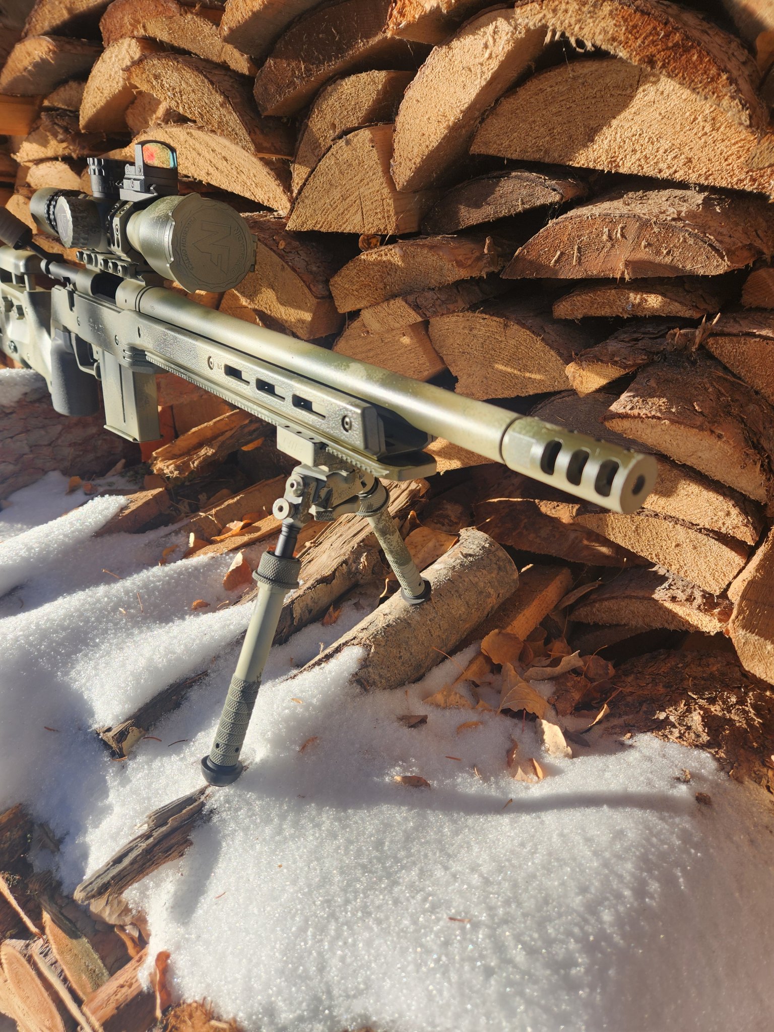

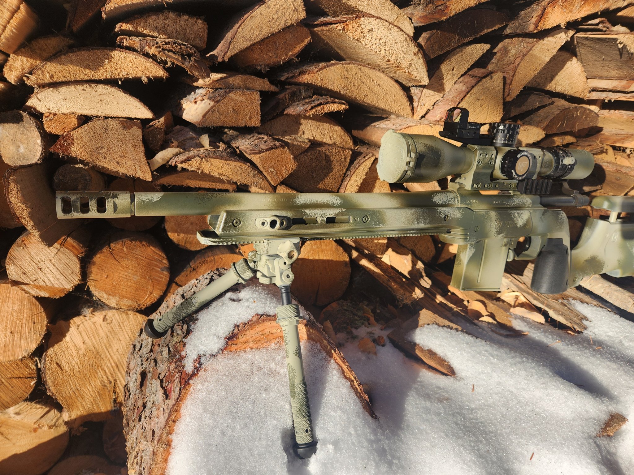

Never seen one with the shorter forend with the full length rail. Sexy AF if you ask me! Might have to cheat on my AIAX and Manners and add one of these to the fold.
406shootist is correct , Q sidechick chassis
the short forend is the one used on the 12.5" barreled fix's and the top rail is actually 2 pieces , long fix top rail chopped and added to the factory sidechick rail
it's a pretty stout chassis and the folder is rock solid , i wish they still made them

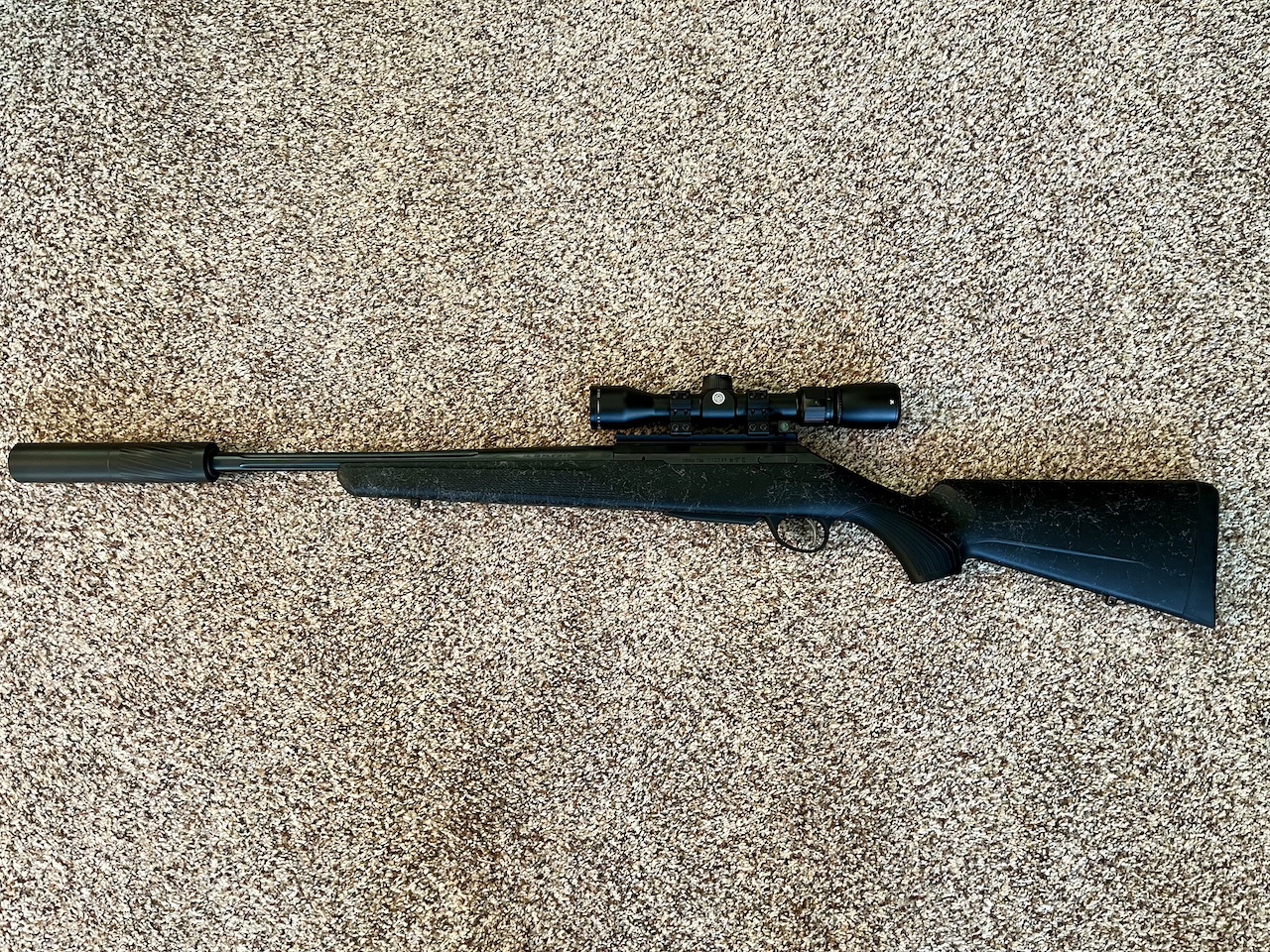

I found a run of the mill Remington 700 in 7-08 that I had cut to 16 inches and threaded for one of my hunting rifles. I wanted light weight and shorter so with the suppressor it's near normal length. Just my preference for the woods I hunt and I spot and stalk more often than not anymore too. My shots are usually less than 300 and most are less than 75. I'm just using factory 139gr Hornady Whitetail ammo with consistent results.
