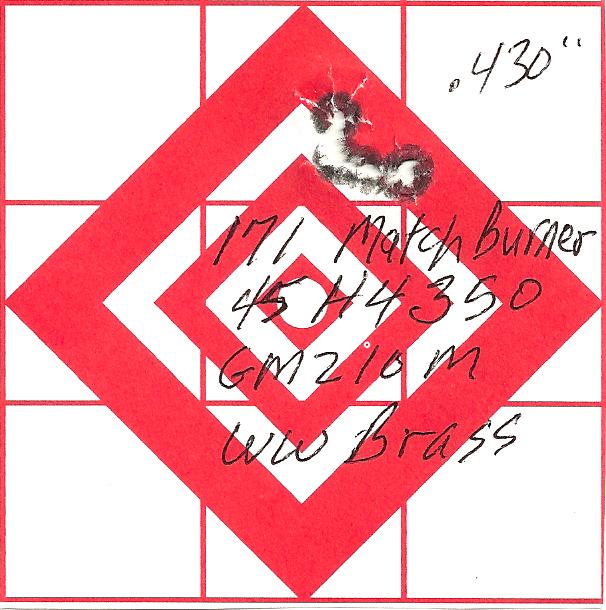

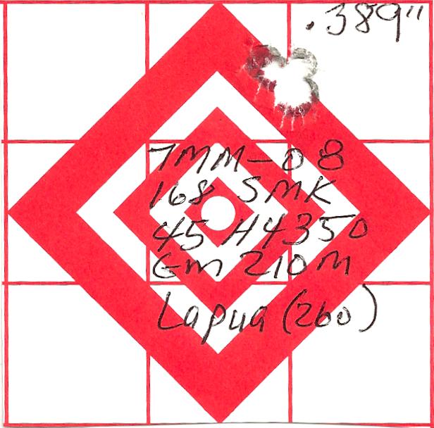

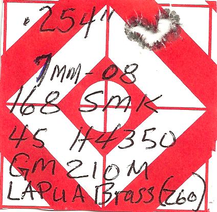

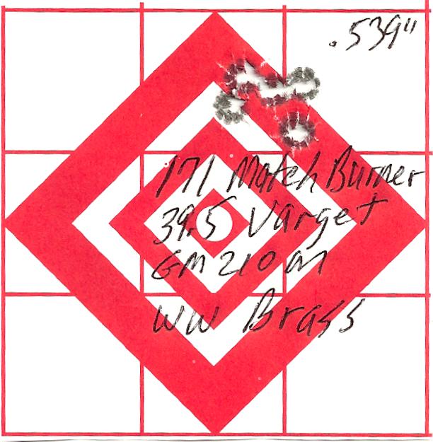

Today was the first chance to get to the range with the 171MB bullets. I have load info, chrono data and real trajectory data; also will have pics of groups fired (even tho only 5 shot groups due to shoulder problem).
I will say up front that I got into this thread by posting disbelief in the Barnes posted BC for this bullet. Will I have to eat crow? Let you know when I get it all assimilated and posted.
171 Match Burner Observations
I wanted to not only see what the 171 MB was capable of but compare to my current load. Lots of chrono data from my Magneto Speed II and pics of groups.
I preface by saying load data is for my rifle only. Most loads are over current published data and I bear no responsibility for their use outside my rifle.
My main load for accuracy and long range is 45 grains H4350 behind the 168SMK, lit by GM210M primers. It is in either WW or, in the case of these numbers, Lapua 260 that has been turned down to .014" thickness.
SMK loads were fired in Lapua brass; Barne's MB were in WW brass.
Chrono data: (24" 1 in 9 Bartlien)
168SMK 45 gr H4350 .005 off lands
Avg 2659 FPS
ES 20
SD 10
171 Match Burner 45 gr H4350 .005 off lands
Avg 2618 FPS
ES 22
SD 8
171 MB 39.5 Varget .005 off lands
AVG 2554
ES 51
SD 19
All groups are five shot at 100 yards from a bipod.
Once accuracy had been established I corrected for true 100 yard zero and moved to my 500 plate. Using JBM, which showed a BC of .645 for the 171MB, I set my turret to 3.2 mils elevation and proceeded to fire three shots. There was a bit of wind but not to effect elevation. The first two rounds on the plate hit dead center within 3/4" from each other and the wind pushed the third up slightly and over by about 1". So, I am eating crow. The posted BC appears to be correct.

That's awesome shoot4fun, who cares if you eat crow when the bullet is awesome.
Did you take any measurements of bearing length and overall length to see how consistent they are?
I did my measurements on what I would call a small sample. The first 100 bullets were all measure base to ogive. 74% were +/- .0005 of a measure with my tools of .625" and weights for the entire 100 were 170.4 to max of 171.2 grains. This is a little better than Sierra SMK, although I don't remember what I came up with when I looked at them a while back. Still, if you look at my groups, the SMK is not a bad bullet in my gun. If I were betting I would say the 162 Amax is still the best bullet for long range 7MM-08 loads when pushed at 2800 FPS. But they are unobtainium and so I will shoot the SMK.
