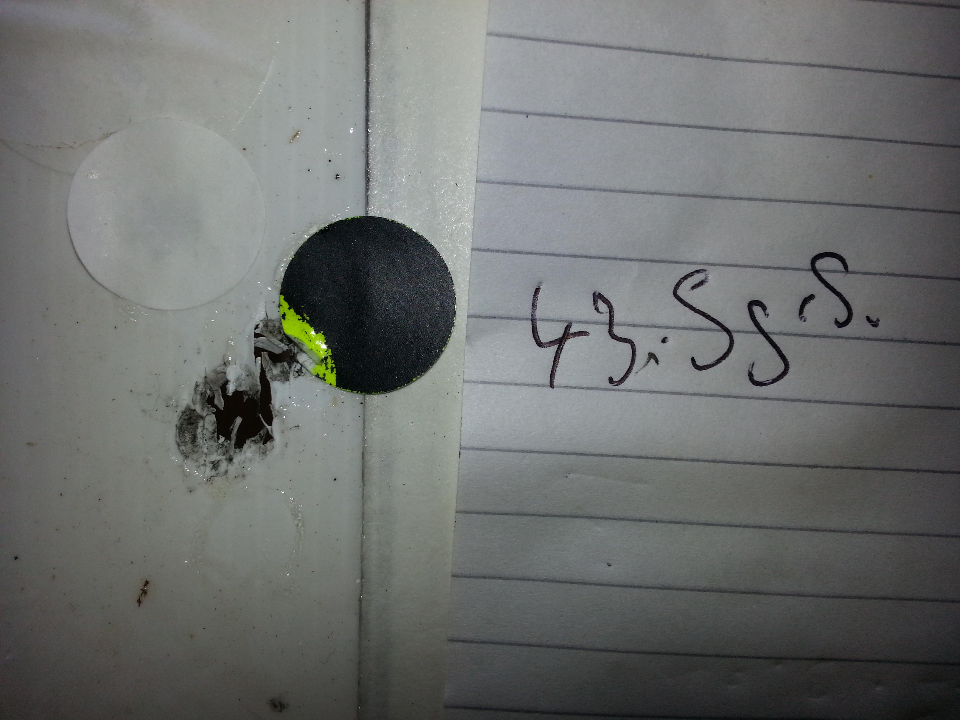

Not sure if this will come up because I believe it is in the archives but will try. This is the final results of my testing and load development for the Lapua 175 Scenar L. 1000 yds, 4 shot group approximately 2 7/8" group. 6 fired total, two to get on target and 4 for effect. 10" target.
AZ2000
You probably may notice the posting is by MJM1 Not AZ2000. A few years ago if you were on the board, the Hide was sold and many of us were not able to log back on and had to re-register, at that time I simply changed it to AZ2001 which some how disappeared. So in order to post my final results I had to re-register again. The gun went through some modifications as I moved forward to get my accuracy, adding a 24" Shilen Heavy barrel, stainless with a 1-10 twist and a Sharp Shooters Supply laminated wood stock. These were shot off of a portable bench with a Harris bipod and a leather stock support bag. Final load was with 42 grains of Varget using Nosler brass and Wolf primers, coming out at 2640 fps and of course the Lapua 175 scenar L.
