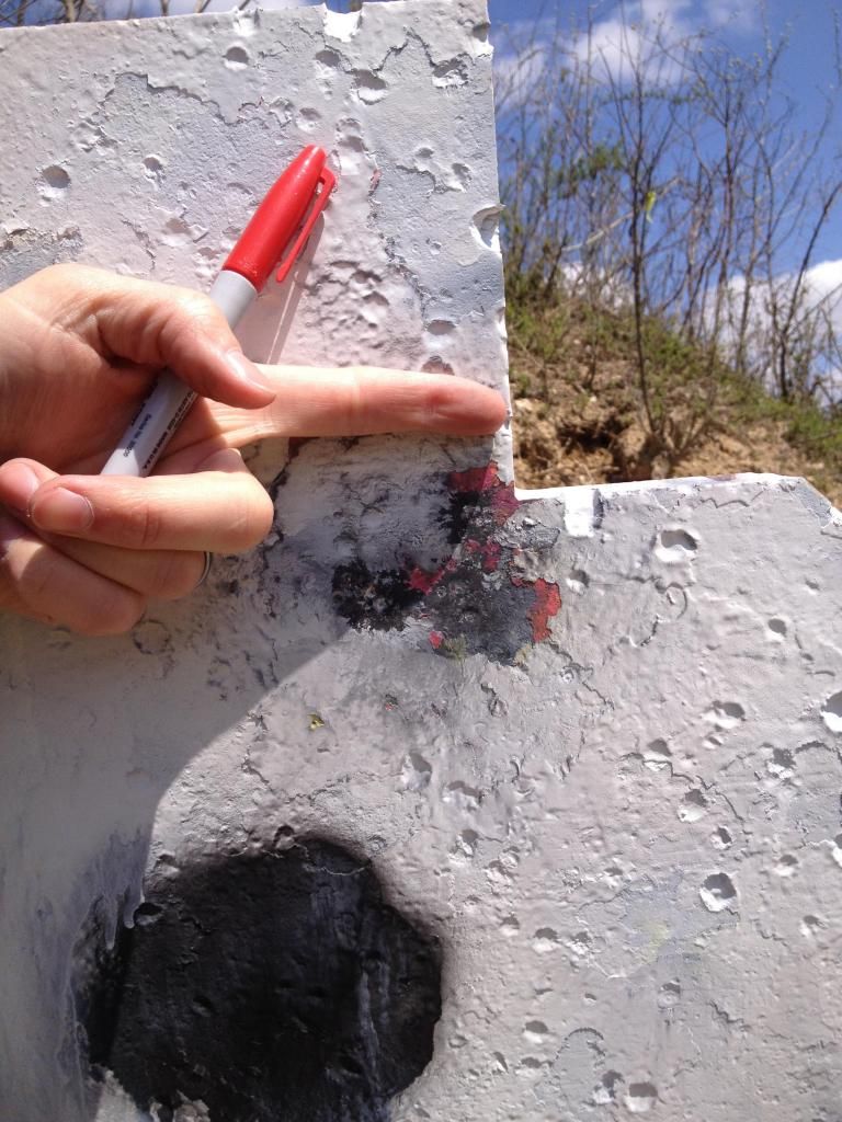

Have been playing with the 180gr Interbond (identical bullet) in my 300WM to try and find a hunting load to the ranges you are looking at. Was able to pull these off just the other day. They shoot really nicely out of my 300WM which is a Factory Sendero with 26" barrel and 10twist on Manners T5A stock with Holland Radial Brake. Used 72.1gr IMR4831 and seated .005" off the lands.
500 yards - 50deg and a 5 -10 mph 30 deg wind.
Close up for sizing
That was 4 shots and I will admit I pull one that went over the shoulder.
600 yards
That was 4 shots total and I'll admit that the one at the bottom of the circle was me.
