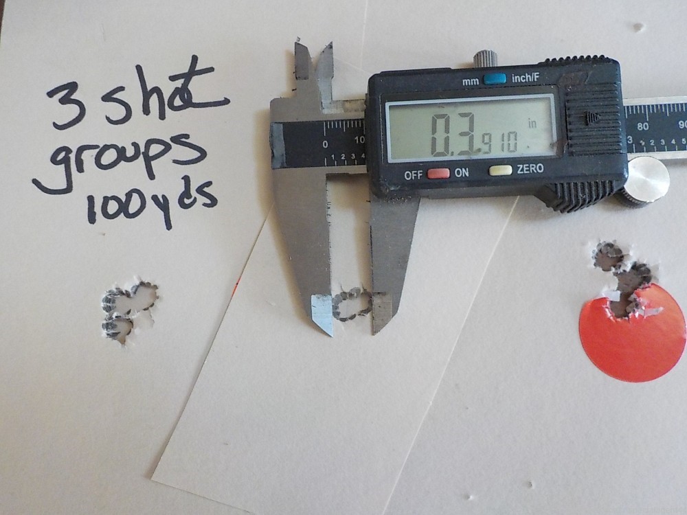

185 Juggs and Varget shoots approx 1 MOA out of my AR10. 2480 fps 18” 1:10
I don’t have any factory FGMM data from it but here’s some from a 24” 1:10 bolt gun.
37F 37% 30.20in
Federal Factory Gold Medal Berger 185 gr Juggs
Fed 210M
BTO 2.130
COL 2.010
COAL 2.802
Magneto V3
2599, 2625, 2635, 2603, 2615,
2621, 2625, 2609, 2620, 2609 SD 11.1
