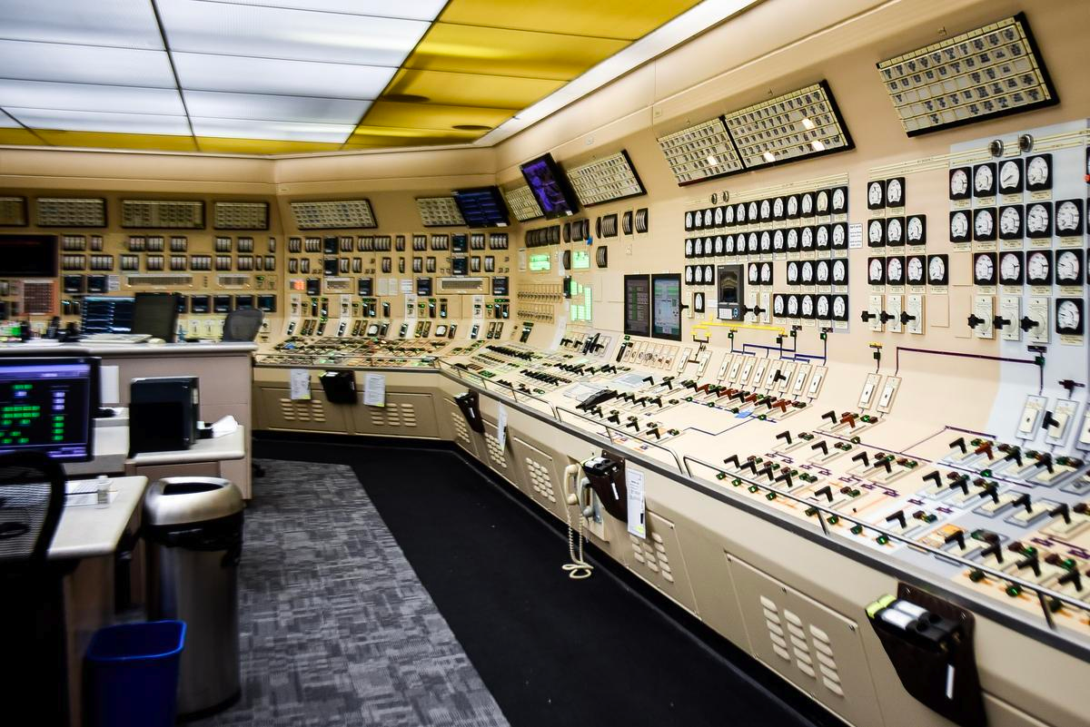

A manual safety is not nuclear engineering
IDK when I see them I remember this
