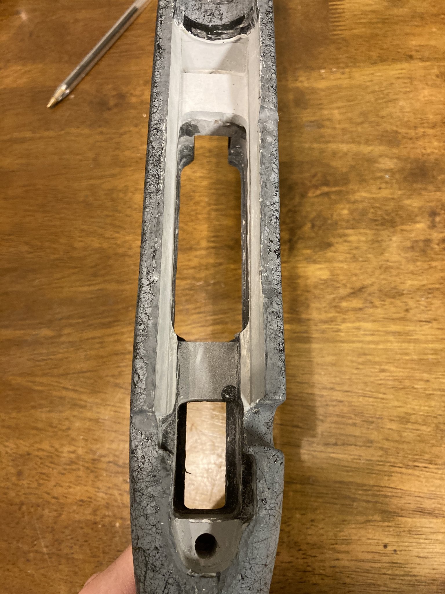

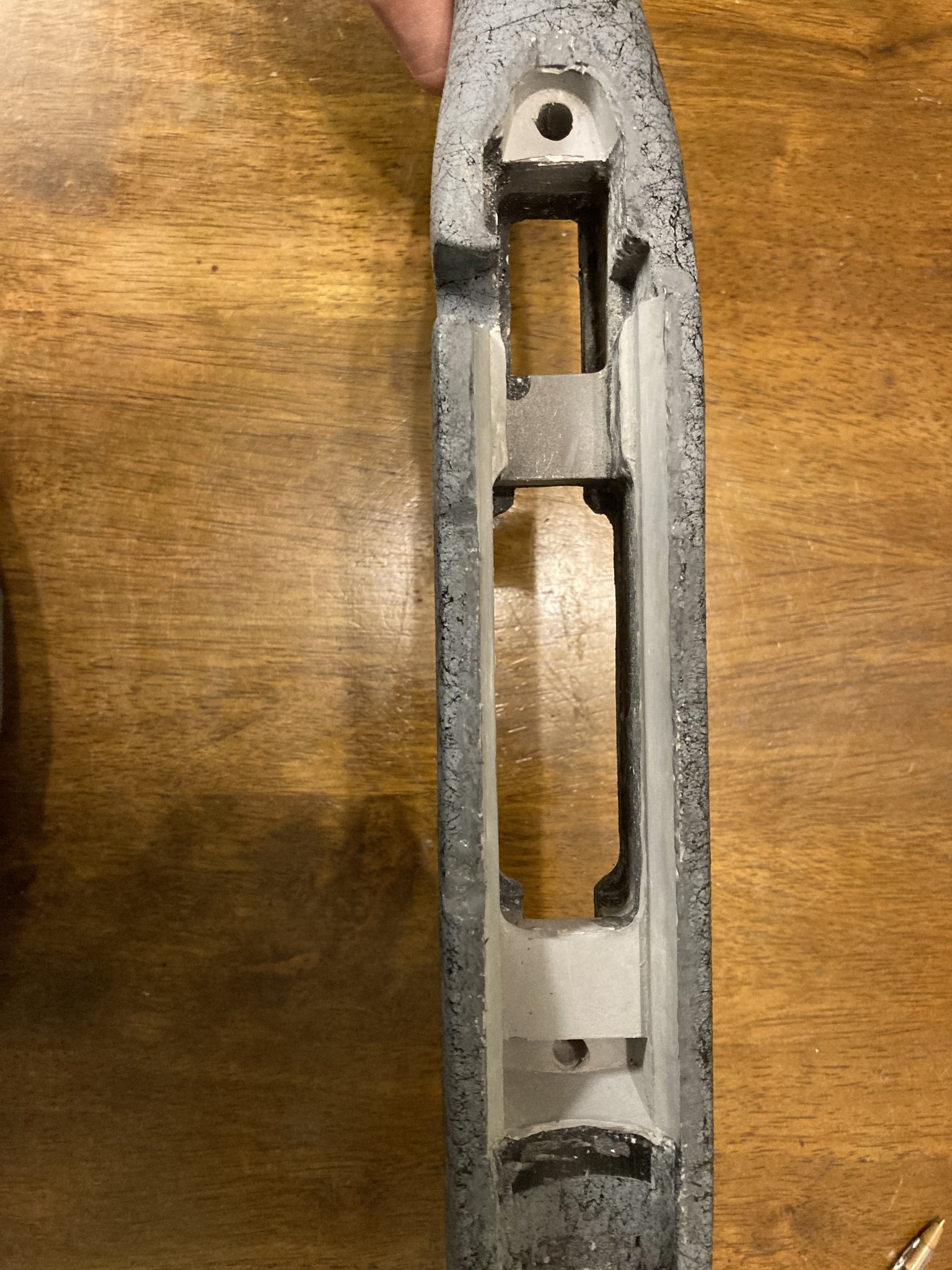

Hey yall, just got done with first time bedding a rifle and was wondering whether it looks alright or not, ill let yall decide. I was nervous it was gonna turn out bad...
Btw, how long do yall wait till yall put it back together and shoot it? I was thinking atleast a week.

looks pretty good man.
just follow the directions on the epoxy you used in regards to wait time for full cure....usually 24-72 hrs.
Reactions: Ethan87
I’ve done 2 bedding jobs now. They don’t look as clean as LRI or anybody that cleans it up with a mill. But it’s shoots great. As long as everything still functions properly don’t compare it to the super clean looking ones because it can be hard to mimic perfectly from home.
Well in that case im good, its done been 2 days and i used marine tex, so ill probably put it back together tommorow maybe
Marine Tex is gtg.
Thats what gets me lol. I want it to look clean but thats hard to get at home with less then ideal stuff. Long as it works good i guess...
