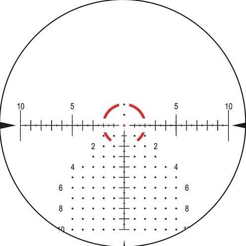

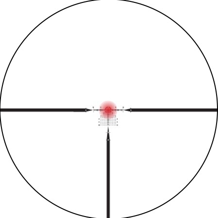

Ultimately, if NF put the FC-DMx reticle into the 2.5-20 NX8, that would be fantastic. It would be very usable across the entire range. Not quite as precise at the top end as the Mil-XT, but much more usable for most purposes.
This would be it at ~2.5x and at 16x:
2.5x:
16x:
Agreed.
That would be a nice option for those insisting on an NX8.

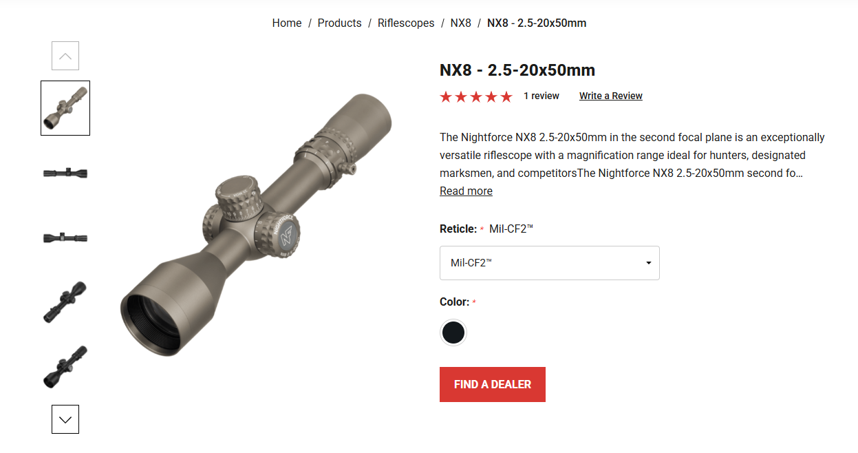

It's (mostly) your lucky day. The SFP version is in the 2.5-20, but only with one subtention value marked in the reticle.
Reactions: diggler1833
Well F-me running. I guess I got a little trigger happy on buying my 4-32 (was on EV, and ever saw the 2.5-20 listed with this option). Guess I should have done the obvious and checked the manufacturer website too. I don't think I'd change my mind...but I'd have bought this ^ to go on a 6.5 Grendel for the kids to hunt with.
Regardless, EV pricing would have me going with whatever is available.
Much appreciated.

How’s the illumination ?
I have those shoot n see targets and with my old eyes I can’t see the black reticle against the black or red target. Daylight bright illumination would help me a lot from 100 yards on out. Any scope suggestions on a daylight bright reticle FFP with at least 12X on the top end ( if the NX8 doesn’t meet those parameters ) ?
Thanks
Thanks
I dunno, I never use illum.
