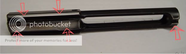

Now I'll attack the bolt carrier, some of these are so rough (esp. the sliding rail surfaces) they look like a wood rasp.
Use a fine stone and 320 emory paper to smooth up the surfaces shown in the pics below.
Buff them all to a mirror finish when done.
Also slick up the face of the hammer (remove it from the lower receiver) where it slides against the bottom of the Bolt Carrier.

I just completed doing these little mods to my bolt and BCG, I didn't do the ejector or the bolt face as I don't have a way to remove the ejector at the moment, and I couldn't find any lapping compound locally so I didn't do that, but it only took me maybe 15 minutes to do everything else.
It does look better and while I can't tell any difference at the moment, the moment of truth will be when and after I hit the range, see if there are any brass shavings inside the bolt afterwards.

The bolt face work in my other thread is the most important thing to reduce shaving problems.
Esp. the small chamfer on the extractor cut (Biggest brass eater) and the ejector pin hole.
OregonShooter....
Brass shaving is not the only (or even the main) reason to do these mods. Consistency in bolt lockup makes for a smoother operation cycle and therefore more consistent accuracy.....
And, NO, LMT (or any manufacturer) does not do these mods to their stuff. A higher quality part MAY have LESS roughness, but it is still a manufactured part.
The brass hardness and smoothness, and pressure of the round will all contribute to brass shaving, also.
