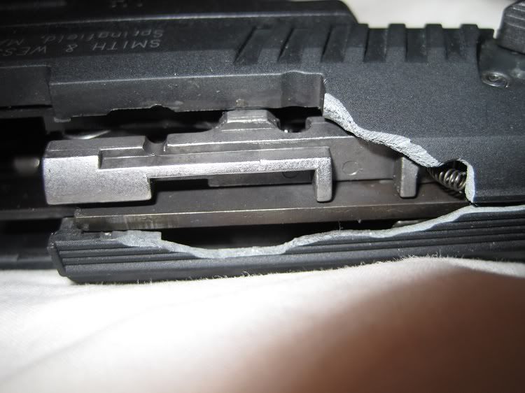

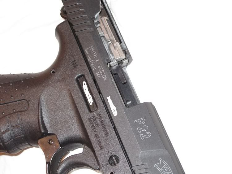

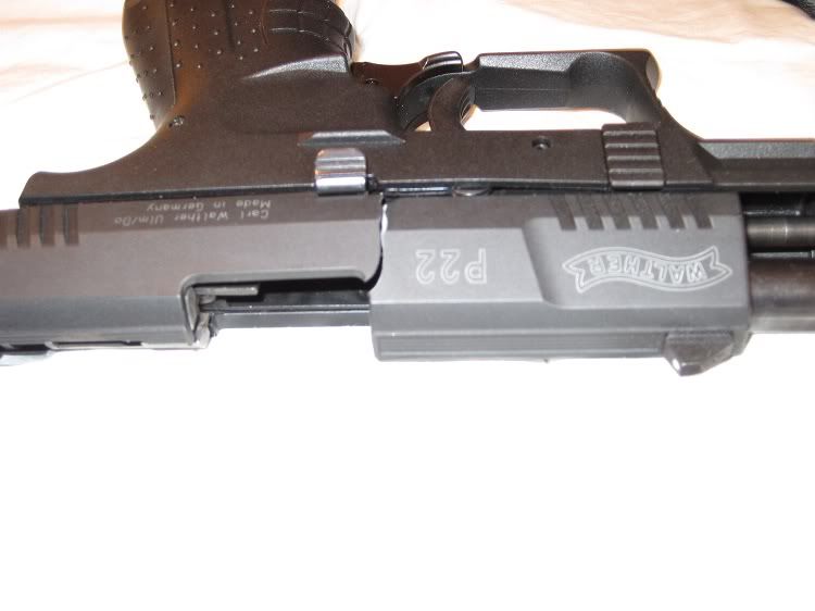

First pistol:

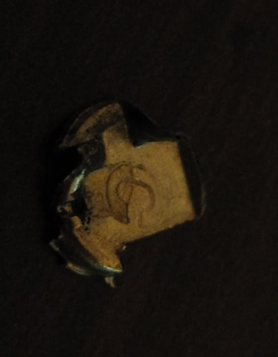

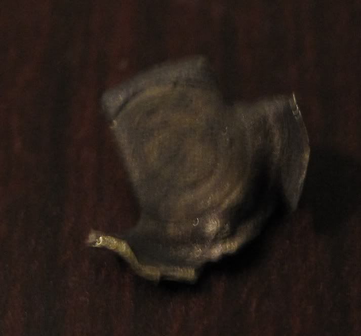

Walther P22, part of the slide was blown into pieces (I don't know how many since I couldn't recover a big chunk). I had shot about 100 Federal Auto Match ammo and had just started shooting my first magazine of CCI Mini Mags. Maybe the 4th round or so I get the end result pictured below. I felt some small pieces hit my eye protection (I'm so glad I was wearing it) and I don't know where the rest went. I thought it was because the slide is made out of pot metal. I did find the base of the cartridge, which I thought was odd and had never seen before. The pistol was sent to S&W for repair, still waiting to hear back from them.

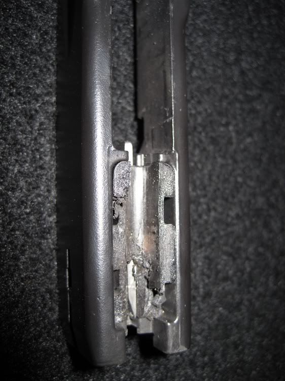

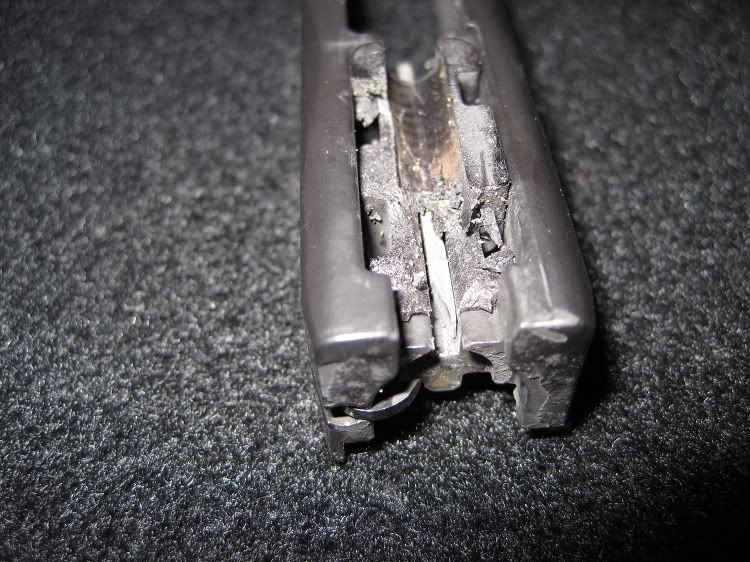

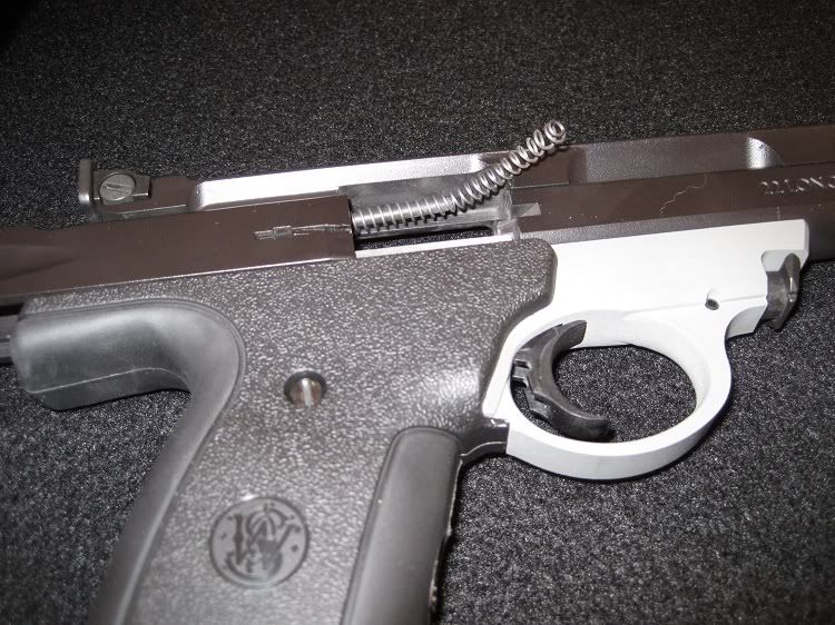

Second Pistol:
Brand new S&W 22a that I bought YESTERDAY. Of course I don't want to use lead ammo in my brand new shiny gun so I decide to use CCI Mini Mags (brand new box). Maybe the 50th round and the gun explodes. End result pictured below. Again, I recovered the base of the cartridge pictured below. This time no obvious parts flying off but the inside looks pretty bad.

Shit... glad your OK. Were you possibly shooting rapid fire and one projectile was lodged in the barrel the your tried to fire another and BAM? Maybe you just got the worst luck...

Did you give the 22A a good detail cleaning and lubing before shooting it? S&W has a habit of leaving lots of machining crap in their guns. If the slide/bolt wasn't going fully into battery it could certainly cause the problem you experienced. As to the Walther...they're not the most durable of pistols (and I'm being kind), and if it fired out of battery, it could disintegrate quite easily.

I'm leaning towards ammo too. The more I think of it, it doesn't make sense how the base of the shell just blew off like that. If it was a problem with the gun, wouldn't the shell stay in one piece as it should?

I think "firemarshall27" just had this happen to his p22 in the last few weeks....he had pics up.
Here is a quote from him<span style="font-weight: bold">...."So far Walther is sending a Fedex return label for me to send the pistol back. I guess its A pretty common problem for the P22 he said "its maid out of a light alloy meterial AKA(aluminium)that will crack and we will just prob put a new slide on it check it over and send it back" simple enough I just hope it goes smooth."</span>

I purchased a Walther P22 after their introduction because I liked the ergonomics and size. I attempted to fire several hundred rounds of ammo and returned the pistol to Smith and Wesson (Walther's US trading partner and customer service center) four times to correct problems with the gun.
Smith and Wesson eventually sent me a check for the full retail price and North Carolina pistol purchase cost. I explained that I liked everything about the pistol but I wanted it to work.
Apparently the pistols are built by Umarex (an airsoft company) in Germany, licensing the parent Walther company name and banner. They are built of pot metal (zinc?) castings and are not meant to be shot a lot.
