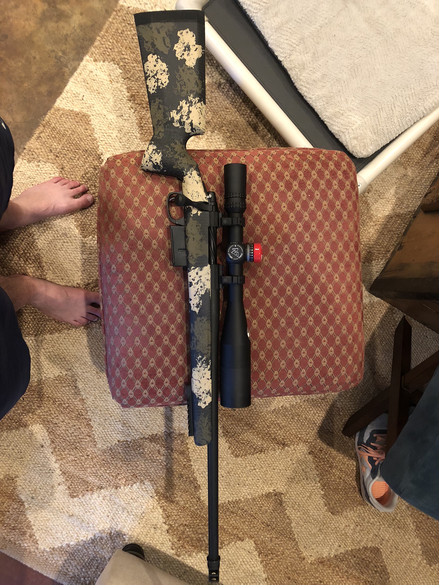

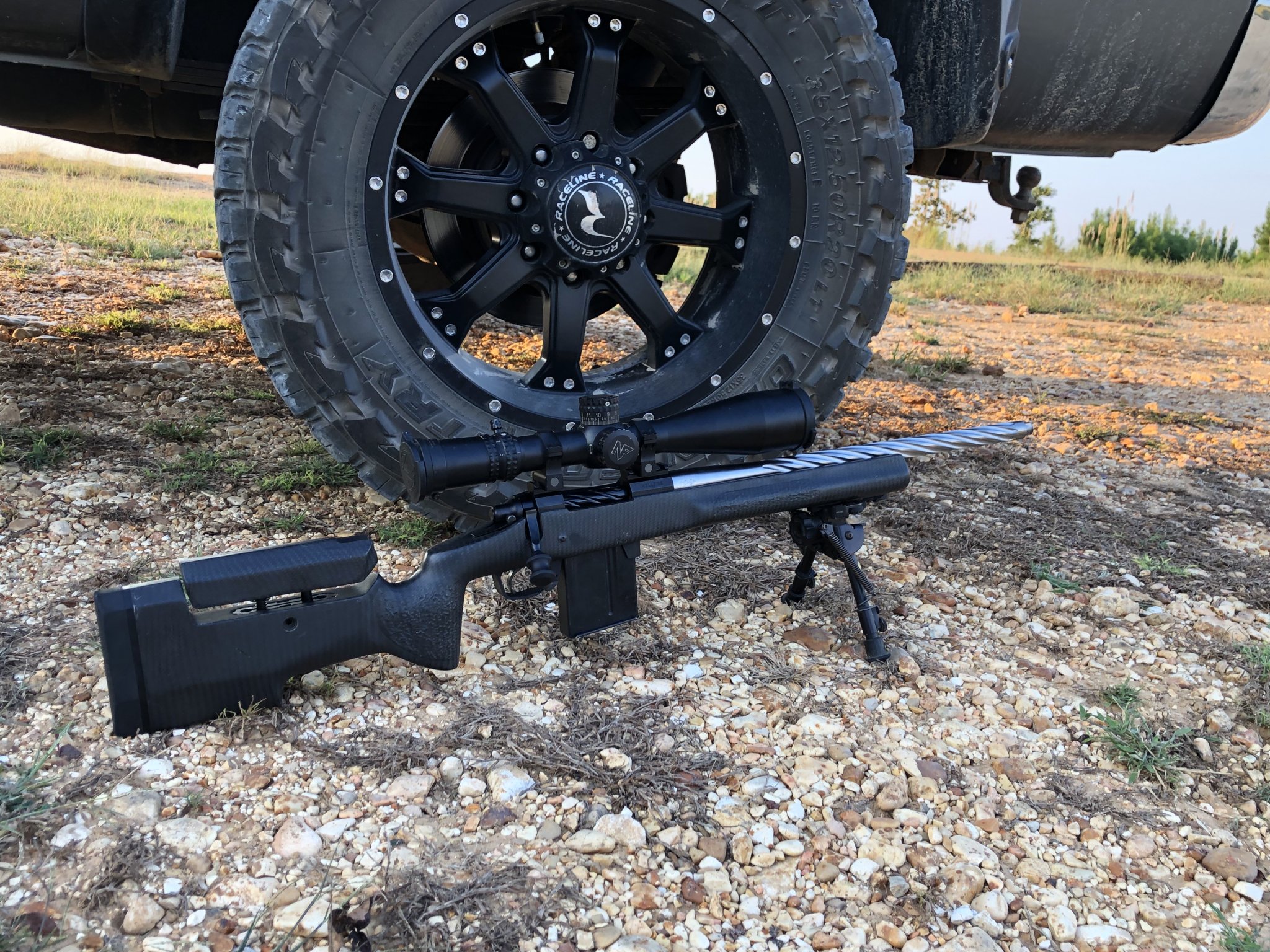

So far so good, got it a 1.5 weeks ago. Accuracy is to be expected, I have 150 rds on it as of today. Slinging 143 elds at 2970 w/h1000 and 140 Berger Elite Hunters at 2980 w/h1000 also.
Tried h4350 with the 143s and achieved 2910 but was getting slight pressure. So I’ll just stick with h1000 unless I can find RL26...
