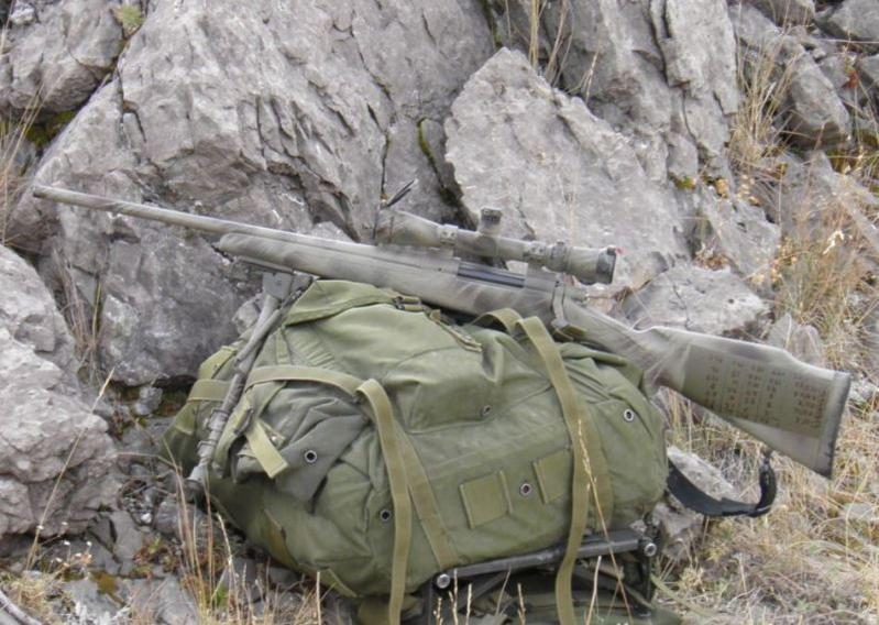

LOL @ Kirk. I started this thread while waiting on things to settle down after hiking into a bear spot. I have contacted Travis @ RBros rifles and he is going to put a 300WM barrel on my lefty 700.
After more thinking and less impulse, I'll have it threaded for @ 22" a can, ( mine are rated for the 300WM bohem), and pick and choose when I go lite and when I go quite.
I have a FG ADL mountain stock, 2.5-10X32 NF, and will have the barrel a #2 all to keep weight in check. Also I have a crazy amount of 300 WM components so I'm going with that chambering.
