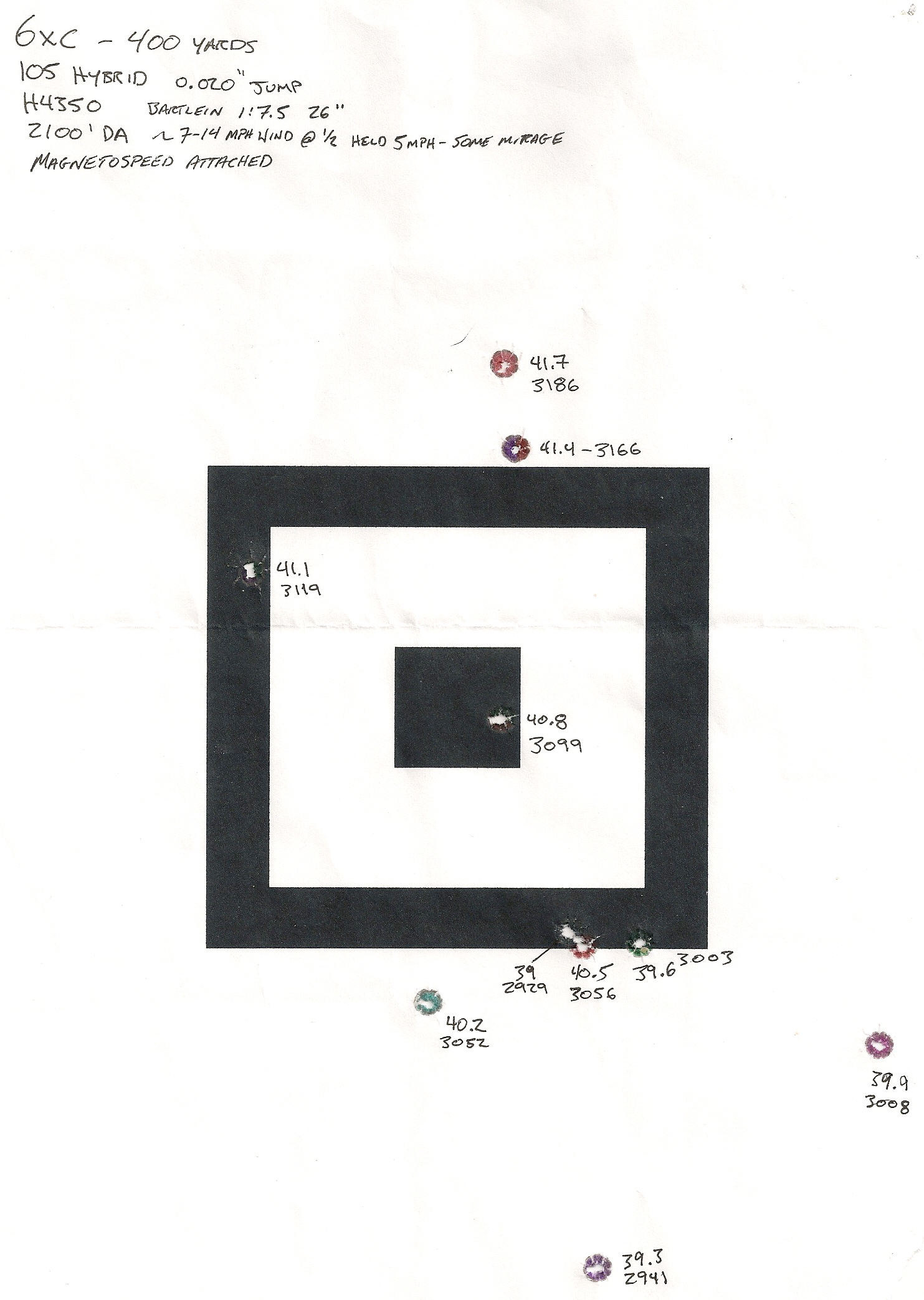

I'm in the middle of working up a load with the 105 hybrids in my 6xc. Yesterday I shot an OCW test, and also wanted to grab some velocities and then shoot a ladder test at 350 yards. The wind was blowing up to 20 mph by the time I got to my spot so I shot into it, for what that is worth. I was having problems with my magnetospeed reading so I didn't get as many velocity points as I wanted. I changed cords and started getting some readings provided I set the sensitivity to 4 or so. Side note, I changed the batteries last night and solved that issue of late. Today, it read fine, with brake and everything. My OCW test is OK, and I probably should have started it lower, but I had an idea of what charges would get me the velocities I was after. I'm looking for accuracy at 2950+, but I'd like to keep pressures down so I will probably not pick the high node to load at.

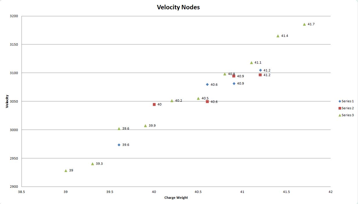

After shooting yesterday I decided to load up 10 rounds 39gr to 41.7gr and simply get velocities. I figured I might as well put bullets on paper though so I put a target at 400 yards for another ladder test. I painted my tips with sharpies and this worked out great because today's mirage made it tough to see bullet holes. Just paint the tips to the o-gives, and place a blank sheet behind your target in case you can't decipher the color if you have a hit in the black. Sometimes you can, sometimes you can't. If you run out of colors you can paint 1/2 blue and 1/2 red, etc. on the bullet and it will show up just fine on the paper.
Anyway, what I found is that when I plot the velocity nodes, they seem to match up pretty close with the OCW test. Below are some results. I'm not the best at shooting groups, and with the strong wind and shooting on the side of the hill I probably should have set up in a better spot for the OCW test. I think the 40gr group could be much improved. The large random group was me trouble shooting the chronograph with other rounds.
All shots felt good today during the 400 yard velocity/ladder test as I was on a nice flat piece of grass, and had relatively steady crosswind. Mirage could have played a small factor though today.
I will probably choose to load at 40.3gr and adjust seating depth. There appears to be another node around 41. 41.4, slight extractor mark and a bit sticky bolt. 41.7 extractor mark and harder bolt lift. I knew I didn't want to try for a load in that upper range, but I decided to get the data.

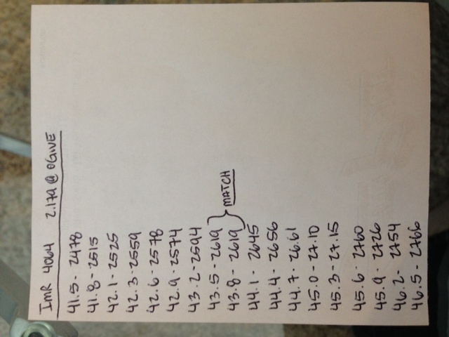

Chrono run today turned out with a match! Unfortunately, it didnt match my OCW test.
According to the above chrono measurements, my node would be in the 43.5-43.8 grains showing at 2619 fps. I was hoping it would have been in the higher node I ran my OCW test between 44.4-46.2,but it wasnt. Here is the link to my OCW test.
http://www.snipershide.com/shooting...7-help-ocw-test-what-do-next.html#post3042761
Any advice would be appreciated!
Clrems if you shot one round each and found that node! Perfect that's what I'm talking about. Just split that node and go right to OAL test. Awesome work, and keeping it simple.

Hey Bubb,
If I were to choose a higher fps node such as 45-45.3, would the 5 fps difference still qualify as being a "good" node ? Not sure how much of a difference the 100fps would make, but I would prefer the faster of the two if that node would work.
We'll, as for faster nodes being more accurate? I'm answering this not on experience but on reading, and others. Usually the slower
Node is more accurate, not always but usually. You need to
Deside what your trying to do ? Short range go for
The lower if more accurate. If your making a long range
Load keep speed in mind you need it. And remember this is a stream
Line test.. If you pick the higher node test it then. But your next
Powder you choose could slightly faster and more accurate! But looks
Like things are falling in place for you...
