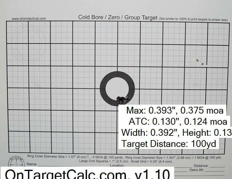

Although you didn't list it my T3 Varmint .204 liked 8208XBR, however that was with a 39gr Sierra. Every charge weight tried shot under 1 MOA, and mid-range loads shot the best. Unfortunately I haven't revisited this rifle since getting a chrono.
