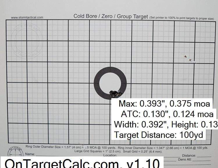

I shoot them in a Tikka varmint stainless factory rifle. I cannot touch the lands at all with the 39sbk.
I would not worry about touching so much as finding a good powder charge and then doing a seating depth test to fine tune.
I have no idea how far it is jumping but it is over book length, right at max mag OAL if I remember correctly. Burning 8208XBR.
