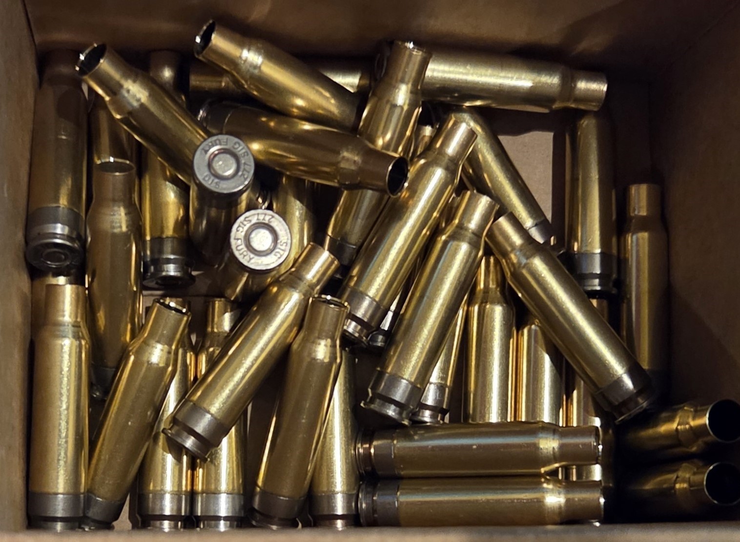

As I've mentioned in another thread, I've sorted through 5 boxes of these hybrids. From the 5 boxes I received, 287 of them have the "24" headstamp, 158 have the "277 Fury", 87 have the "23" and 22 just have the "Sig" for a total of 554 cases altogether.
The 24's were the heaviest and the 10 of them that I fire formed had case volume of 56.3 grs H2O. Most of the 23's were in the same weight range as the 24's, but a few were substantially less. The "277 Fury"s were consistently way lighter than the 24's and those few Sig's were about the same as the Fury's. Once I fireform the Fury's I've loaded up, I suspect the case capacity will be more like ~57.5 grs of H2O due to that weight difference.
The ten 24's that I only fire formed produces really good results both on paper and in terms of SD's and ES's, which surprised me as I had loaded them with the same primers I had removed in order to anneal and size them up to a .308. But then, it's only 10 rounds fired. ;)
Have only gotten the 6.5CM to work well so far. My current load so far is 44.5gr H4350 with the 140 ELDM goind about 2900 with a 24" Proof. Going to load up some RL16 for tomorrow. Historically, it should be another 100fps according to my old barrel. Been saving RL16 since it's sometimes impossible to get and now it's crazy expensive when you do find it. That's easily with in if not faster then 6.5PRC speeds. Also tried one of my friends load with the 130gr bergers and 2000MR. Was running them around 3100FPS but it was too hot. Haven't too much at distance yet only about 20 rounds at 600 with the 6.5. Still trying to nail this 308 load. Not sure why it doesn't want to shoot well. Brass cases still under MOA with ammo I loaded over a year ago.
I've noticed all my cases are either around 150grains with no primer or 161gr. The 161g cases take almost a grain less powder to achieve the same velocity. The lighter cases seem more consistent but I need to look at all my data to see if that holds up

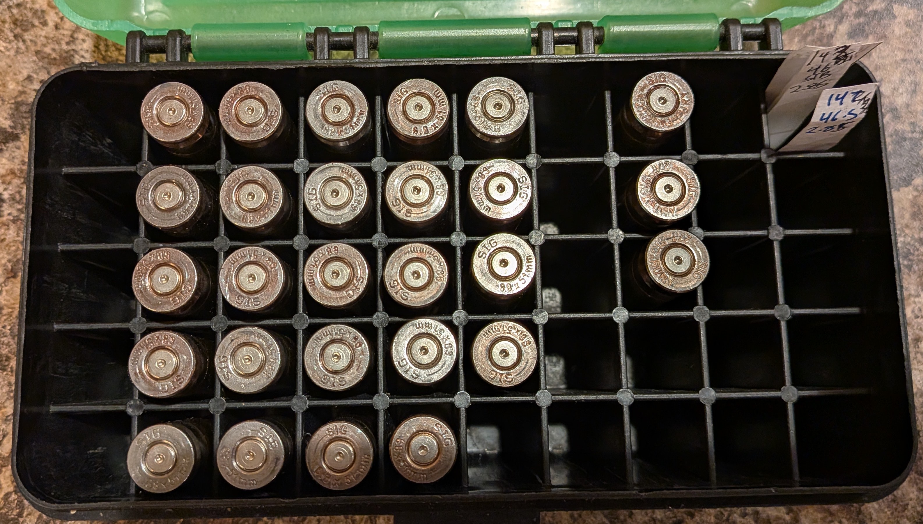

The old Sig cases didn't have a year stamped on them.
They are a bit lighter, and some very consistent if weighed out, 58 pcs out of 100 were within just 1 grain total weight.
I have a few with the 22 yr and a new bunch with a 23 yr...the 23 yr are all Sig. I have none stamped Fury.
The 23 yr are a bit heavier also have powder stuck in the cases and needs to be blown out with compressed air.
Likewise, my cases with the 24 and 23 stamped weighed at 161 grs and the ones with Fury stamped on them and those only showing Sig all weighed around 150 grs. I'm pretty sure you're right that there at least a full grain difference between them.

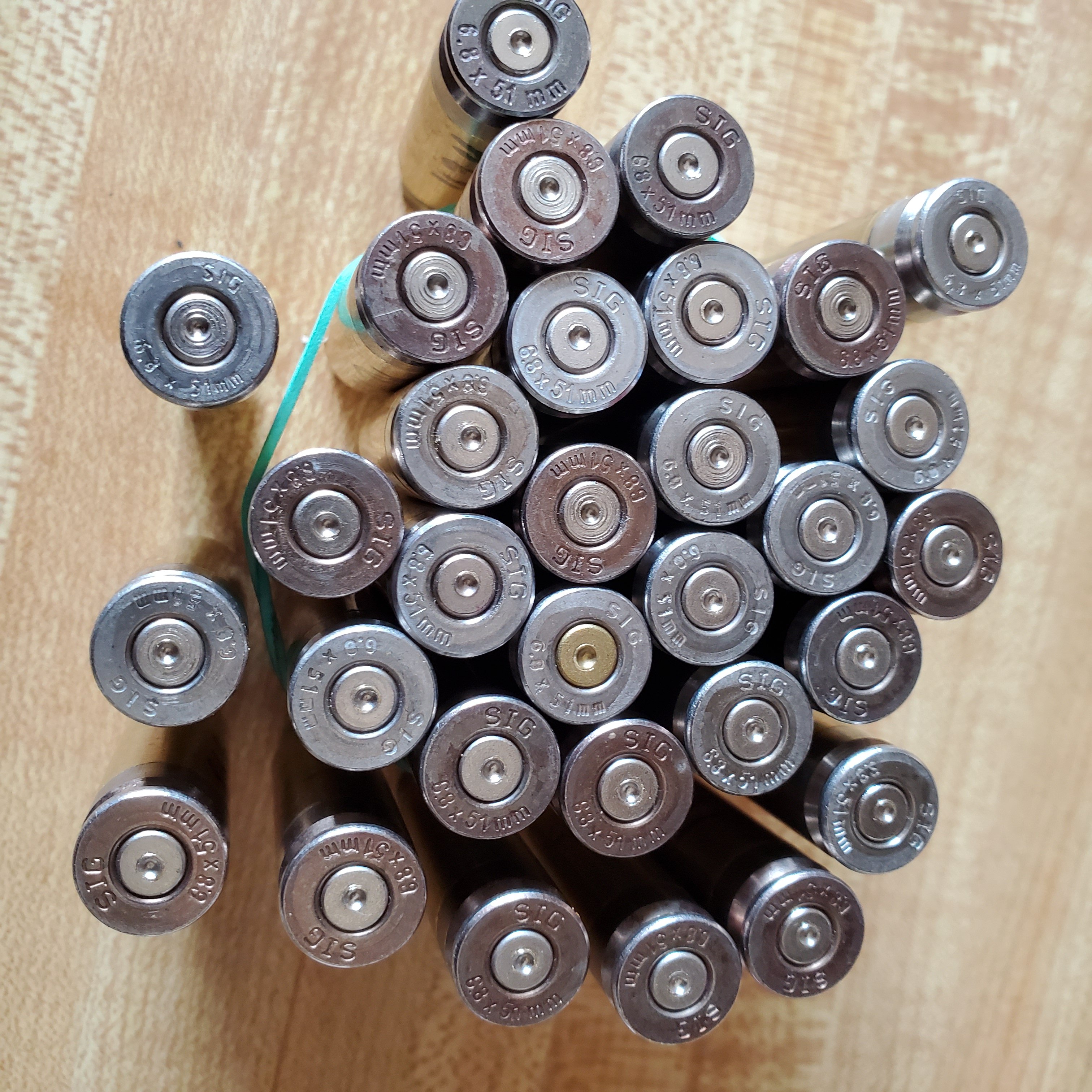

My hybrid cases that have some powder still suck in them after I tap what's loose out, I just leave in and when I anneal the case the remaining powder just burns out. Which is ok since my next step is to wet tumble with SS pins for 25 minutes before sizing. :giggle: Here's what they look like when finished before fire forming:
