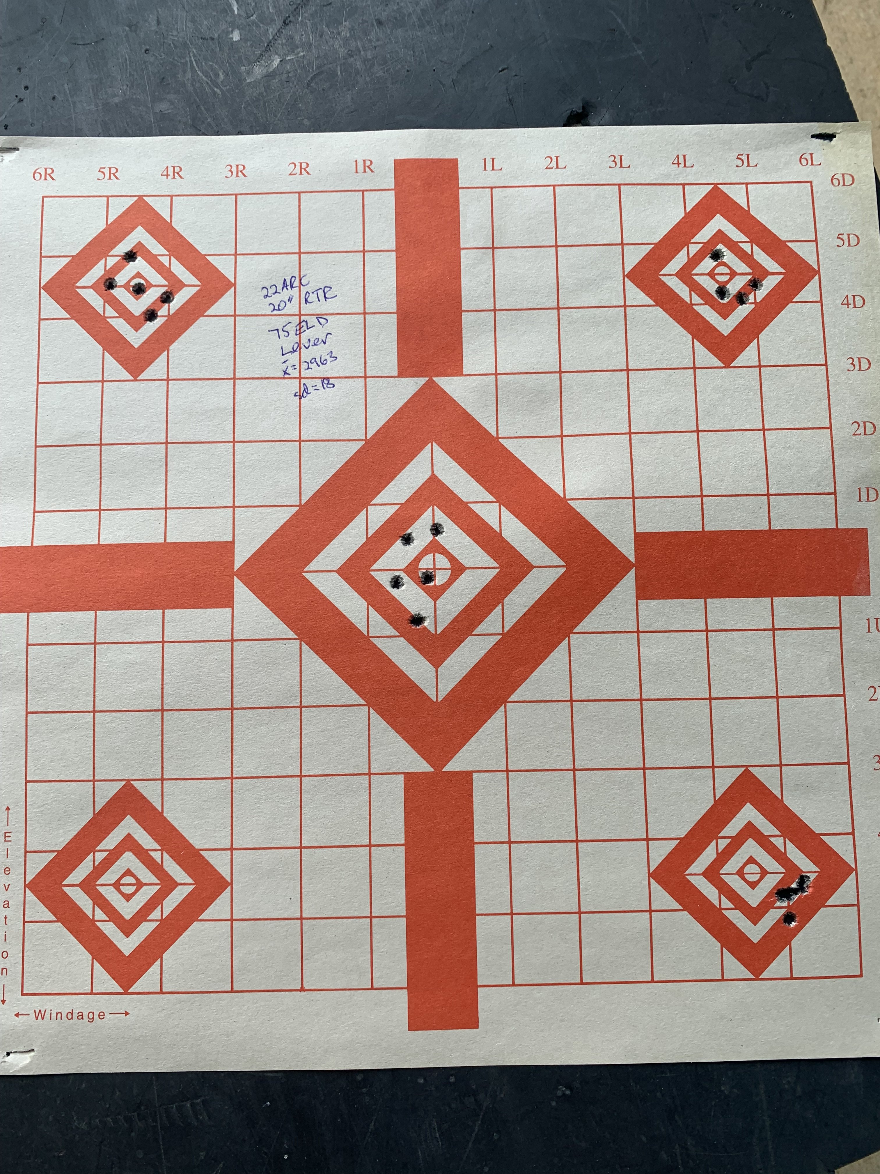

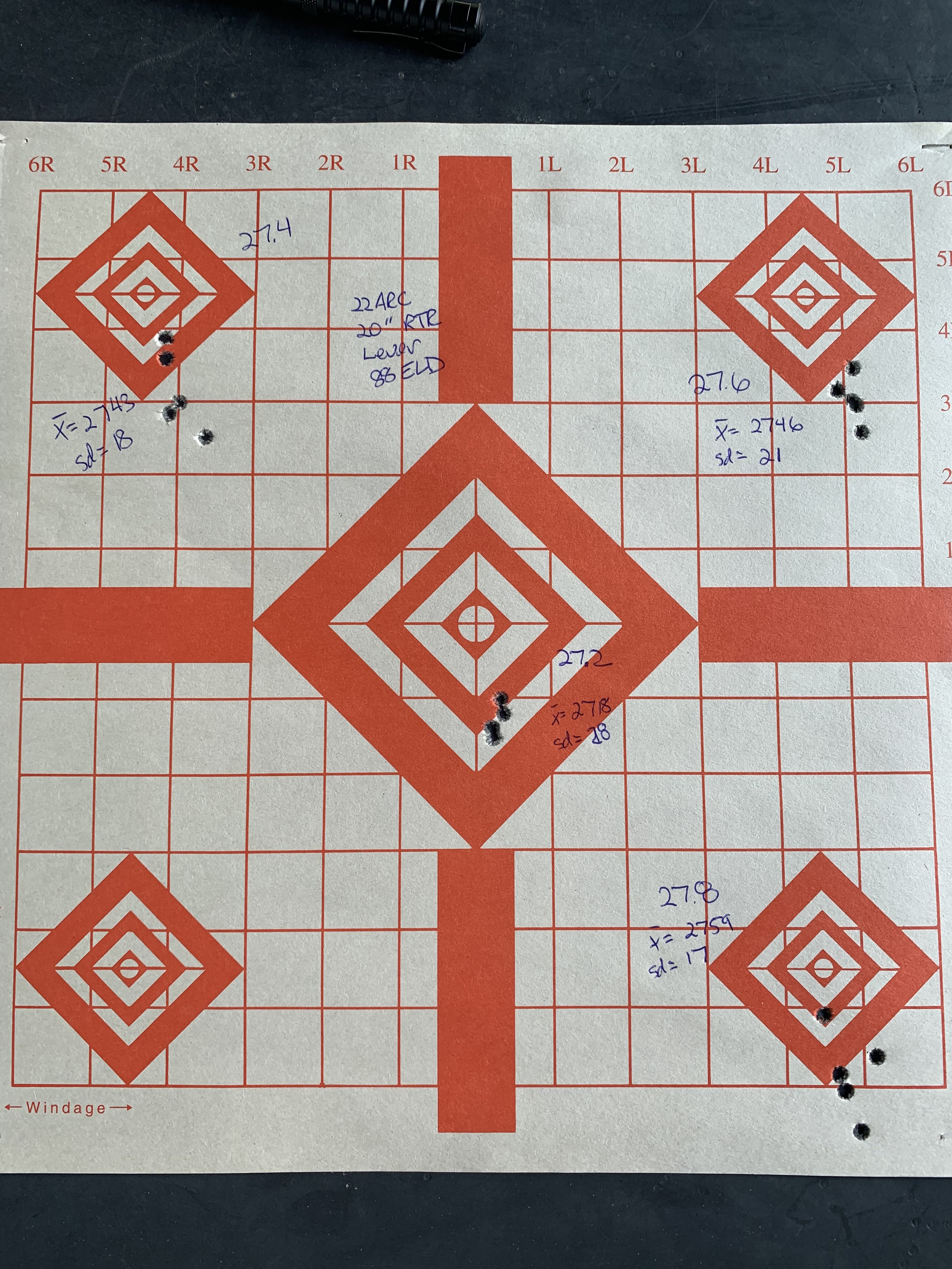

AR15, 20" RTR barrel, suppressed
28gr Ramshot TAC, 75gr ELDM, Hornady brass, CCI 450 - 3000fps
27gr TAC, 85 Hybrid, Hornady brass, CCI450 - 2850fps
