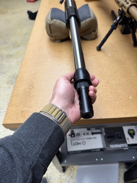

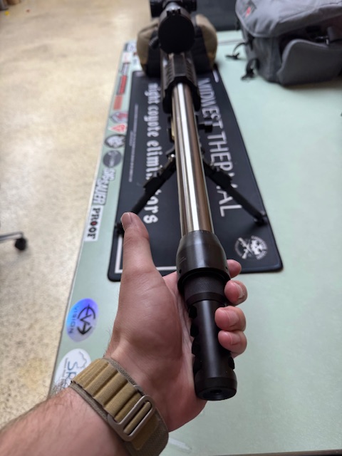

My local guy got the barrel done.
Looks like some really great work from a small guy here in Illinois. Shoutout to Josh Egyed!!
This barrel is MASSIVE!

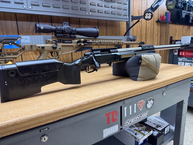

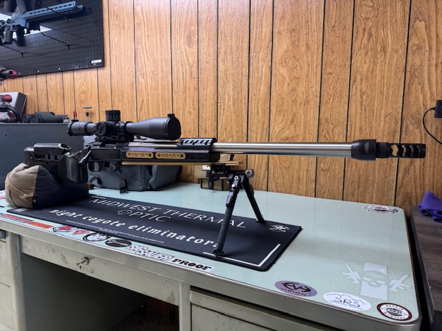

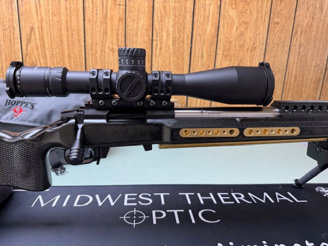

22 CM build finally done.
Impact 737R
Bartlein 20" 1:7
Going to load up some ladders with Berger 80 and 85.5.
Looks like H4350 is a good starting powder for both? I've got buckets of other powders too if there's another suggestion...
Was thinking 0.5 increments for the 80s from 39.0 to 41.0
And from 38.0 to 40.0 in the 85.5s
Hogdgon and Hornady manuals don't list 4350 for these bullet weights....so wanted to confirm this was a good starting ladder range before I go loading rounds.
Would a 7 twist be better than 7.5-8 for 80s?

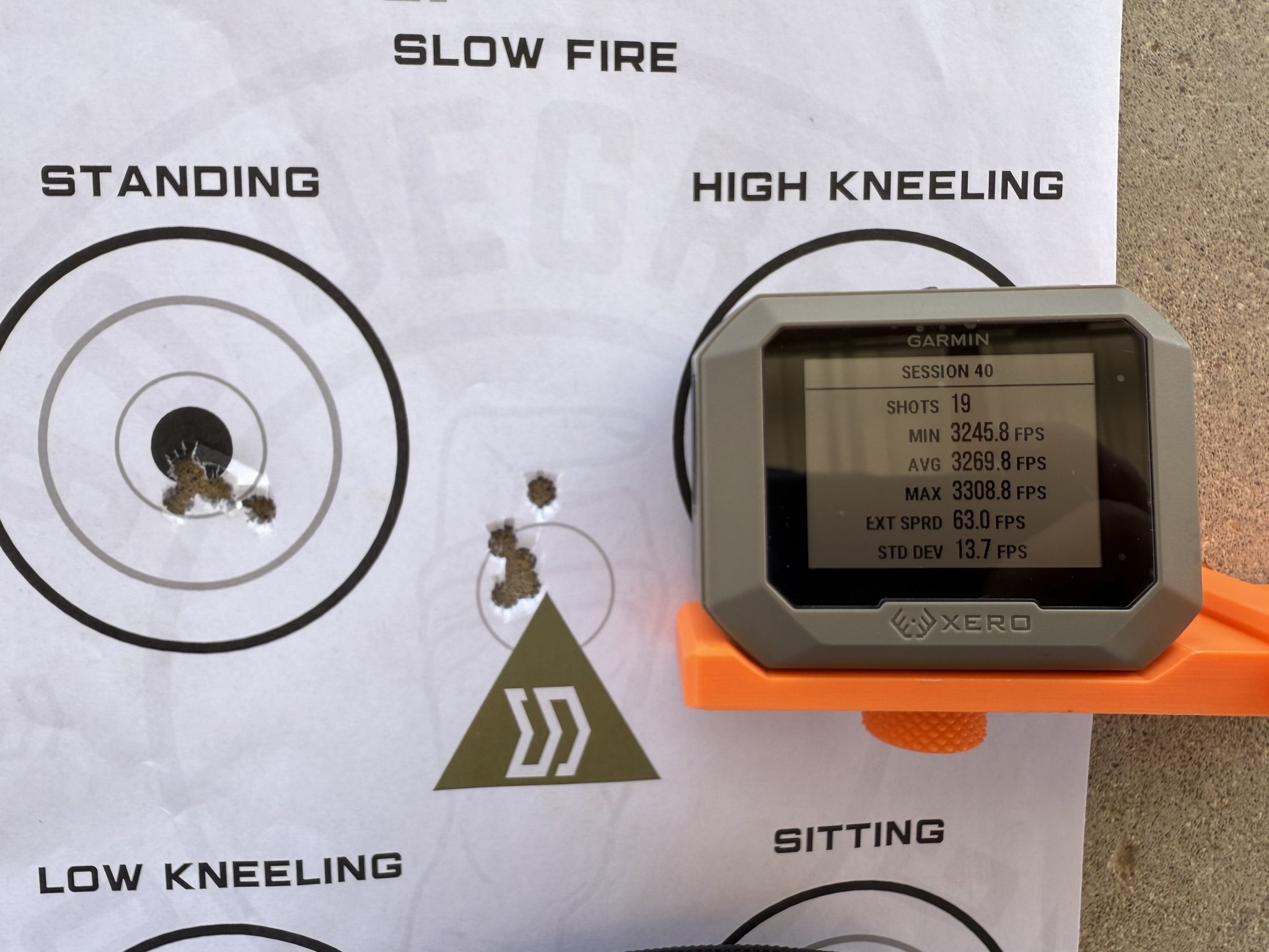

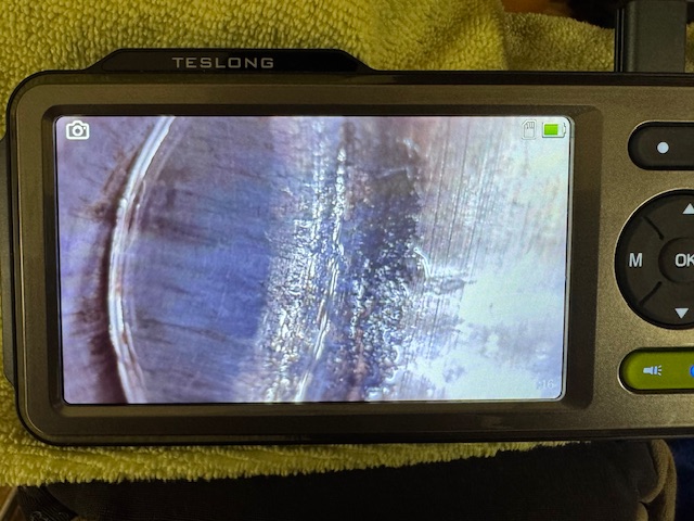

I went out to shoot the 22cm some more and had some really odd stuff happen. I had about 150-175 rounds down the tube and it shot lights out with just about everything. Now I'm struggling to get 1 moa, and struggling to get 15fps SD....Not sure what gives. Barrel is clean, there was a minor carbon ring, nothing I would typically worry about. I've had far worse. Scrubbing that sucker out tonight.
The good load that shot at 3450 is gone, and the good one that was at 3250 is also gone. I tried between the 3250 and 3450 in .5 gr increments, not a single one would shoot. Seriously, 1-1.5" groups. Occasionally 2 would stack, but the other 3 of the grouping would be all over the place.
I've always shot it between .020 and .040 off the lands and it was great. Berger 80 VLDS. My CBTO is 2.025, and it has only changed about .001-.002 with a total of about 290 rounds through it now.
I even grabbed two different rifles, thinking i just could not shoot that day, and that was not the case. They hammered.
I did the usual, checked action torque, scope, muzzle device, etc...all good to go.
Maybe that thing shot lights out up until it was well broken in and sped up, then fell off a cliff? Never had this happen, but i also haven't shot this overbore either.. Typically i shoot 6cm,6.5cm 300prc, 300 norma.
Is it possible the bullet is just not shooting well in the barrel anymore? This is also my first go with VLDS, which I've heard can get finnicky, but i was happy from the get go because it just shot excellent, no matter the charge weight. It even shot great up to 3650 FPS which was crazy..
I have new brass to try aswell...I will add that I'm no expert reloader, however i feel like i do OK. Charges are within .02 gr + or -. Sizing on the fancy expensive A419 dies ( no i did not pay retail, i got them dirt cheap from a good friend getting out of reloading), SAC seating die, BR4 primers. I have to be missing something, its weird how it was just a light switch..flipped off and now it will not group.
Here’s a pic, soaking wet with c4.
The other thing i was considering was bad powder? I was using up my last 2 - 1LB containers, then switching to a new 8LB jug of 4350.
Thanks for any insight, most people on here are far better than i am on this stuff.
