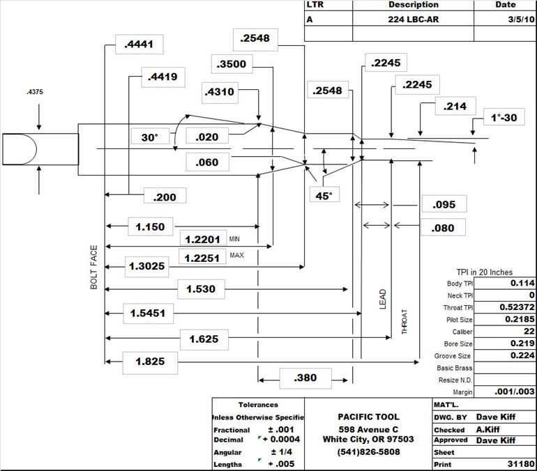

Do you guys happen to know the neck diameter of your particular chamber/reamer? Fired neck dimension would be sufficient, figuring 001 spring back. I know my chamber is going to be tight necked, if I had to, I'd rather buy a 224 lbc reamer and just hand ream out my current chamber.
PTG tolerances are plus or minus .001"

Awesome, I appreciate the info. In regards to LBC, Predator and 6Grendel....are the differences all in throat and/or freebore? I was talking to my barrel smith not long ago about a Grendel based 22 and he told me the LBC was a different reamer. I was curious exactly where the difference is. I tried looking around myself and info is sparse in the more obscure cartridges.
Yes, they are all different reamers but the differences are mostly the freebore. The 224AR was the first, then I made a 22 Banshee around 2007, then the 224LBC came from Black hole weaponry then I made the 224 Predator then they came up with the 22 Grendel. All have the same headspace and body dimensions. There are very small differences in neck diameter and freebore length.
I believe the 224AR was a little tighter neck dia for shooting highpower(check Robert Whitley's site 6mmAR.com)
Reactions: thelaststraw
I really appreciate the info. Screenshot and saved! I knew of the Whitley items, but not all the background. Many questions answered in one post right there. Thanks for your time sir.
