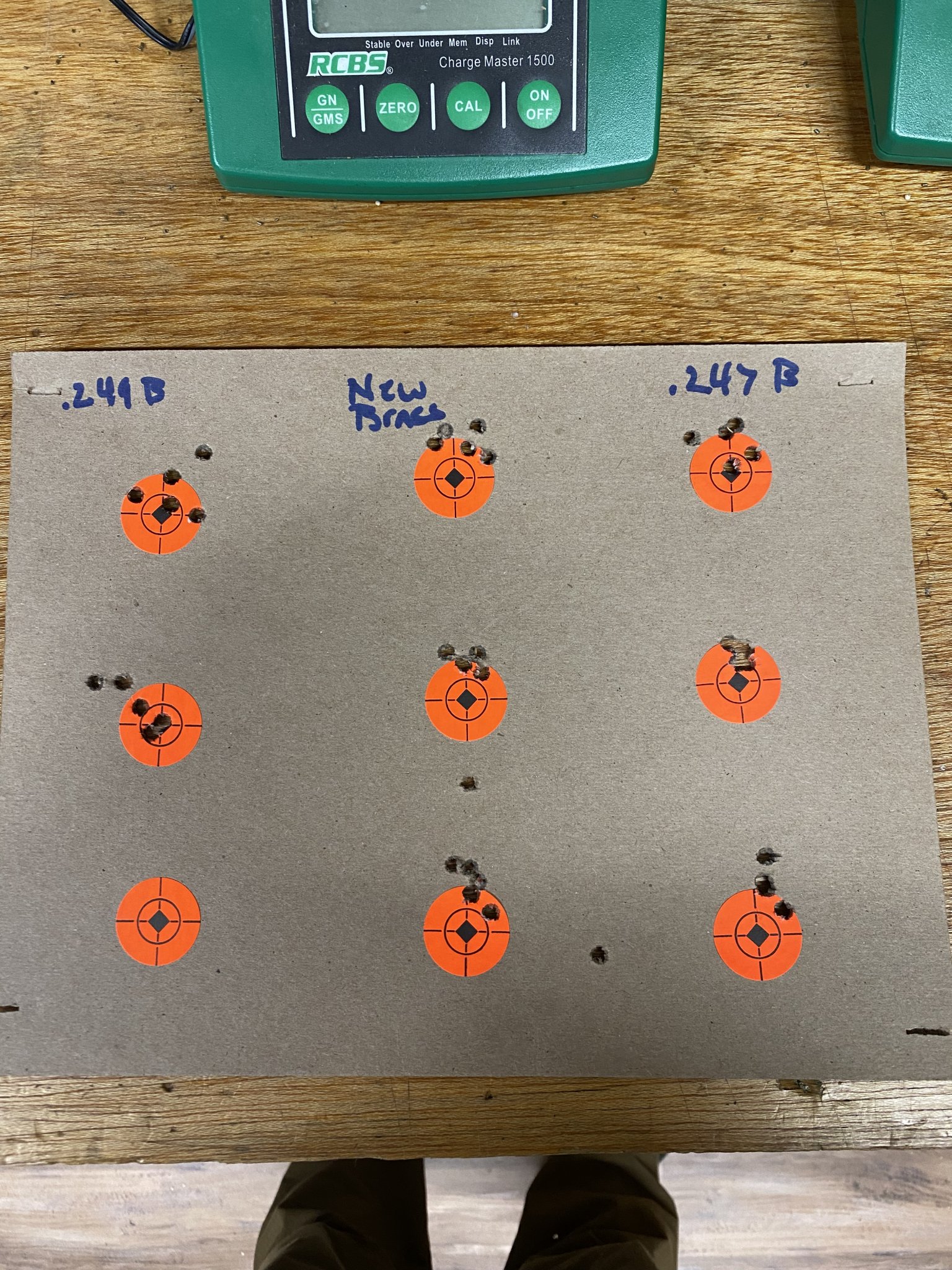

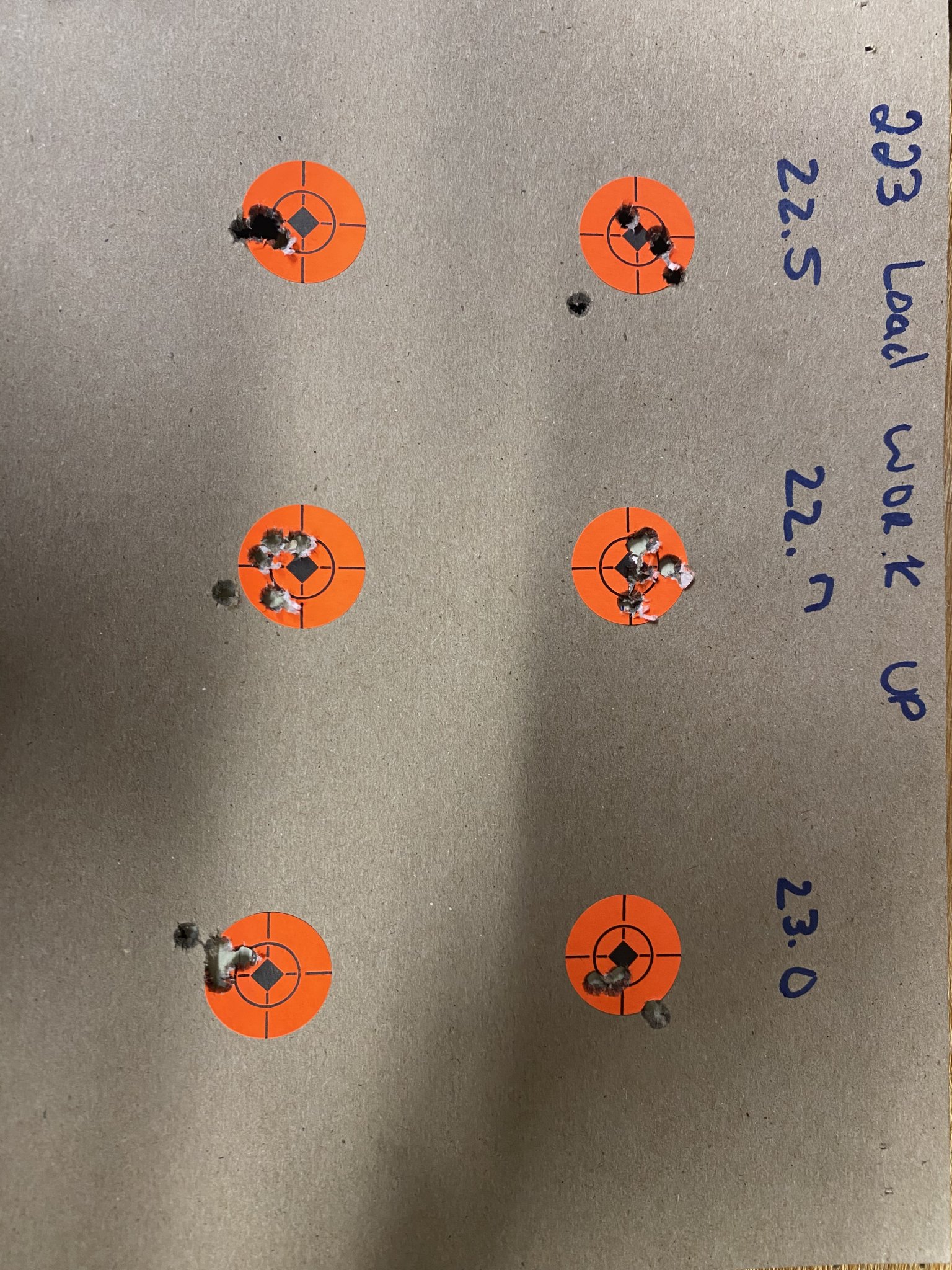

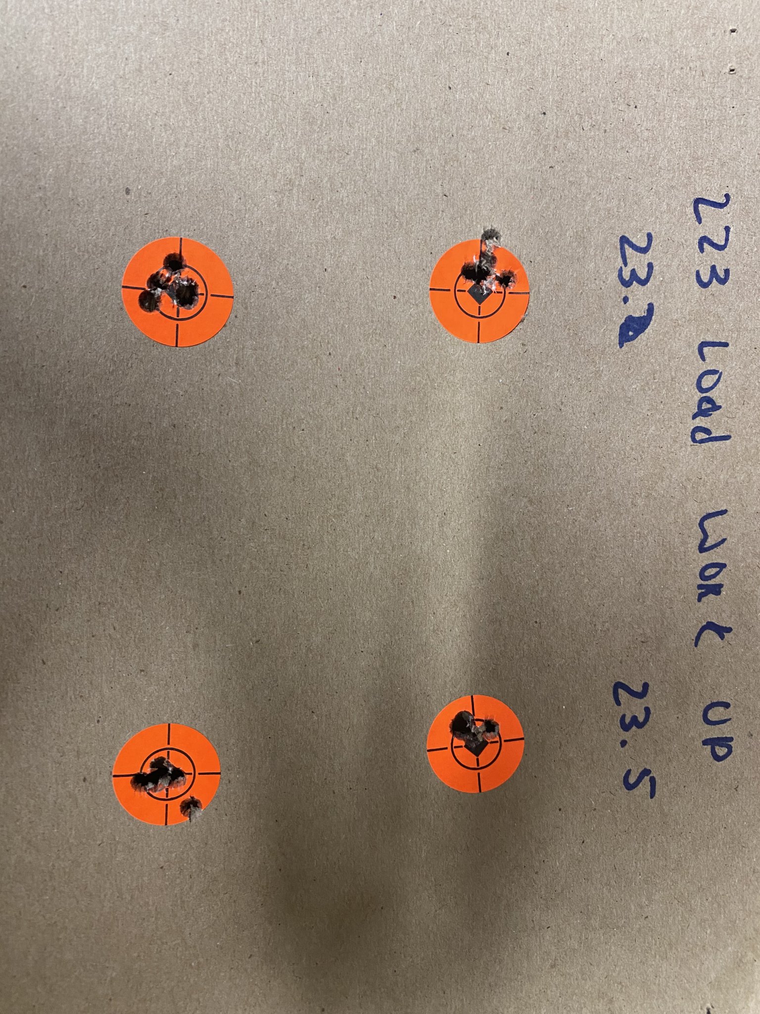

I have found good groups with 23.5 gn but I don’t feel like the consistency is there. I can shoot groups that are a ragged hole then 3/4“ to 1”. Sometime I get a flyer that is 1.5” to 2” out. I would just like to nail down a load and run it and stop chasing the best load.
This load work up is with COL 2.425 the bottom row is with magnetospeed attached. All photos are 75gn ELD-Ms.
This was testing a .249 bushing vs new brass (out of box) and .247 bushing all 23.5 of 8208 all 2.425

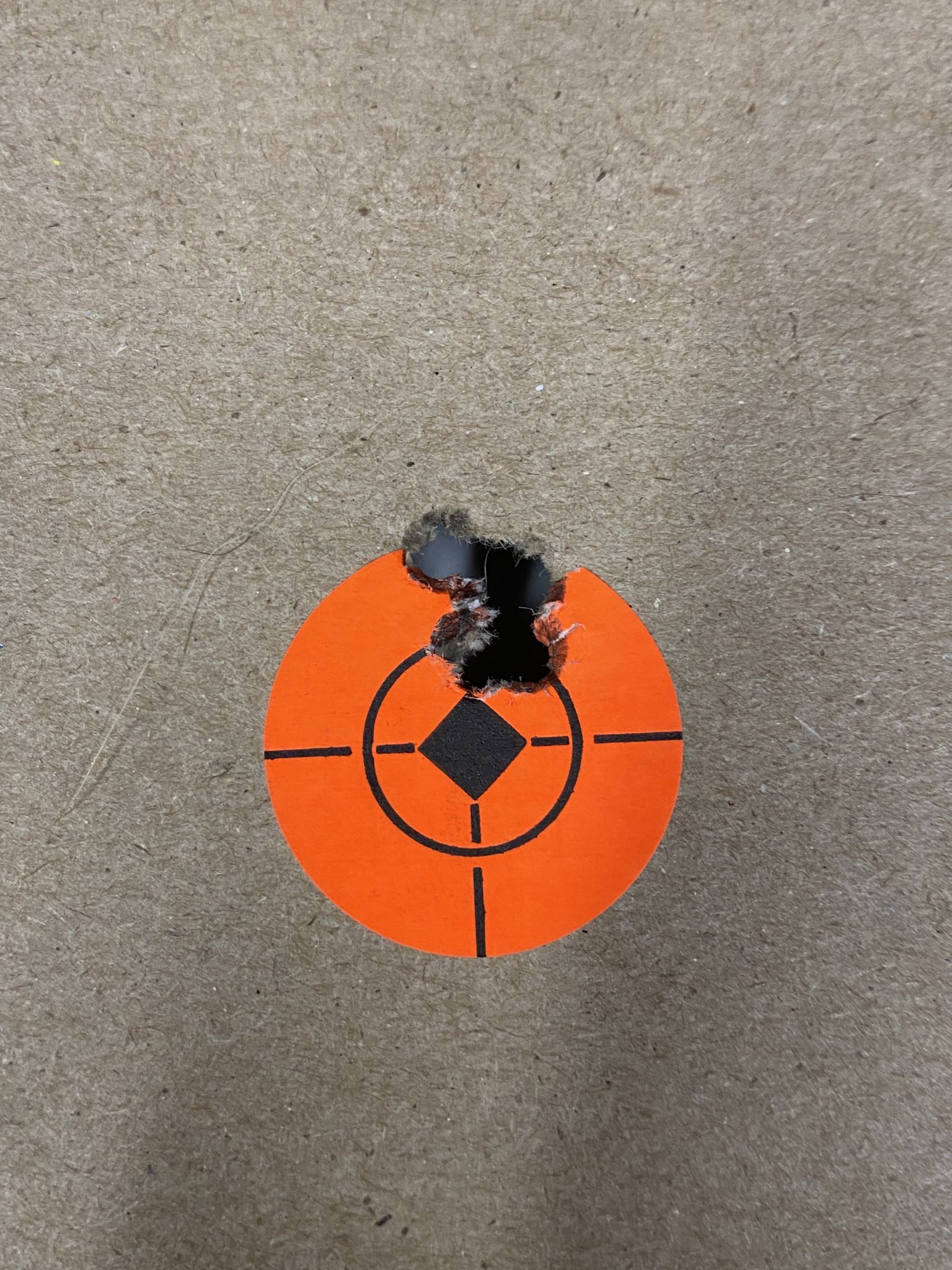

This is the best group from the test above, which tells me it will shoot.
This group is 22.8 of 8208 @ 2.425

F/L Size with Type S die (currently .247 bushing that measures .003 neck tension.
Trim of Giurad Tool trimmer
Prime - Fed 205 GMM.
RCBS Charge Master powder charge.
Seat with Forster Ultra Micrometer Seat time.

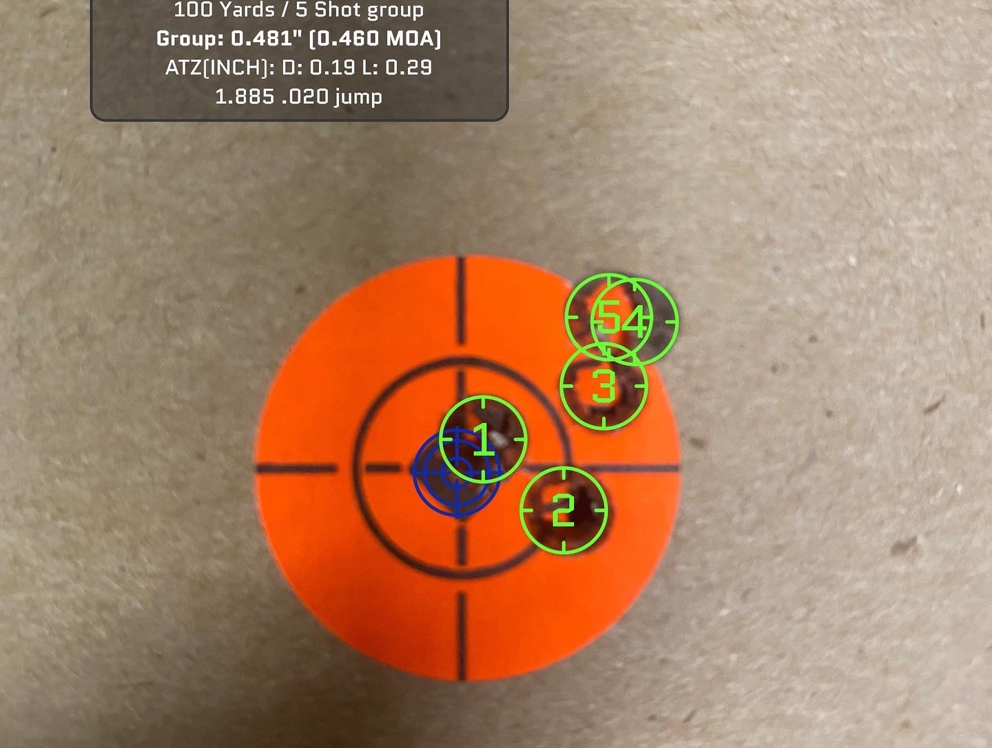

Did some testing with COL and 75s ELD-Ms and 80 VLDs today. Other than pulling a shot 2in low with 2.425 they all shoot around .75" or less. The 80 VLDs show some promise too. Im just wondering if I am splitting hairs. Each range trip I generally get one group that tears a ragged hole (see photos) the others were .6-.75. All shot today. waiting 3-5 minutes between groups. Outside air temp was 48* during test.
Top photo is with 75gn ELDs. 23.5 of 8208 XBR. COL is the test.
  • 2.400 is .040 off lands
  • 2.420 is .020 off lands
  • 2.425 is .025 off lands
  • 2.430 is .010 off lands.
This charge is 21.3 of 8208 and COL are noted. I believe they are .040 and .020 off the lands.

I’ve got some questions about 223 loads with 75 ELD-Ms and 80 Berger VLDs with IMR 8208 XBR in Lapua brass.
I have a Redding Type S die with the following bushings .247 .248 and .249.
Rifle is a Savage 10 with a Hawkhill 1-7T prefit with 223 Wylde Chamber.
What Charges and COL are you finding the best luck with?
This load work up is with COL 2.425 the bottom row is with magnetospeed attached. All photos are 75gn ELD-Ms.View attachment 8064295
This group is 22.8 of 8208 @ 2.425View attachment 8064297
Thoughts on were to go? I am running a COL test with 75s at the folllowing COL - Jump if my Hornady COL tool measurements are correct lands at 2.440.
