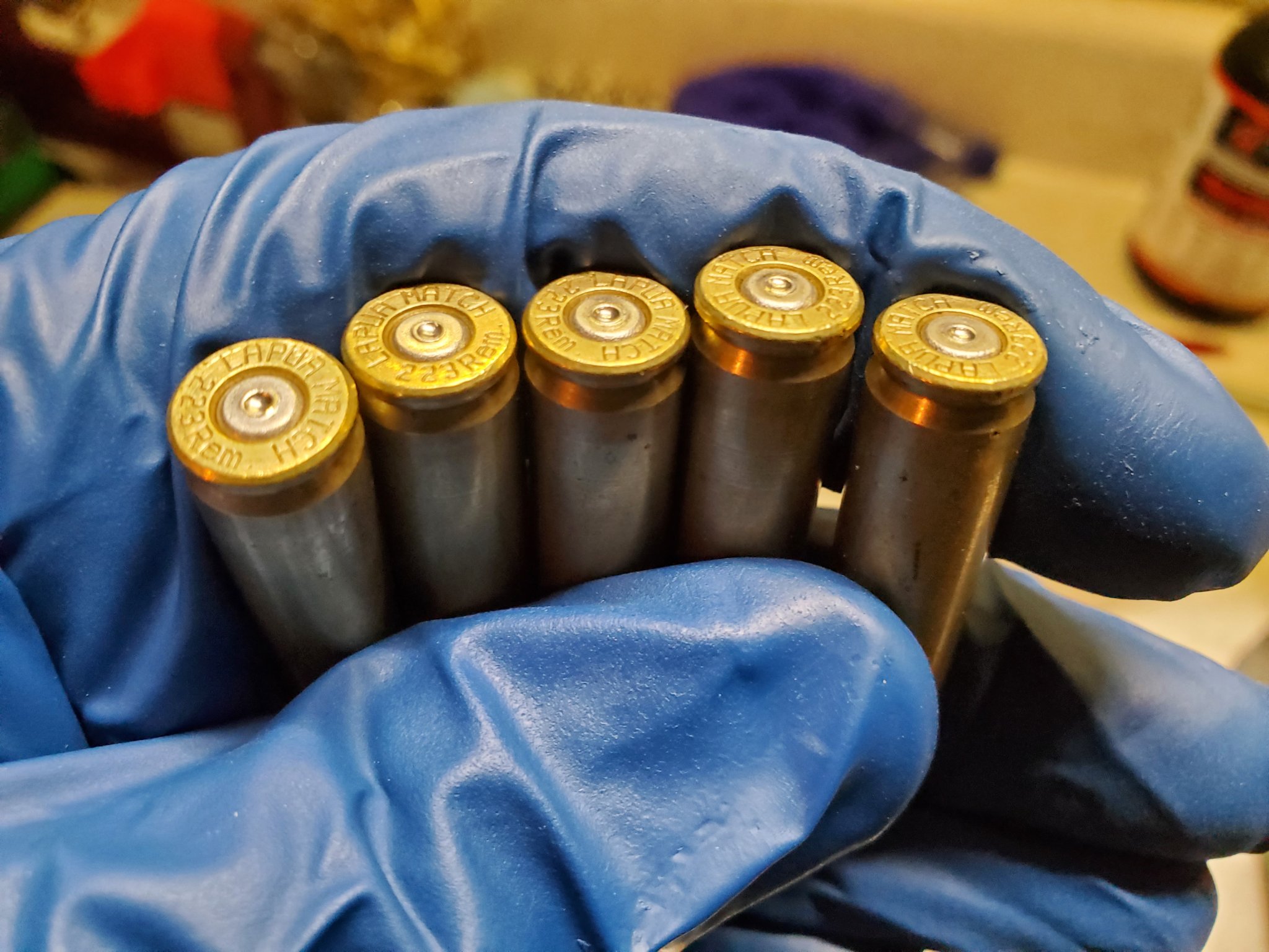

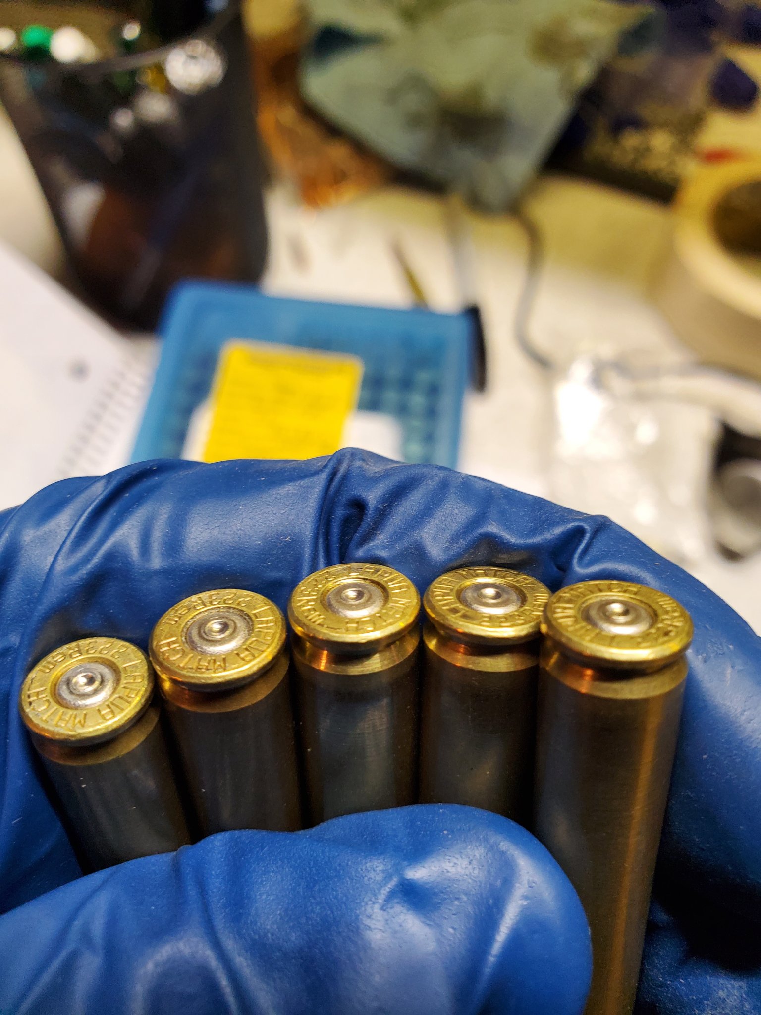

Too hot or ok? Finger nail doesn't catch on the spot where the firing pin hits.

Yeah looks like some primer flow but not a big deal.
I have heard sometimes it looks a little worse than it is with Tikkas but I am not sure. Need to go shoot something loaded close to factory power with those primers and see how it looks.
When I get half a grain past the charge in the first pic primers get flat and the flow is pronounced enough to catch your nail on.
Reactions: Dolomite and Rob01

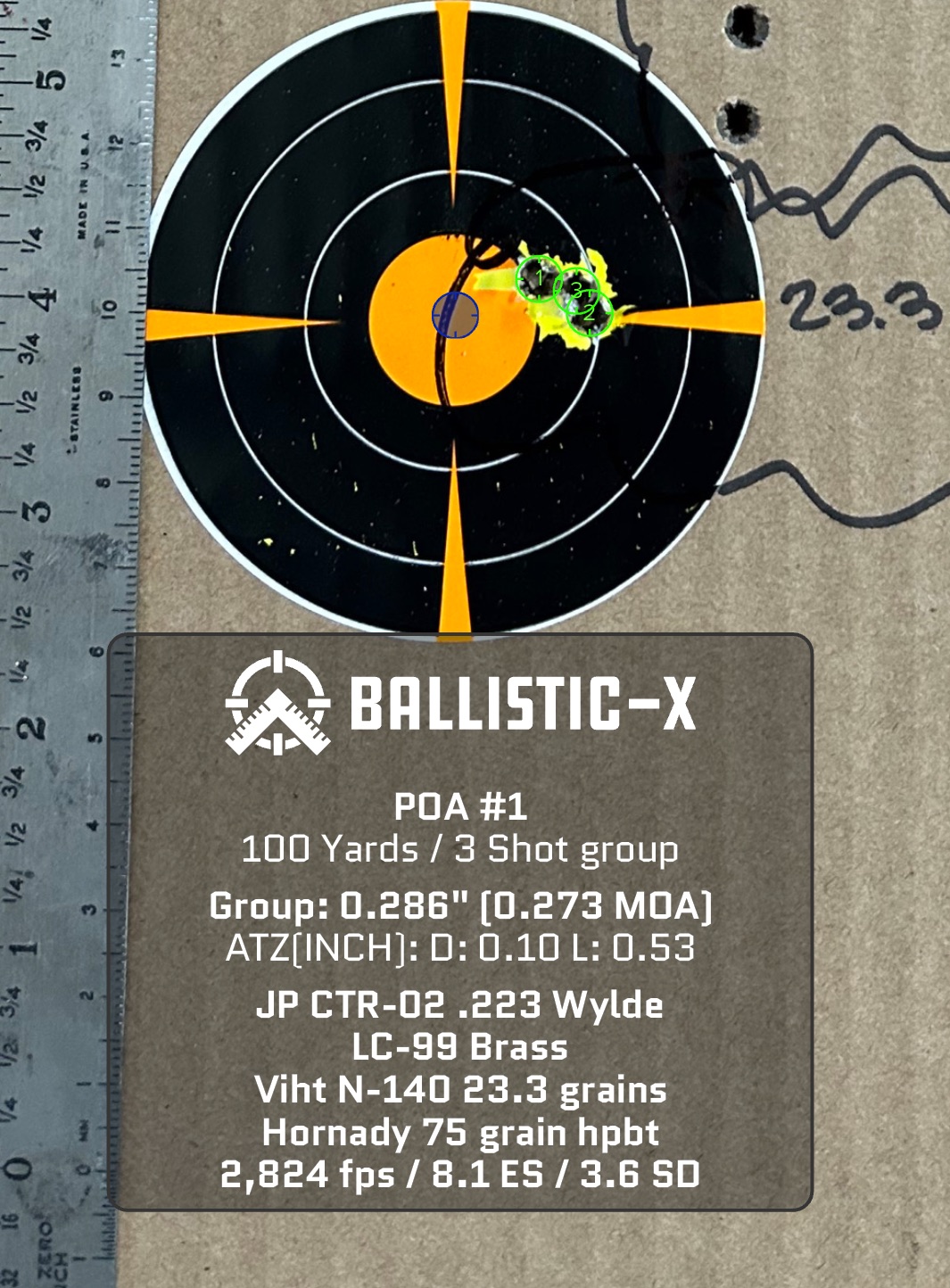

I have never been successful at working up a great load for my gas gun but went to work on it today and finally found a load that had great numbers and shot small.
LC-99 brass
N140 23.3 G
CCI 41
Hornady 75 HPBT
2,824 fps 8.1 ES / 3.6 SD

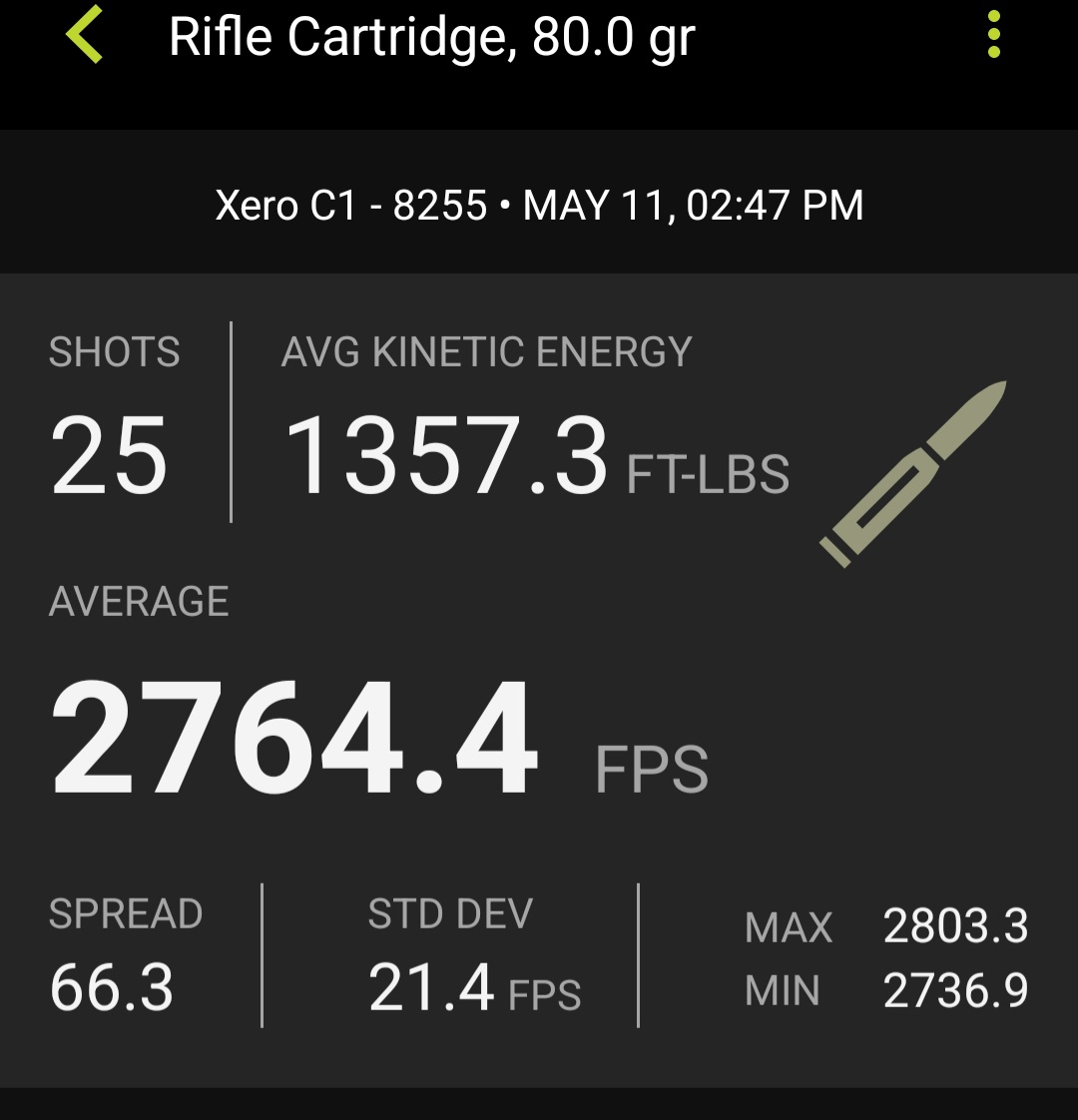

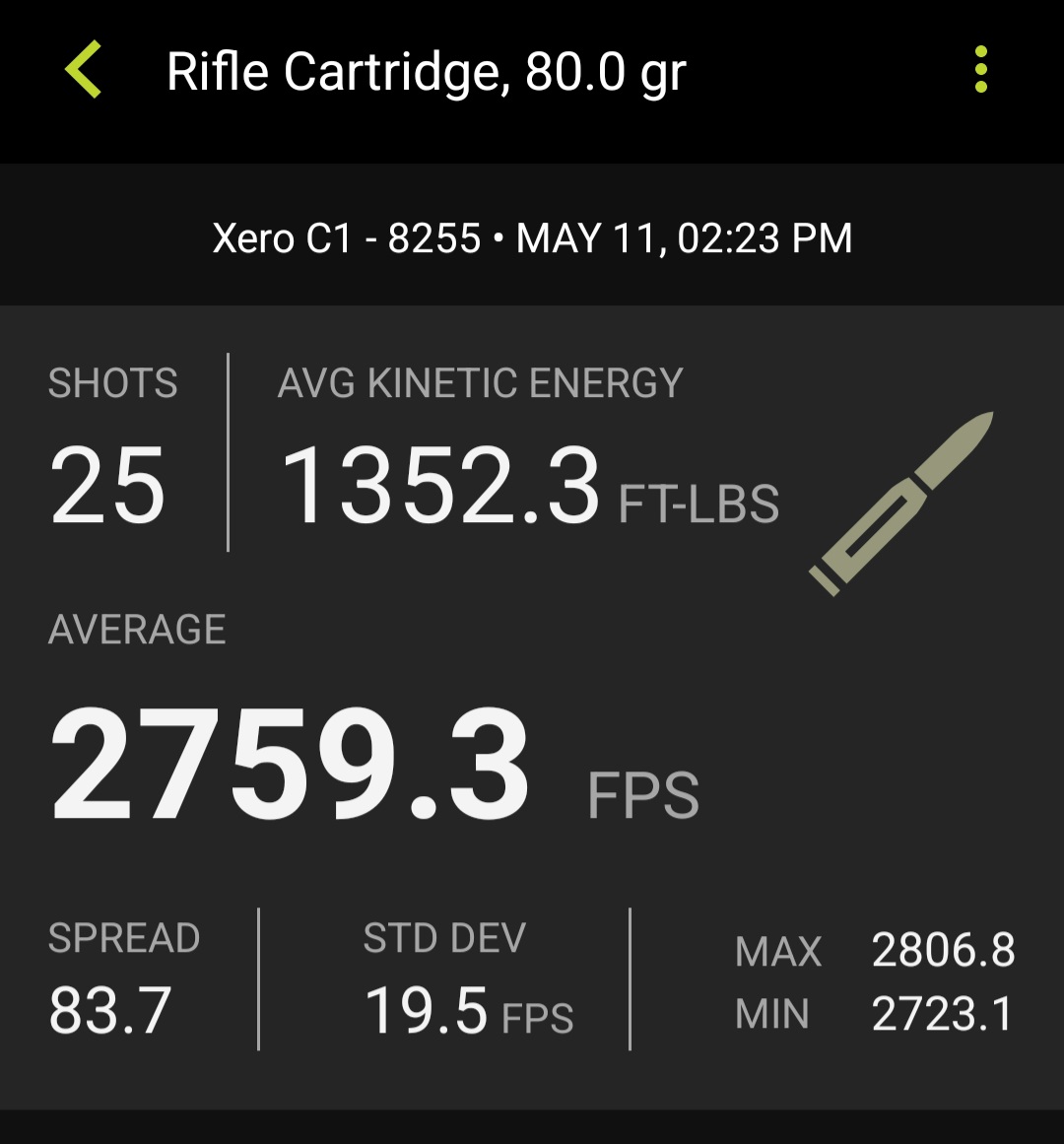

Here is my latest load. I shot two 25 round strings. I know the 223 is pretty finicky on getting low SD/ES. Are these numbers about right or should I be getting better results?
Starline 223 brass
Sierra 80g smk
24.5g varget
Remington 7 1/2 primer

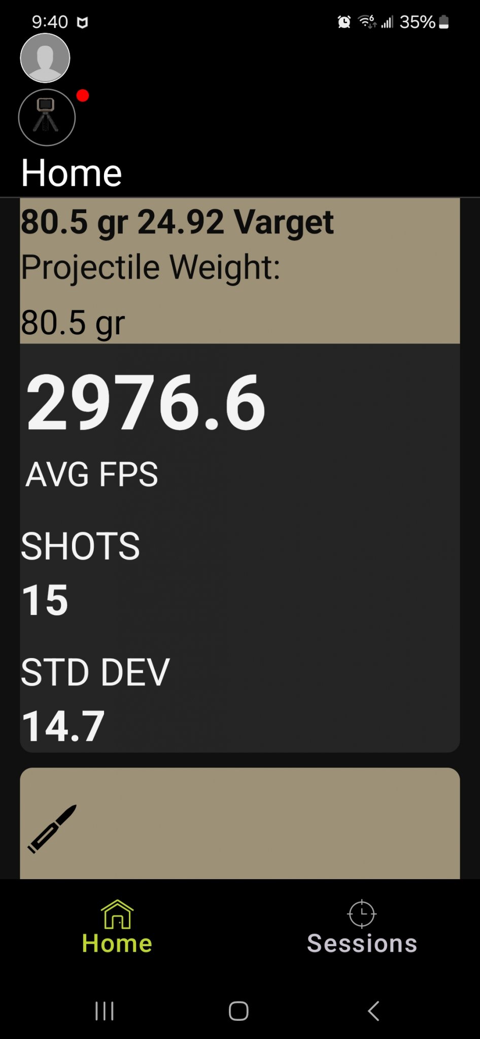

For those looking to compare N140 vs Varget I finally tested Yesterday.
Loading 23.7G on a 80.5 Berger gave me 2729 FPS vs 2821 on Varget.
Loading 24.92 on the same 80.5s gave me 2891 vs 2989 for Varget.
28" barrel loading long.
YMMV
