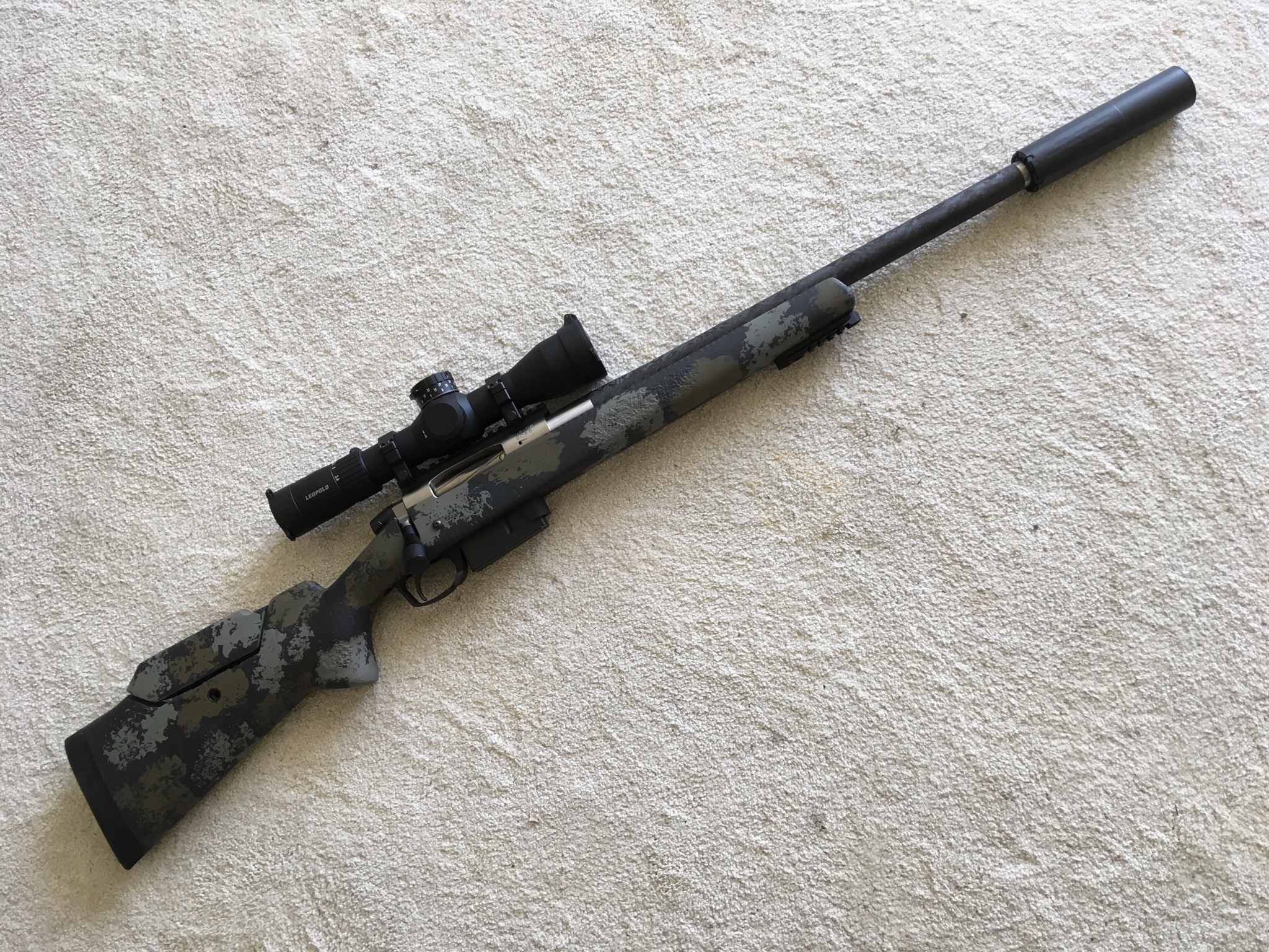

I am using the plastic Accuracy International mags for my 223 Ackley built around a Terminus action.

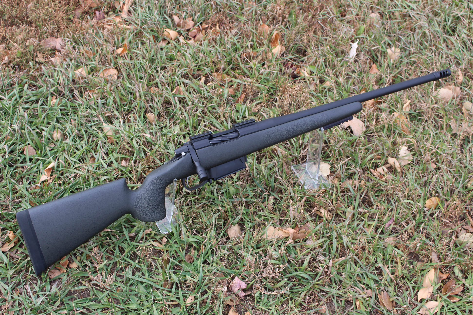

I'm also using 5 rd Accurate mags with 75 gr amax in my 223AI and they work great.The barrel on mine is 20 inches and a handy little rifle.

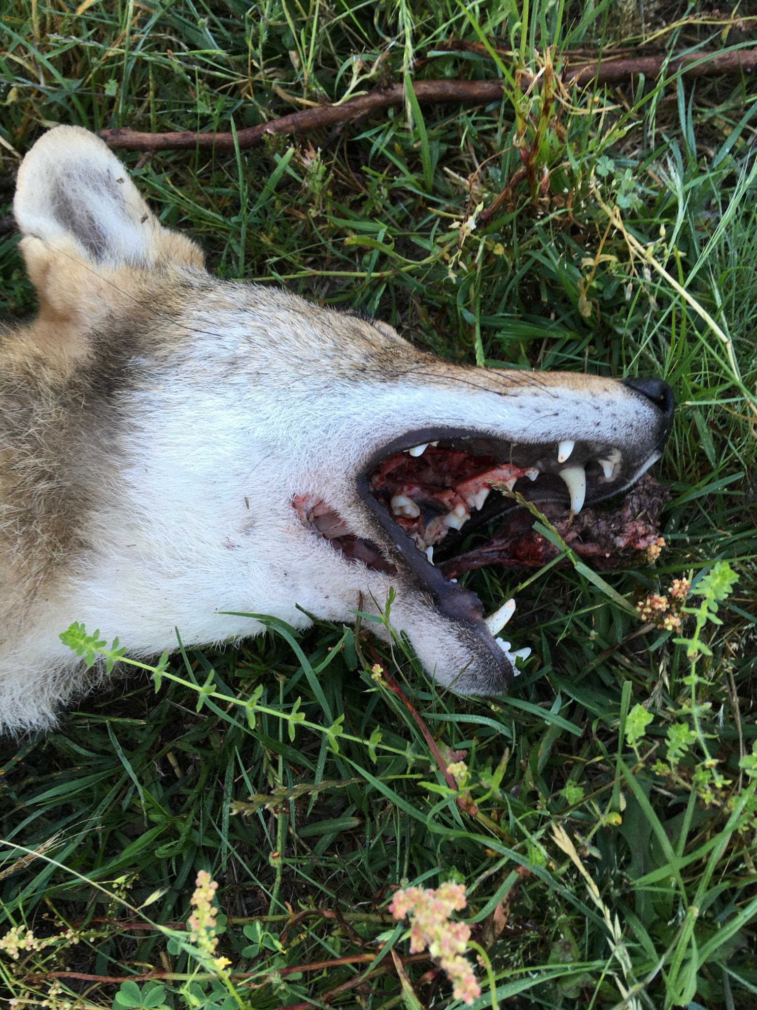

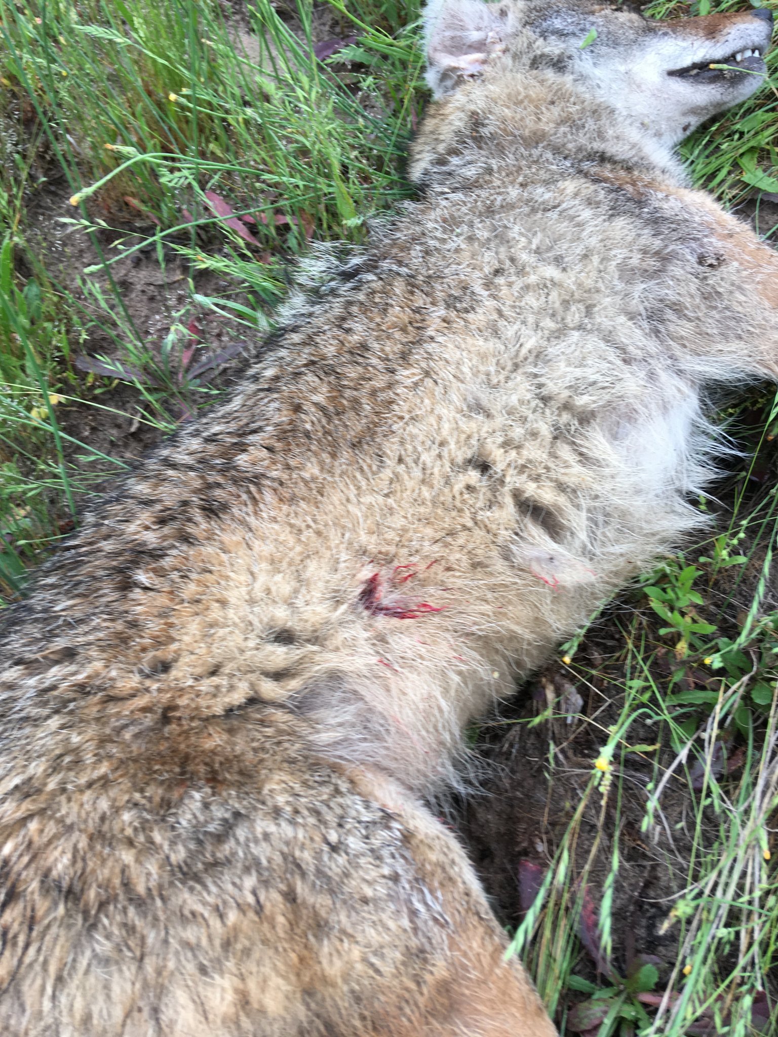

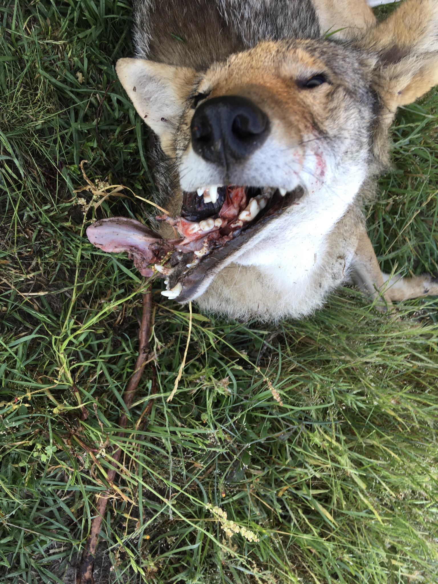

Out of all the various calibers and wildcats ive ran over the years, the 223 AI has , and continues to be one of the best all around cartridges you could ask for, alot of us ran them in Matches with the heavies, 75-82gr, then for hunting the AI gives you some extra speed with hardly any recoil. Some of the others like 22 creed will flat smoke a yote! But i alway seem to find the 223ai getting more range and field time than any other barrel... lol its way more fun to shoot! Ive dropped pigs out to 825 with one and have seen alot of deer shot with them here in texas, but for yotes it works great with the 68-75 grainers. Fireform loads are great for hunting also, one of the easiest rounds to reload for, pretty much 75-80 grainer with 25.2-26 gr of either 8208 or 4895 gives bad ass results!
my current ai barrel is 20” proof shooting 80 vld’s at 2965 with a non-pressured load of 25.4gr of 8208
Most of the longer 223ai’s ive had were 24” and i got 3030 with 80’s and a 22” broughton barrel that was stupid accurate with 80’s going 3010 with 25.6 gr of 8208,
Sorry for long read, but its hard to go wrong with the 223 ai, and if your lazy as hell, you can always just shoot factory 223 ammo out of it! Best of luck and keep us posted, heres a pic of a yote last month that caught a 75eldm at about 100yds from the 223ai, it is bad news on yotes!!!

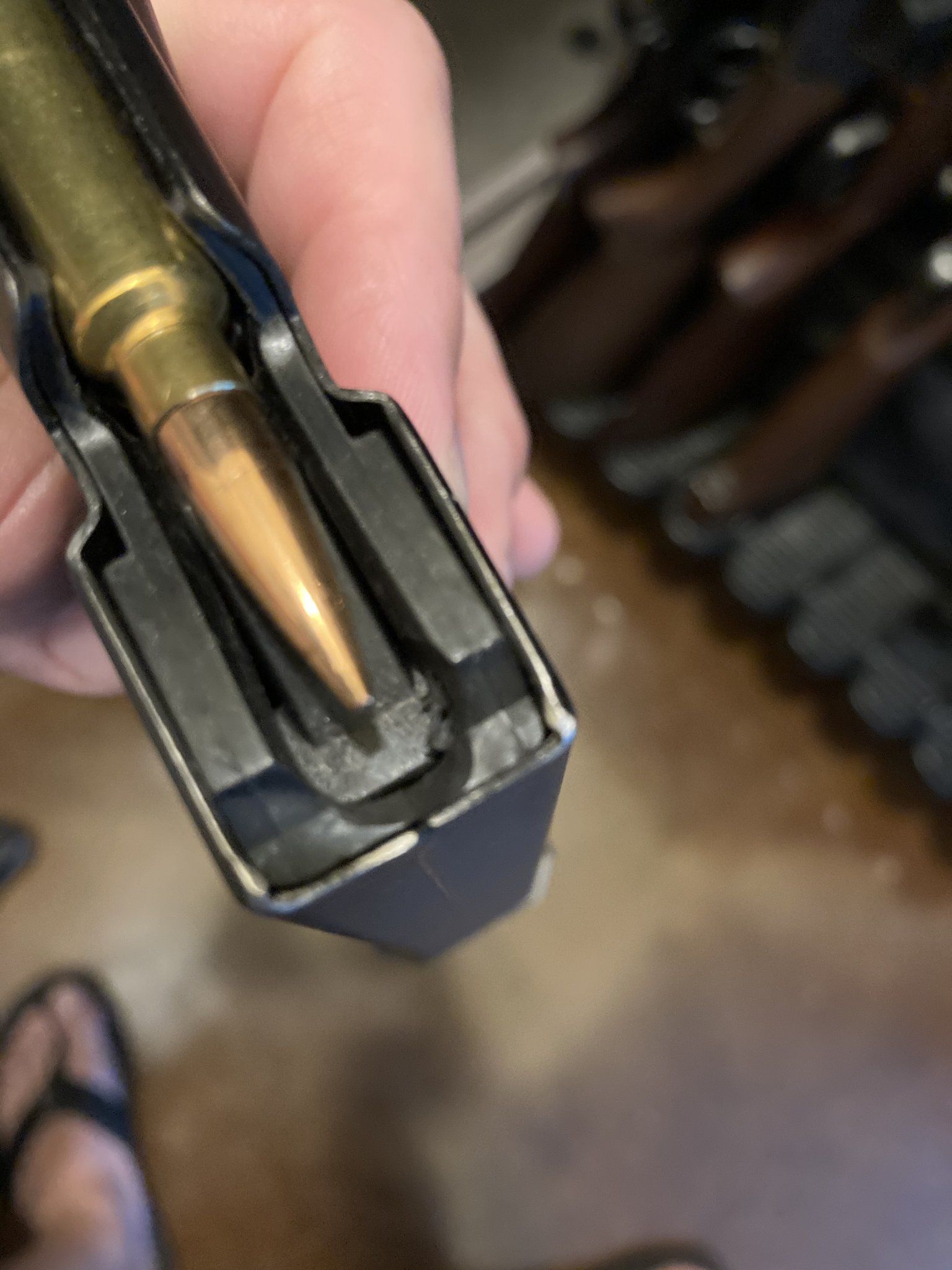

To answer your mag question, the accurate mags with plastic internal sleeve work the best, for longer oal bullets , pull the plastic sleeve out and take a dremel router bit to open up the top area were the two pieces join, doesn't have to be much relief, most of the 223 bullets tips just need some room in the mag,
