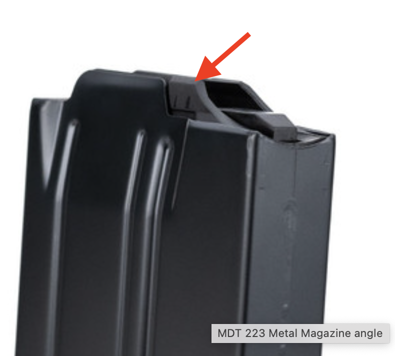

Spife, MDT "metal" .223 mags aren't all metal. They're about the size - may actually be - .308 metal mags with a polymer insert (red arrow in screen cap below from MDT site) to reduce them to .223 length and feed lip width. I can say from experience that it's difficult to the point of (for me) futility to try to use traditional metal-mag feed lip adjustment techniques on them because the polymer is flexible.

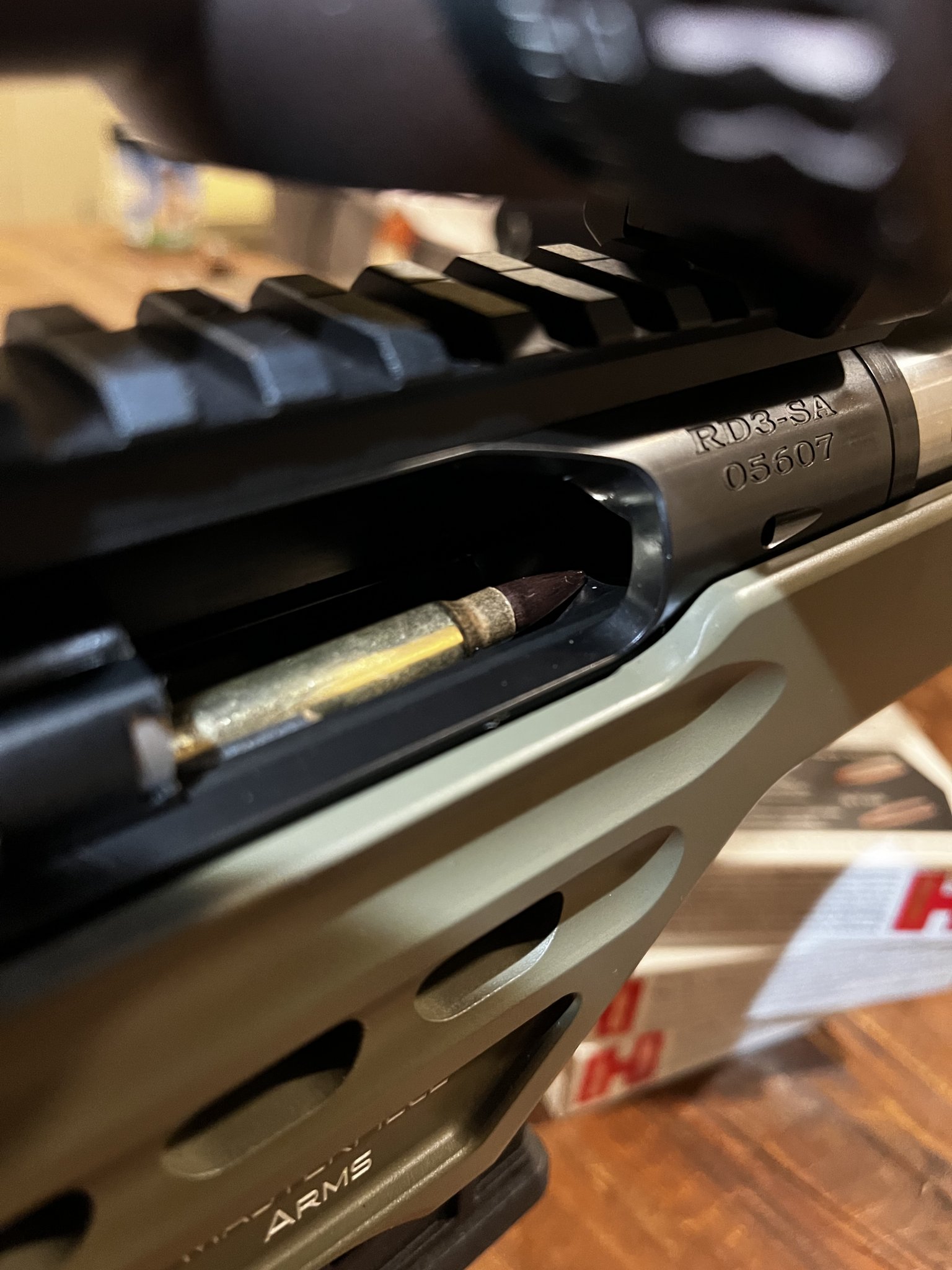

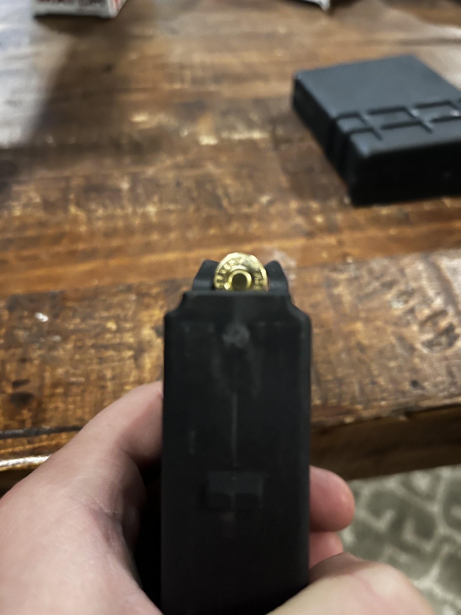

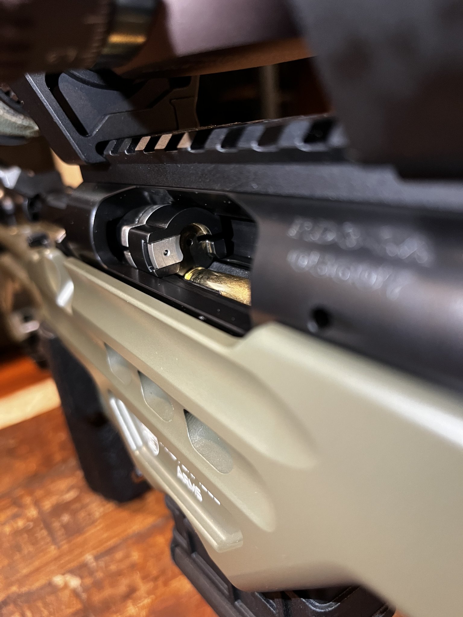

Having a hard time posting a video…. But this is what I’m looking at at. I have the msg seated as high as possible without the bolt hitting the magazine.
It looks to me like I need to sand the top of the magazine lips down, so that I can see the magazine higher and have more contact between the bolt face and the head of the case.
Let me know what you think. Thanks.

Is the bullet running into the breech face on the barrel? That is the biggest issue I have with mag failures in tl3 and origin actions. Also, the spring in those mags is stiff. The first couple rounds are hard to strip off the stack. The accurate metal mags are much better.
