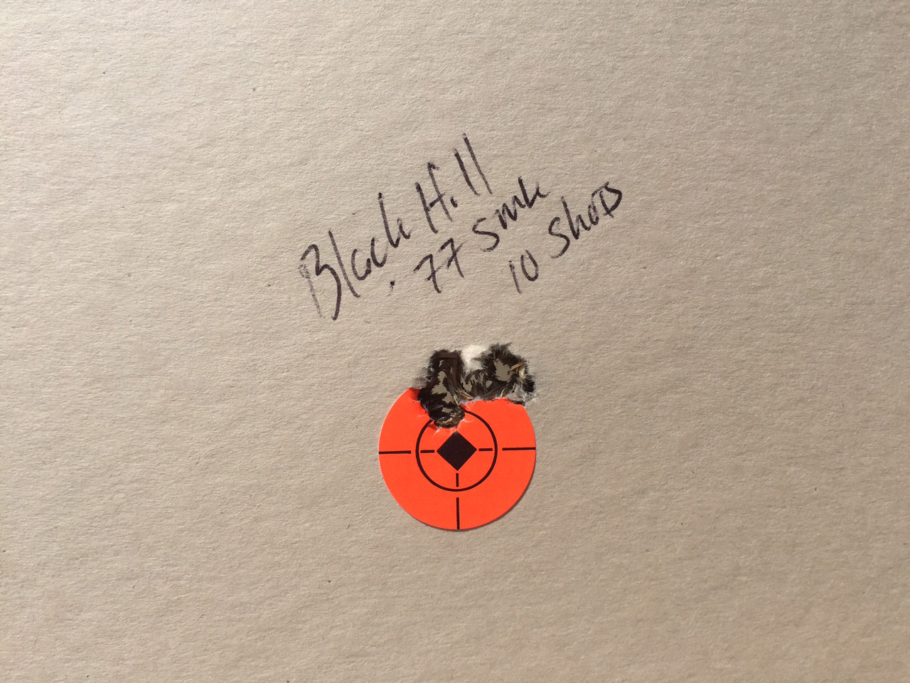

Black hills 77 SMK, out of a savage :)

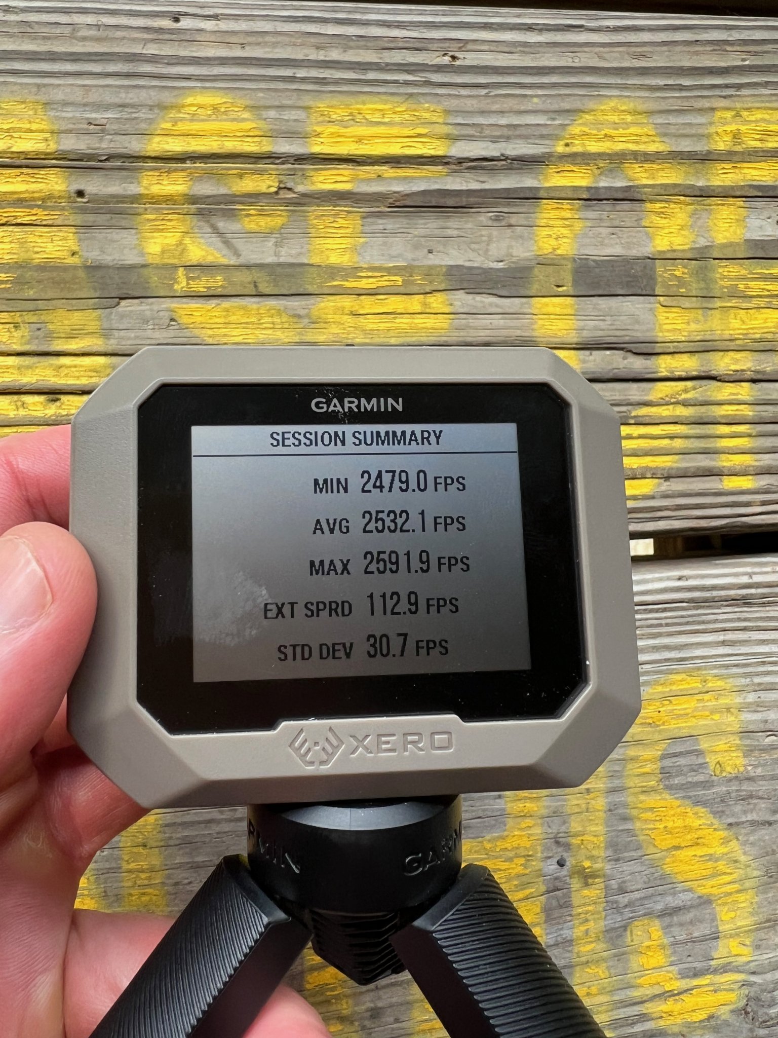

This is interesting. I don't really understand how the 6arc has so much less windage than the 6 br at what is likely the same velocity with a bullet that is only 3 grain heavier.... I have a lot to learn here obviously
The 105 scenar is a dated bullet compared to the 108 eldm but you can't trust either bc and the BR should be pushing it faster at lower pressures which would negate a difference in BC. Not sure where those numbers were pulled from but I would run them through AB with trued g7 and/or the cdm.
Hornady published data is horrific and that's when their bullets arent blowing apart.

The ammo cost is a wash. If someone is interested in learning precision shooting and doesn't have time to reload, you've got to buy quality match ammo, and that puts the .223 right up there with larger calibers. The only downside to a 6.5 or 6 Creedmoor is the recoil, and it's not much of a downside.
Your argument is like saying I need to dig a hole 3' deep; why do I need a shovel with a long handle when a shovel with a short handle is fine for a 3' hole and then if I need to dig a deeper hole, I'll just buy another shovel with a longer handle.
The Hornady training ammo is junk.

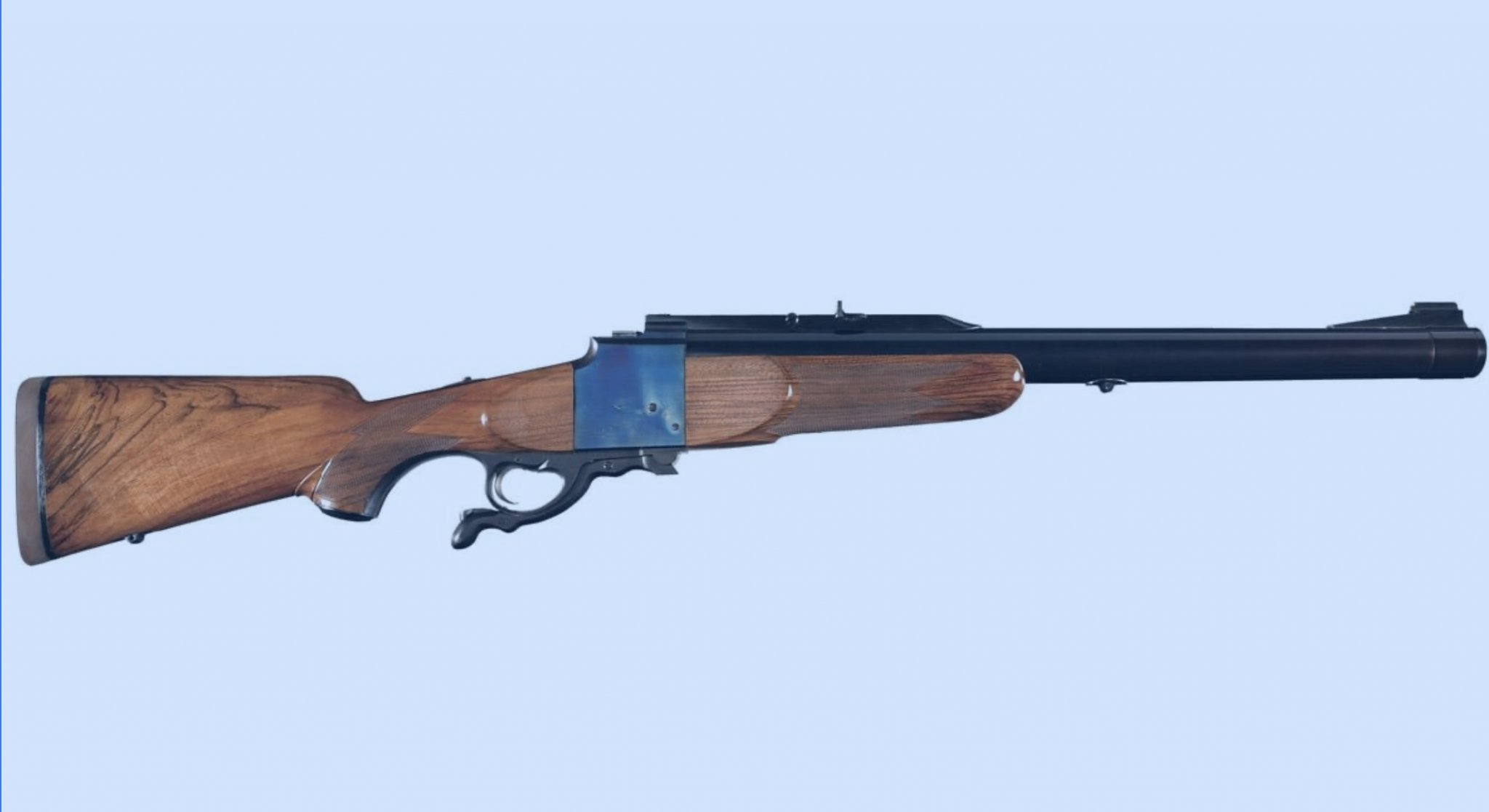

So, forget the .223 or 6.5, H&H for the price of a large Hollywood mansion or a closet sized New York City apartment will provide you with a 700 H&H double rifle. Heck, if you don’t hit the x ring, no worries, the darned thing will probably take our the entire target, maybe even the entire berm backing the target. A couple of shots and your shoulder will likely be toast as well
Or, if really adventurous, try a 4 Bore rifle. Twice the size, twice the fun. (And cheap too compared to the H&H)
Seriously…..
My thoughts, to end this discussion, OP get a rifle, get one that meets your budget, but with reasonable quality and popularity. Shoot it. If after a while, you don’t like it or want something better, either sell it, or save some pennies and buy what you think you like and keep the other for a spare.
Below, 4 bore rifle, estimated auction price 10 to 16K
View attachment 8263989View attachment 8263988
That SD at 300 yards is not a deal breaker
Reactions: PappyM3
Maybe not, but if you want to learn precision shooting, you need an accurate rifle (sub moa) and good ammo. Otherwise, you're chasing your tail. There's a lot of bad advice in this thread; it's like one of those: "What kind of scope should I buy to shoot 300 yards?"
