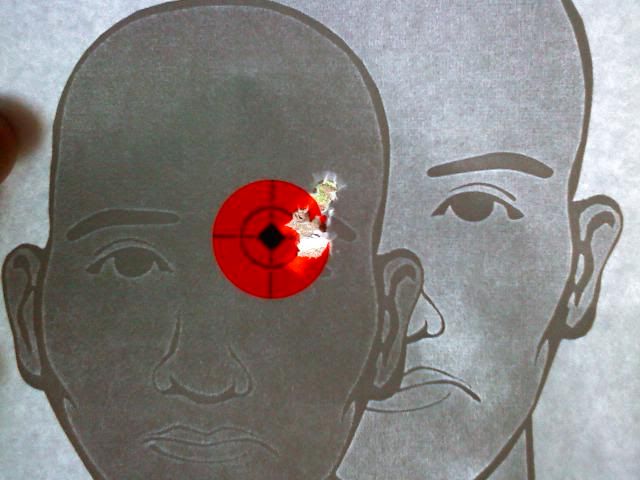

***I'm bringing this post back from the dead rather than start a new one.***
I acquired my own SPS Tactical in .223 and began experimenting with the 77 SMK's with the dreaded 1/9 twist. (Remington this is your clue, make the tactical model a 1/8 twist)
My old standby load of
Virgin Lake City Brass
Reloader-15 24.5 grains.
FGMM primer
77SMK
Seated to 2.260 COAL
Shot pretty decent, about like Phylodog's. However I wasn't satisfied. So I began experimenting like normal. I'll save you the long drawn out version and post the three best groups.
Orange stickers are 1 inch.
Reloader-15 24.4 grains.
FGMM primer
77SMK
Seated to 2.380 COAL
Reloader-15 24.6 grains.
FGMM primer
77SMK
Seated to 2.340 COAL
Reloader-15 24.8 grains.
FGMM primer
77SMK
I believe all three groups should in fact be one hole groups. I have a astigmatism in my right eye and did not shoot with my glasses on. It was pissing down the rain and I was soaked to the bone after running 12-15 deer off the range so I could shoot. So I wasn't going back to the truck to retrieve my glasses. I'll be shooting all three loads over a chronograph and make will my decision on which to keep.
