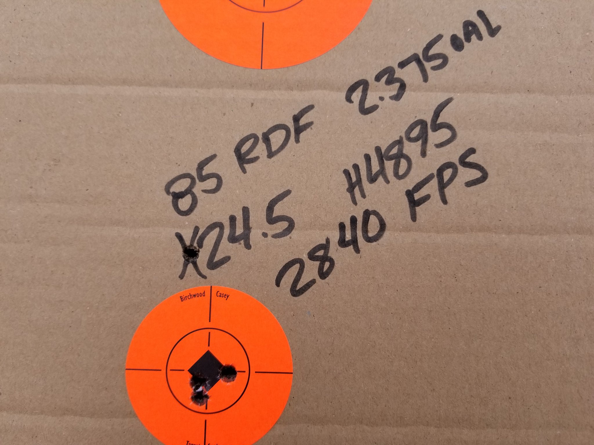

    I have 2 trainers in 223 and shoot a lot of the 85gr RDF's. I load them really long and use Reloader 15 for 2935fps and ONLY LC brass!! I have shot them out to 1250 yards with consistent hits on a 18" plateView attachment 7190238
    So Tim load them all the way out as Far as a mag will allow? For example MDT is 2.59 I believe. Don’t worry about the lands or anything like that?
