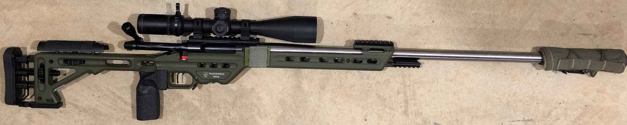

    Here is my trainer, its a twin to my comp rifle. War rifles out of Manassas VA did all of the work. It's a hammer and has quickly become my favorite rifle!
    Bighorn Origin Action
    26" Bartlien, 7 Twist, Heavy Palma
    Chambered 223 Wylde
    Trigger Tech Diamond
    MPA Chassis
    Vortex Rings and AMG Scope
    Accurate Mag- 10 round mags, I had hang-ups with the MDT polymer mags.
    TB Ultra 7 30cal suppressor
    Current load is:
    Lapua brass
    24.3gn H4895
    75gn ELD-M seated .0025" off the lands
    CCI 400 primers
    3015fps & SD7
    Also runs 77SMK's with IMR4064 in LC brass pretty well. Enough to practice with.

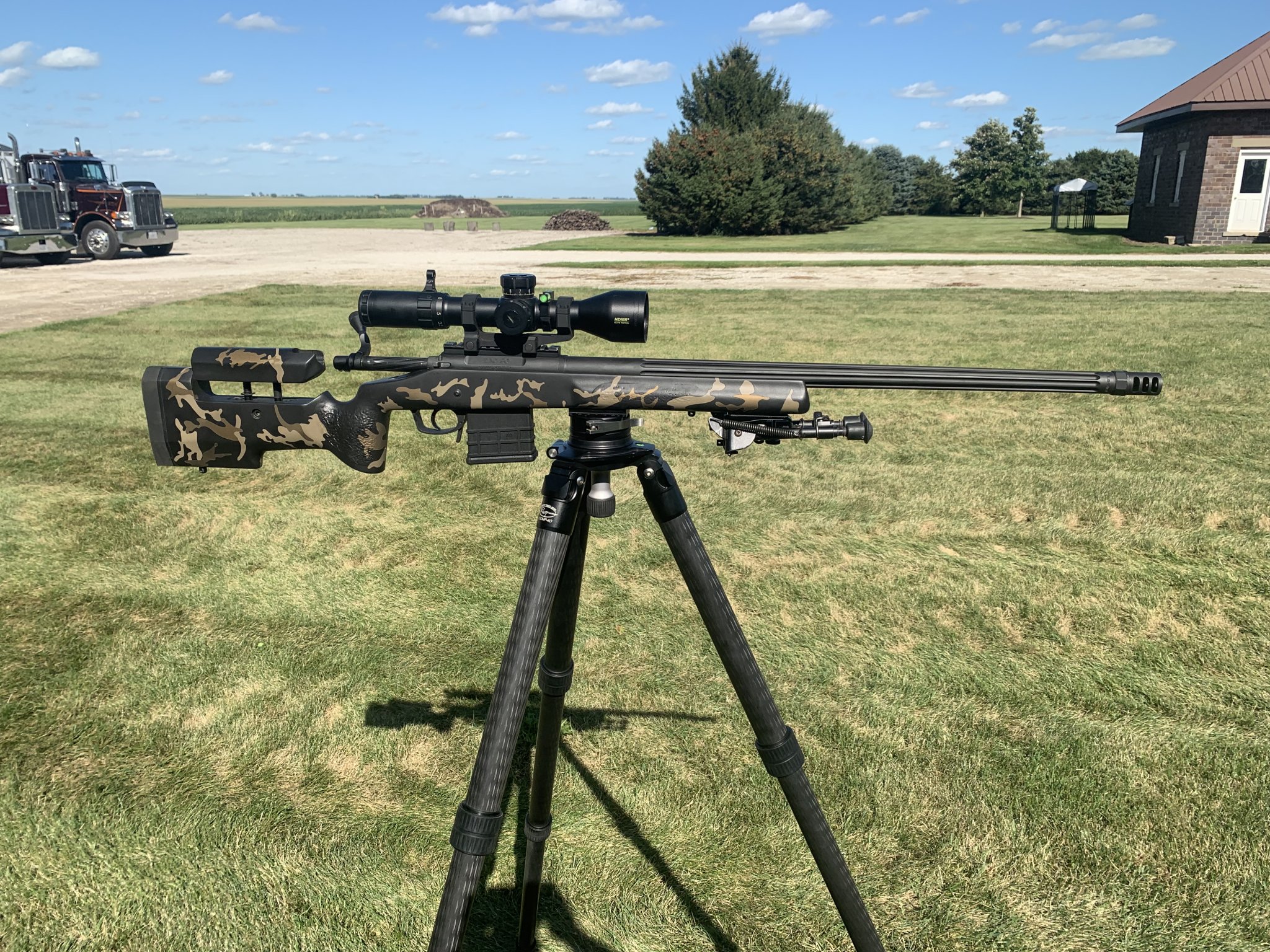

    My 223 is very similar to my match rifle.
    Stiller TAC 30
    Manners T4A mini chassis
    Rock Creek 7 twist at 26” with straight flutes
    Wylde chamber so it’s a little more universal
    Huber 2 stage trigger
    DMR2 with H-59 to match my XRS2 H-59
    MDT mags have worked pretty well, metal accurate mags not so much.
    Shoots 77TMKS at 2900 with 25.1gr CFE223
    Prime brass, fgmm 205m
    I wouldn’t change a thing. This will shoot just about anything you want to put through it, accurately.

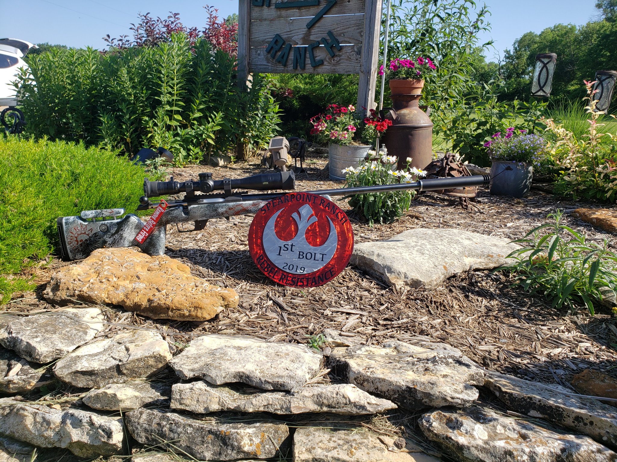

    I run the 75gr ELDM in my Tikka Varmint 1-8 factory barrel, 24.9gr H4895, Nammo brass, CCI450, 2.49" out of MDT mags. Getting 3025fps suppressed. My son took it to 1400 yards the day before we won a Jim See format team match with targets out to 995.

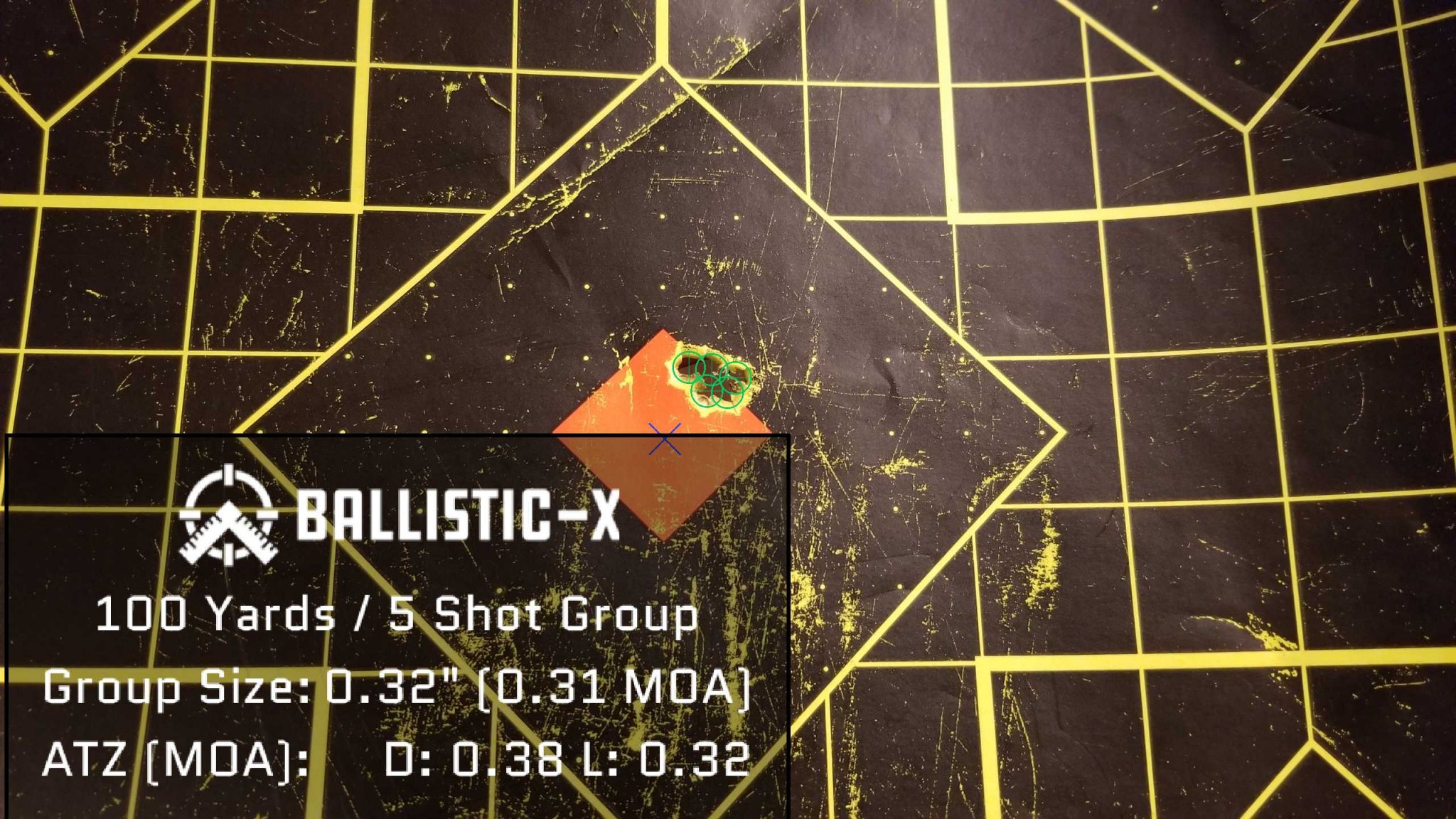

    Here's some actual pictures for you. Let me know if you need the same with 80 VLD, 80 Amax, 80 SMK, etc. Since you state one thing then change your stance the next post you make. Got nothing to do with disagreeing. Facts are facts.
    Lapua 223 Rem Match Brass 75 ELD-M dummy round. This dummy round is just touching lands in a 223 Wylde chamber.
    100% unmodified MDT 223, Accurate 223 and AICS Polymer 223 Magazines with this dummy round
    Plenty of room still in these mags with this dummy round that is contacting the lands and that boattail/bearing surface junction is right at the case neck/shoulder junction. Perfect. Right where it should be
