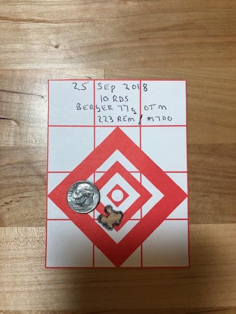

I have a Rem 700 with a 24"/1-8 twist Krieger. The biggest bullet I tried was a 77g Berger. It seemed to do ok.
