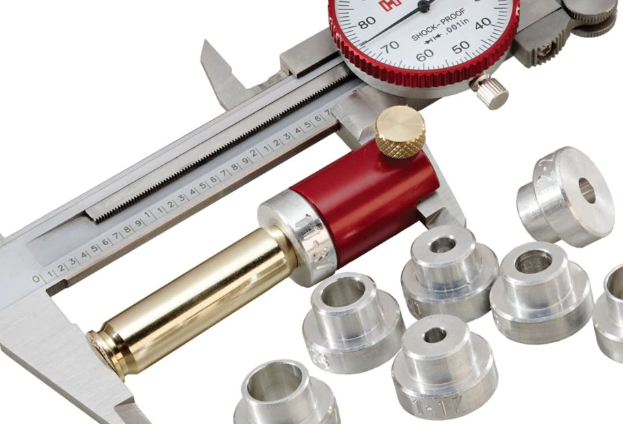

Belligerents
Feb 10, 2017
7,835
5,801
219
Central TX
Oh shoot, I responded to the sidetracker.
Alright OP, in those that have the primers mashed but don’t go off, how are they not going off? Are they adequately dimpled or is the dimple faint pointing to the firing pin having a lack of energy? In those that failed have you pulled the bullet and powder and deprimed to see if the primer actually did go off and it was the powder that didnt go off?
If the primer didnt go off, can you put a new primer in the new case and see if it pops? If it doesnt then you have isolated it to the brass.
Keep cross checking like this to figure out the root cause, brass vs primers. The fact that they were working for you before elsewhere and that primers are really really damn reliable as a whole Im inclined to think its your brass or maybe our brasses relationship to the chamber.
If the primers are failing in specific pieces of brass then I recommend that you measure the depths of the primer pockets on those using the depth gauge on the end of your caliper. Compare the depth of the brass primer pocket to the height of the primer cup walls and then to the depth of the primer including the anvil. Then seat the primers and measure how far below flush you are. Compare those to pieces that set off correctly. Those measurements will show you if your primer is adequately inserted into the pocket.
The next step is just waiting for your case comparators to get here. If the brass has too much room in front of the shoulder and can slide forward in the chamber far enough then the firing pins energy is spent moving the brass instead of divoting the primer.
If the fired case shoulders measure much longer than the unfired cases then you could seat a bullet long jamming into the lands and using a moderate charge weight you could see if that extra pressure on the case back towards the bolt face could be enough to set the primers off.

@MakeSawdust no worries man. I have a couple of other shoulder gauges for my other calibers, I'll give them a shot. I believe my order is supposed to be here Thursday, so not to much longer to wait.
jsimonh
Belligerents
Feb 4, 2011
573
219
49
39
Altus, Oklahoma
Got my gauge in yesterday. Most new brass was measuring 1.456ish. Fired brass out of my bolt gun was 1.457. Several of the ones that didnt fire measured 1.455 and 2 measured 1.452. So I was thinking it was a headspace issue. BUT 2 that didnt fire measured 1.456 like the other new brass. All 8 that didnt fire in my bolt gun fired in my AR today. I had to single feed them, but at least I know it's not a primer issue. BTW the AR fired brass all measured 1.459
