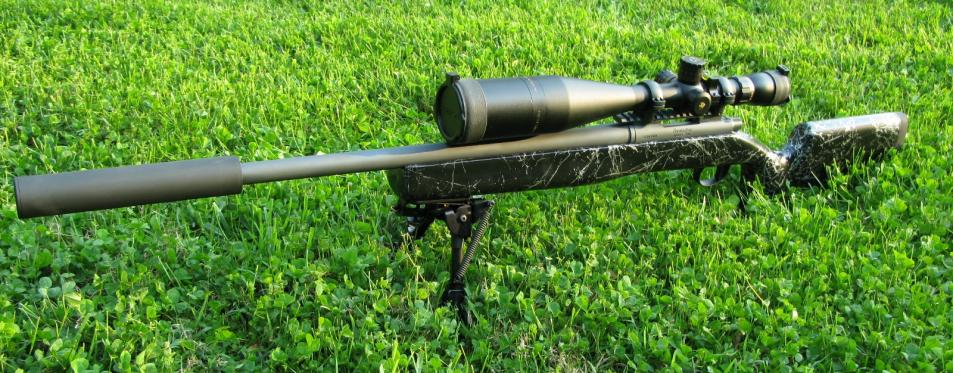

i'm rebarreling my SSC built 223ai. Right now I have a rechambered 1:9 rem tactical barrel....and it's just not a great shooter. it shoots better now than it did when it was factory...but it's still just not as consistent as I'd like. I'm rebarreling to a 1:8...setting it up to run 80 a-max's...and will be shooting steel out to 600yds and paper at 100 and 200yds.
current gun setup:
SSC true'd and coated rem700 with rechambered factory barrel
Badger thruster brake
Timney 517 trigger @ ~1.5-2lbs (getting changed to jewell)
EGW HD 0moa rail
Burris signature zee rings
Sightron SIII, 8-32, MOA-2
Bobby Hart LRT stock (getting changed to ST1000)
Cowan front rest with protektor front and rear bag
shooting with a Liberty Torch suppressor
My two options area:
1. Bartlein HV 29" blank...finish at 28" with a nice recessed crown
2. Bartlein Rem Var contour 27" blank....finish at 24" and thread and time my already in stalled brake...and shoot with my can
also...anyone got any insight into what freebore I should go with? Russel has the reamer from when he did my rem barrel, it's 0" freebore but he has a throating reamer to run whatever I need
